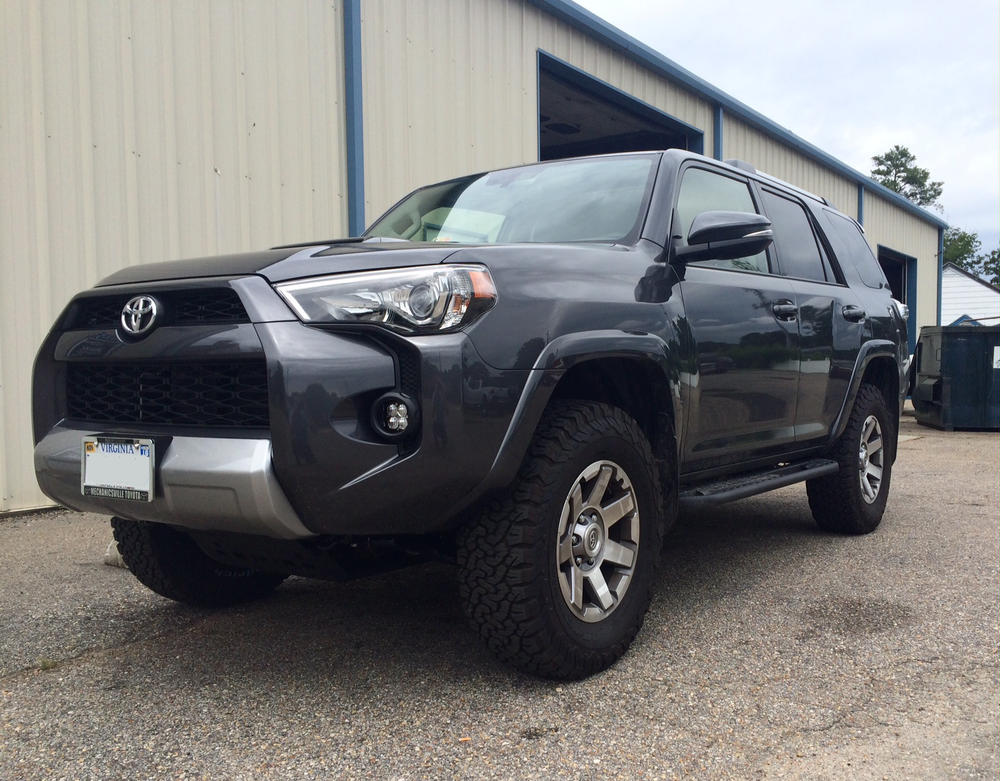

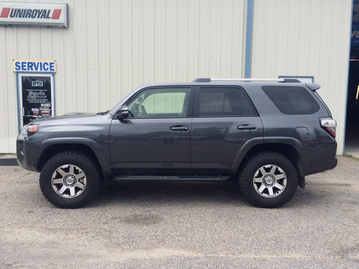

Just picked up my 4Runner from the shop. Unfortunately, I didn't take any measurements or pictures beforehand, but I'll try to answer whatever questions I can. Here's the set up:
Tires: 275 BFG KO2's
Front: Bilstein 6112 set on 3rd clip
Rear: Bilstein 5160 with custom Deaver coils that are 0.75" taller (will result in ~1.0" of lift) & 15% stiffer than stock
Like I said, I didn't measure, but I think I got 2" in the front and 1" in the rear. Definitely accomplishes the moderate lift/level I was going for. It looks close enough to stock that it won't catch the attention of 'commoners' but is still lifted enough where there should be marked improvements in off-road performance. With the lift, there's a quiet aggressiveness about it that I like. While not being able to quite put your finger on it, it causes you to look at it to try and figure out what makes it different from all the other stock 4Runners on the road. It now rides like a dream too - soaks up bumps like crazy and no longer nose dives when breaking. I couldn't have wished for a better result.
I also got the shop to throw Airlift airbags in the rear, but since they have minimal pressure in them, they shouldn't have any impact.

Perfect setup for the "weekend adventurer". Love it!

I haven't really had any issues with body roll with the stock suspension, so I'm not sure I can answer that. It's inherently a stiffer set up, so I would say that there's likely improvement.
I originally contacted Deaver through their generic 'Contact Us' web form. All my contact after that was with Scott Born. PM me if you want his contact info.
Yes, those Bilsteins can still be used for non-KDSS 4Runners. The install will be much easier on non-KDSS trucks if you want to do it yourself (I did not).
