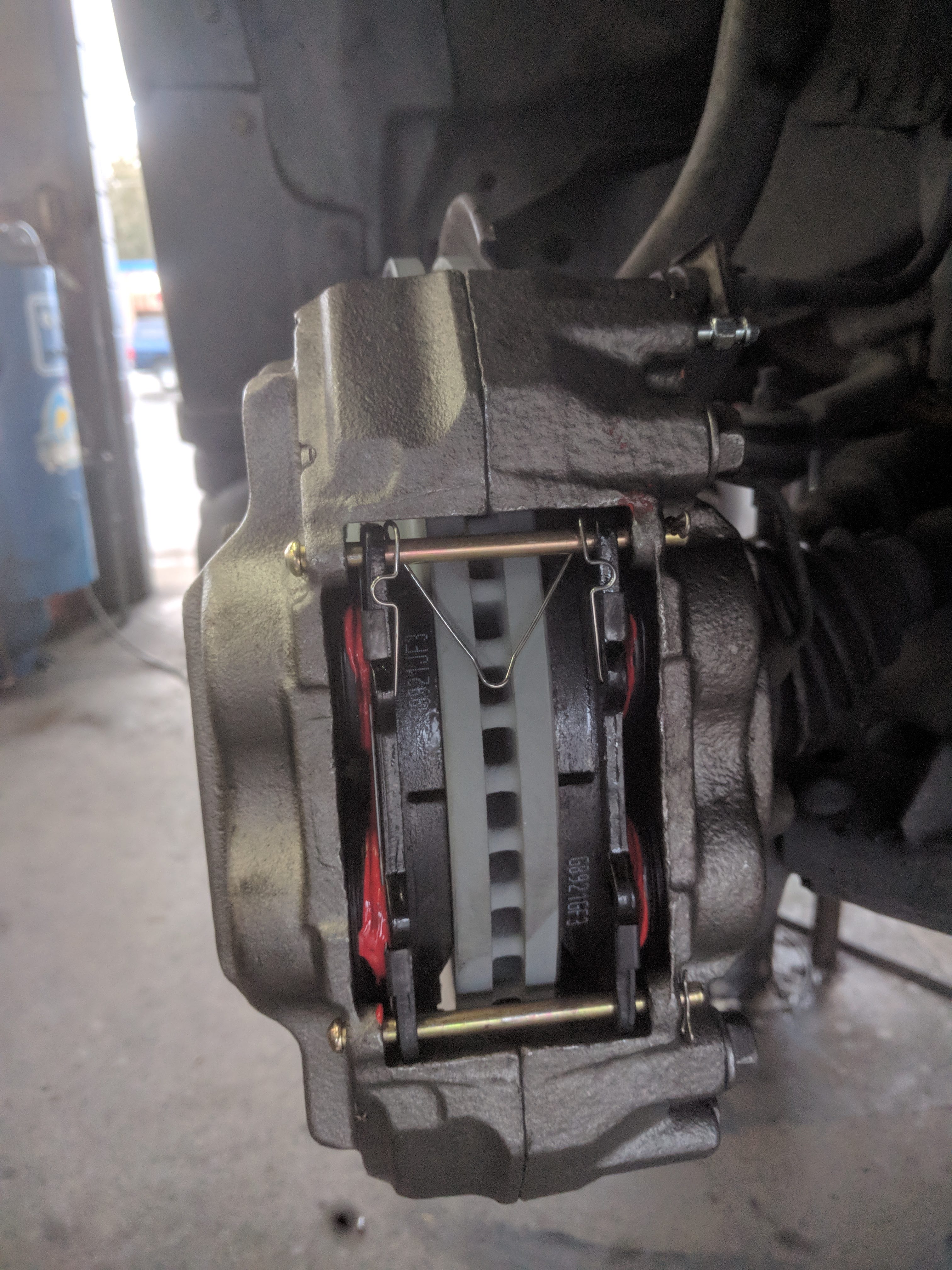

Maintenance day on Saturday. Was hoping to do some fun stuff too, but didn't have time.
Replaced rear shoes & wheel cylinders
Replaced front pads
Turned rotors & drums
Replaced valve cover gaskets
Oil change & fluids check
