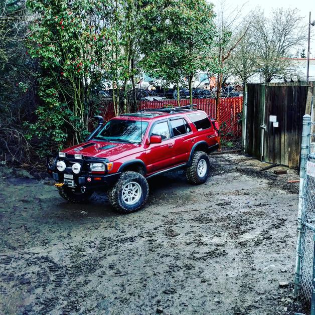

I have those same pair of IPF's in a box in my garage. I typically only buy PIAA lighting (can't beat the quality IMO), but how do you like the IPF's?
I've said this before, one of my favorite rigs on the forum. Built with real purpose in mind. Post pics of the clean interior when you get her back.
its getting dark otherwise i would. it looks ok, i had some serious stains, so they didnt all come out -20 years and 300k+ mi... what do you expect lol. anyhow im not overly impressed, they guy seamed scattered and i could see that in his work, im glad i only paid $100, -he was the only one who could do it today so that was a big plus. leave friday again for a week for work so thats why i went with this guy.
as far as IPF vs PIAA, i am a huge PIAA fan, but those IPFs are awesome! i loved them. i was running a PIAA 100w ion bulb in them and they were amazing. the patter was one of the best i have ever had, almost like a flood with a super bright hot spot in the middle. was amazing for back roads and late at night or bad weather. i just actually pulled those IPFs off and replaced them with a set of PIAA LP570 only because they are LEDs and draw less power. these LP570s are probably the best light i have ever had. they will give a run for the money to my 50" Totron LED bar on the GX.
as far as IPF vs PIAA, i am a huge PIAA fan, but these IPFs are awesome! i loved them. i was running a PIAA 100w ion bulb in them and they were amazing. the patter was one of the best i have ever had, almost like a flood with a super bright hot spot in the middle. was amazing for back roads and late at night or bad weather. i just actually pulled those IPFs off and replaced them with a set of PIAA LP570 only because they are LEDs and draw less power. those LP570s are probably the best light i have ever had. they will put give a run for the money to my 50" Totron LED bar on the GX.
Well that's good to hear, I've never ran IPF's before and was wondering how the beam and pattern were. I have those IPF's plus another set of PIAA 520i Fogs in the garage (I'm a sucker for good deals) plus my PIAA's on the truck with a cheap 22" LED bar. Once maintenance is squared away I'd like to get a set of the ditch light brackets and put the new PIAA RF cubes on the ditch brackets, then do the IPf/PIAA combo on the front like you did.
Thanks for replying man.
I have not run the RF cubes, but the IPFs will blow the PIAAs away you have. IMO IPF and PIAA are neck n neck with quality, PIAA just has a larger selection.
id have no hesitation to put them up against any rigid bar or baja designs light or any other light in the price range, or say 2 or 3 set vs one of the bigger bars -price for price. -again consider that the PIAAs are only using 2 LED chips per light as apposed to the row of chips in the bars... if you ask me the technology in the PIAAs are by far superior to anything on the market.
PIAA is definitely leading the way with QUALITY lighting, both halogen and LED. IMO Rigid and Baja aren't even close when you see the pictures of the new RF light bars quality of light and the quality of the product. I even have PIAA wiper blades on my truck (came free when I bought my 520's). Those blades have lasted for quite some time, plus the headlight bulbs that I bought nearly 3 years ago.
I'm looking forward to getting these IPF's on and have some good driving lights to go with my PIAA fogs.
