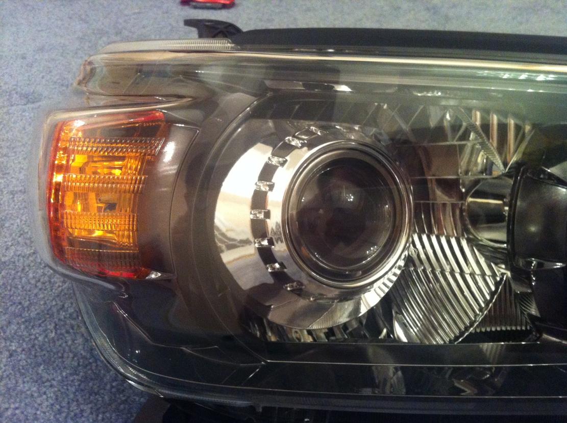

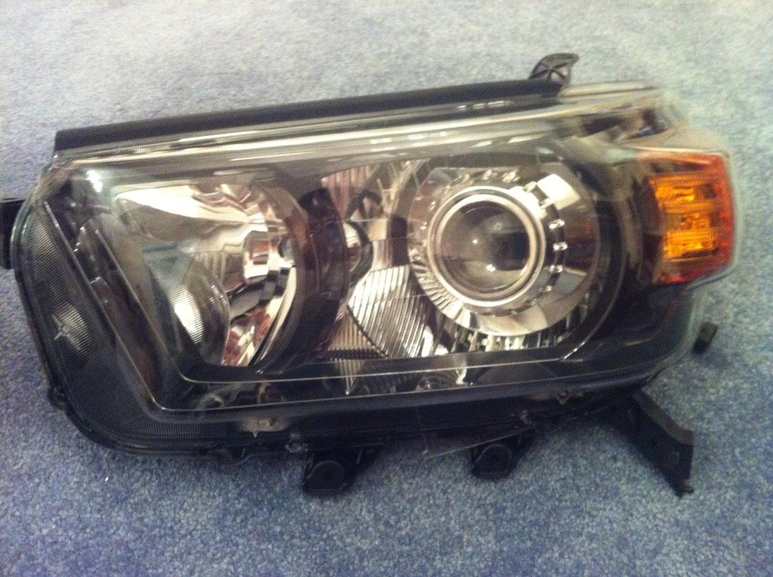

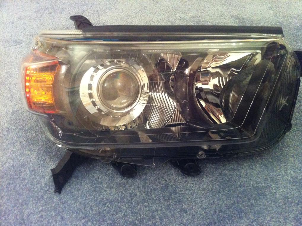

Well, TRS just finished my headlamps and sent me a few pictures. They did a great job. Thanks Val and Andrew! There was one little hiccup from the oven and i wanted to get everyones opinion on whether that tab is comprimised or if it will still hold.
I got FXR Stage III
E-46 extended
Osram 66240 CBI bulbs
H11 relay harness
Morimoto 3Five D2S ballasts

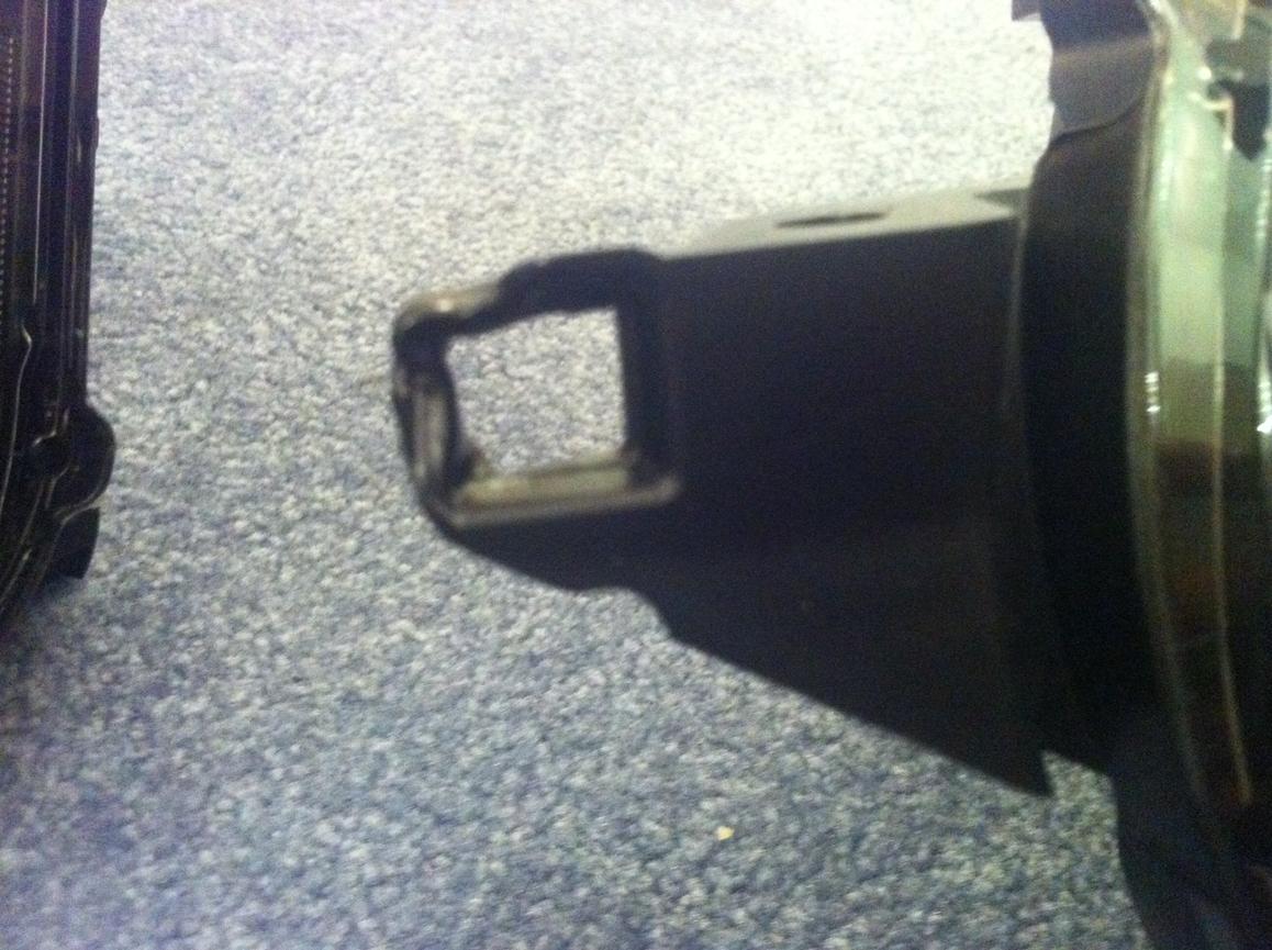

Here are the pics: The last photo shows the tab that got distorted in the oven, he tried to straighten it but i wanted to know from you guys here whether now the integrity is shot. Thanks

That tab should be fine.
I had one damaged in shipping and much worse off than that. It still doesn't budge.
Enjoy your new lights, they look great!
... There was one little hiccup from the oven and i wanted to get everyones opinion on whether that tab is comprimised or if it will still hold.
Not to worry, that arm does not secure the light. The square opening receives a plastic guide pin from the grille, and the round hole on top receives one of those pins from the shroud. Worst case you could reshape them with a heat gun.
