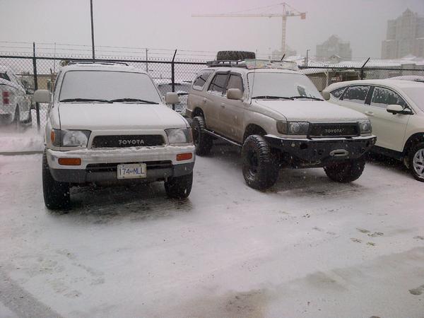

I can't wait to see what you're going to do with this 4Runner! I really like what you did to your previous trucks, as I've been a long time follower! By the way, one of my co-workers now owns Dirt Duster!
poleclimber63-albums-progress...-picture44401-new-office-new-co-worker-nice-truck.jpg
My 4Runner parked next to it in Kelowna.... I love your old truck and it still attracts lots of attention!
