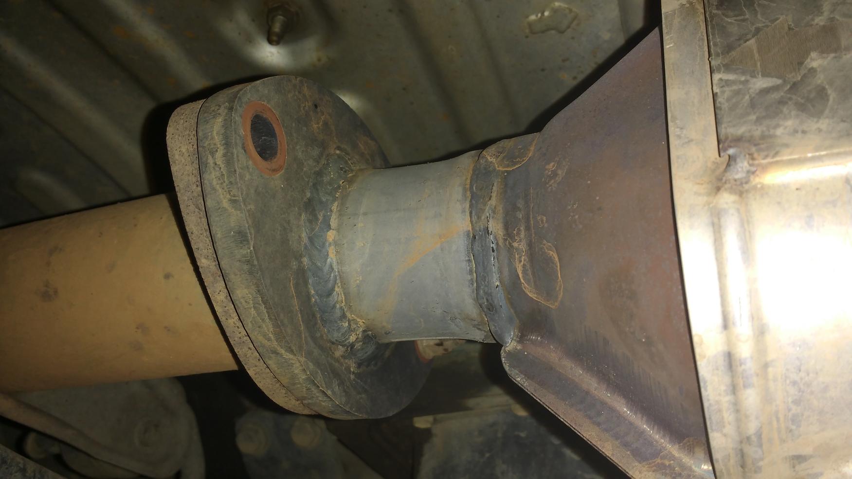

Somewhere in Utah an exaust bolt started to loosen, then at Mesa Verde it decided it's part in our journey was at an end. I packed a small selection of metric bolts and nuts in common sizes, and an m8 x45 or so was the closest thing I had so it's on there for now. I bought some m10x40s in Durango. If they fit, I'll put one in instead of the m8, and have one as a spare. The other bolt of the two that hold the flanges between the cats together, was also loose, and two of the three nuts at the Y pipe were also loose.

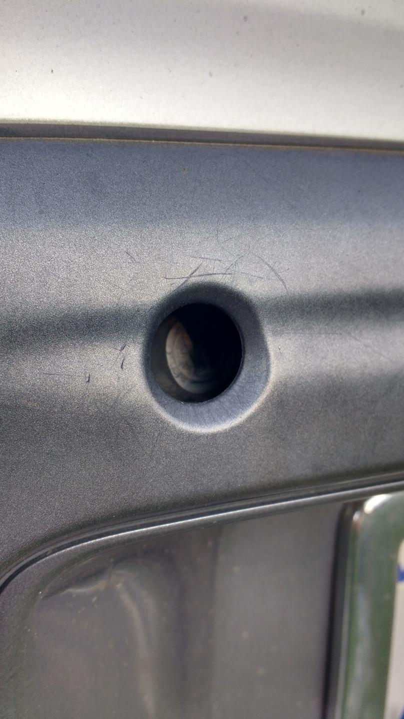

2) Hatch lock cylinder retreated into the rear hatch, in Esetes Park, Co.
3) Hatch power lock cylinder works intermittently, some times will not lock, sometimes will not lock. Problem is fixed by pushing in on the door while hitting unlock, or moving the rear window slightly. I suspect it has to do with internal linkage being compromised First happened a little south of Albuquerque, NM
4) Loose/Missing exhaust hardware. Jury rigged with spare hardware until in town where I got proper hardware.
