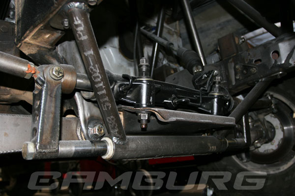

We need a company that will make bomb proof steering racks. You can beef up the rest of the IFS pretty well.
Yeah, my buddy that raced on one built a bracket that came off the rack it held a 1.5" solid piece of chromoly that slid through bushings. but it basically kept the rack from pushing in on each other and stiffened it up a lot. After breaking 3 racks he never broke one again. I wouldn't recommend it for dd use. The steering would sort of stick, so the truck wandered on the road, so you were constantly correcting it. But in the dirt you didn't notice it.
