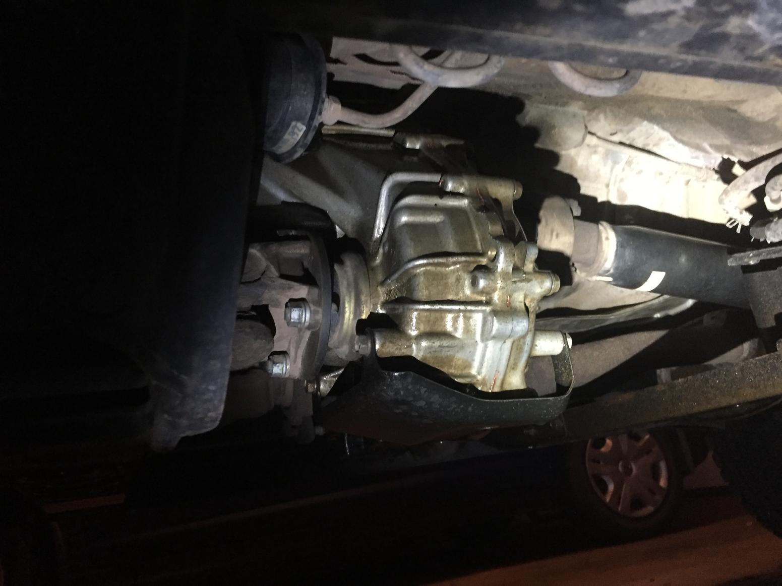

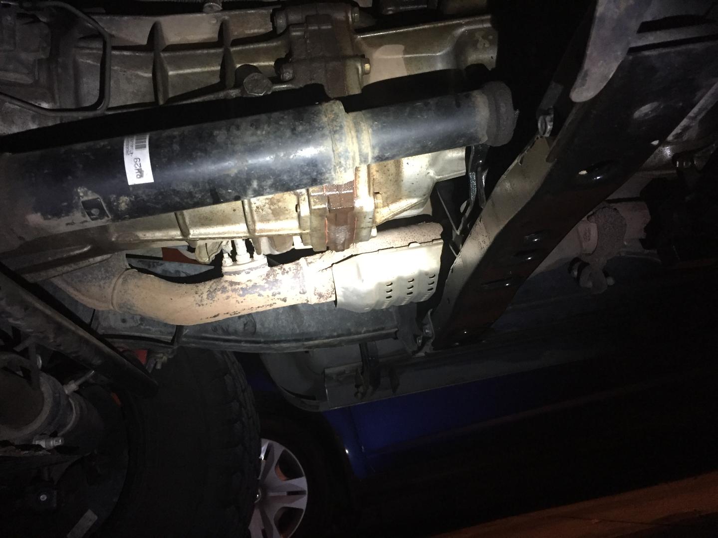

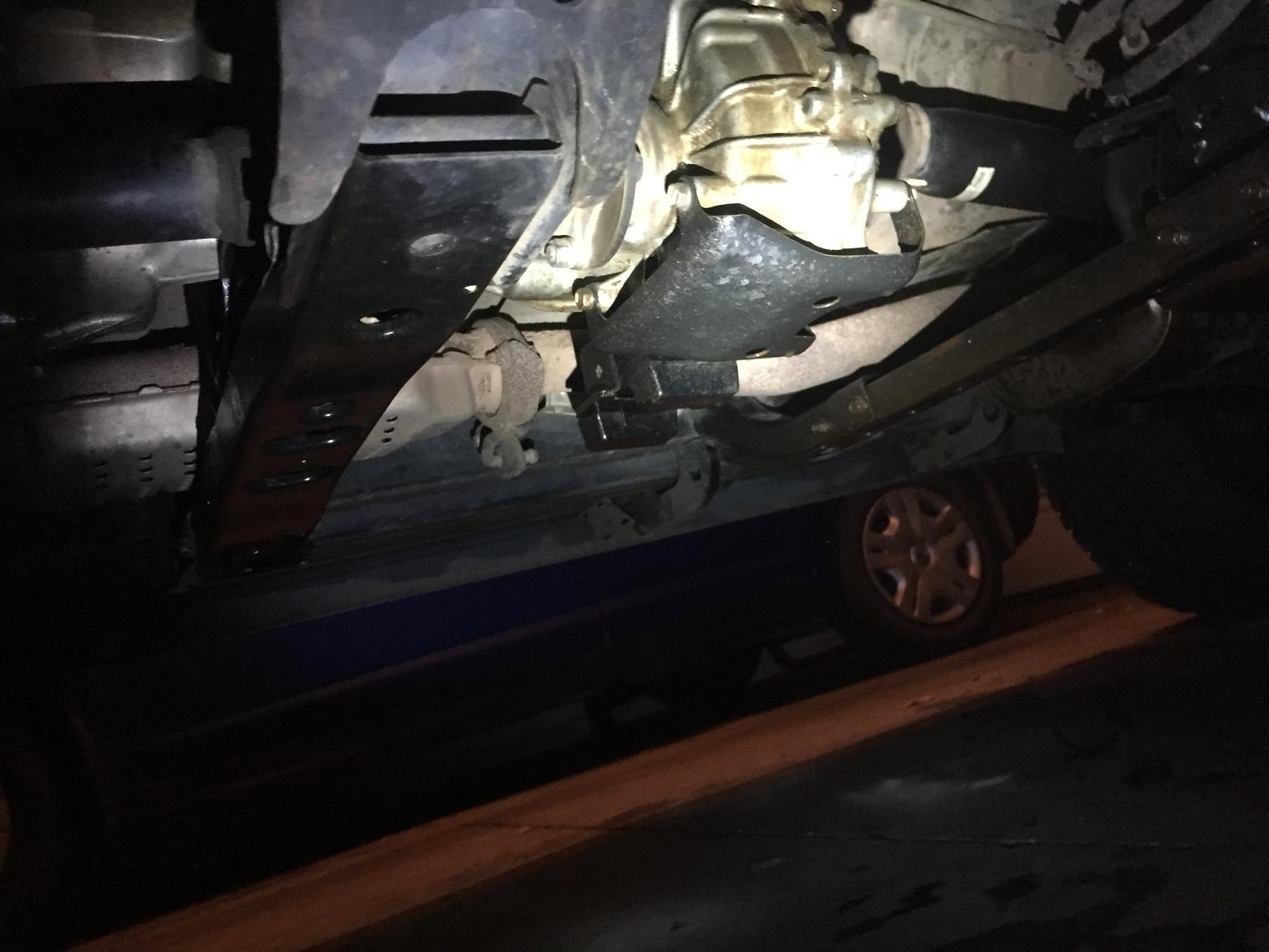

I'll start out by saying I'm not too knowledgeable when it comes to vehicles so please be patient with me. Last Friday I took my 1998 SR5 out of town for Christmas. It was a 3 hour drive from where I live. On the way home on Sunday it was snowing a ton and roads were icy. It took us about 5 hours to get home. Well for about 4 hours I had it in 4 High cruising about 35-40mph. When I pulled in my garage I noticed that it smelled hot! It wasn't the normal warm engine smell that I am used to with my 4Runner. I can't really describe the smell as I have never encountered it in my life. I checked to see if I had any leaks or anything and I didn't see a thing. I took it out Monday morning for a car wash to get all the road grime off. I didn't notice the smell or see any puddles (I'm a little paranoid to get oil spots on my clean garage floor) when I got home. Well tonight when I got home from work I noticed there was a ton of oil on the garage floor. So I looked under my 4Runner and the whole undercarriage is covered in oil. What could possibly be wrong with my truck? I just had the Clutch kit and water pump/timing belt done, so I'm worried that I'll have to dump more money into it. The first picture I attached in where I am assuming the oil is originating from moving towards the back of my 4Runner.

Looks like your R150 transmission is leaking from somewhere up top, pushing its way onto the transfer case, though the latter may be the culprit.
What does the steering rack look like? I have a similar leak from mine that is tossing oil all over the bottom of the transfer case.
It can be hard to pin down where the oil is coming from after doing a lot of highway driving. The oil droplets blow everywhere. In general, keep going forward and upward until you find dryness, though.
Is the engine dry? It seems like there is a mild epidemic of leaking valve covers now that the engines are hitting 20 years of age.
When they put the clutch in, the trans would have been pulled. Did they change the trans oil then, and possibly overfill it? Did they change the rear main seal on the motor and possibly screw that up (look at the small weep hole at the bottom of the bellhousing).
I had an issue with after I had a shop do diff fluid changes. They apparently didn't put a new crush washer, nor torque the fill plug on my front diff and it leak gear oil all over. This could be the explanation since this only started to occur once you used your 4wd. Also, gear oil smells really funky. Here's what mine looked like with the drip:

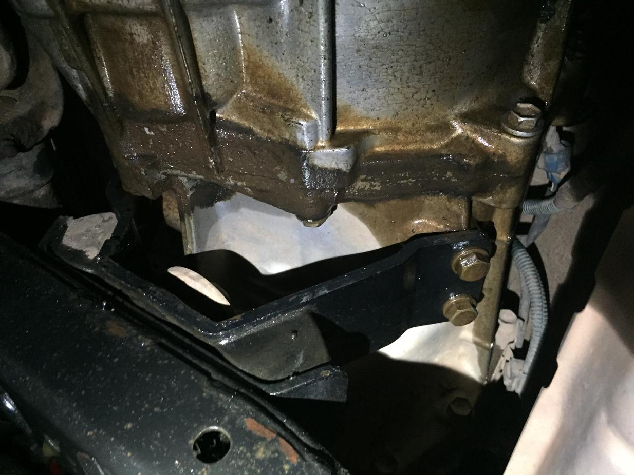

Looks like I have a lot of different things too look at! I crawled under there this morning and it looks like the leak is coming from where the transmission meets the transfer case. This pic is looking at the passenger side looking forward.
Assuming yours is 5speed. Pop the trim around the shifter inside. Remove the rubber and look around your shifter. Most likely its leaking from the shifter and dripping down. Happened to me. Had to replace the gasket between the shifter and the transmission. Tcase has one to. I never heard these transmission or transfer cases to leak in between. Which is sealed with Toyota red silicone
