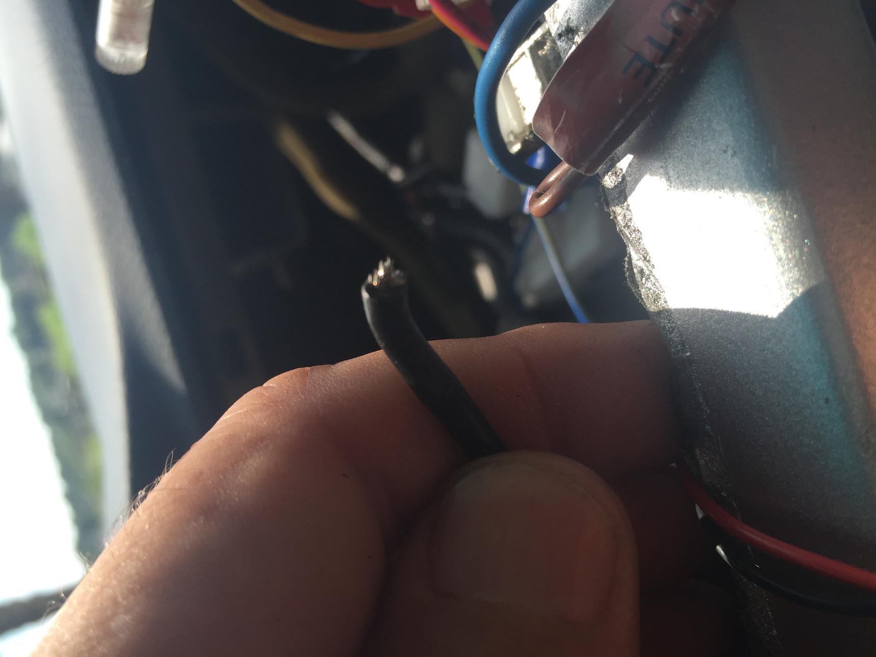

I don't have the time or the inclination to take anyone to small claims court. My time is too valuable and frankly it would be a losing proposition for me to take one day away from my profession as I have two offices and a huge overhead. I will give them a chance to make it right fully knowing they will blow me off. I live in a town with one Toyota dealership and the nearest dealers are 60 miles away. I did try to take it elsewhere but was told I would be put back at day #1 after waiting more than one year. All they had to do was unplug the wires and I would have been able to identity them easier or they could have cut the non video wires and marked them. They just went through them with a pair of wire cutters. I posted here mostly to vent frustration but also to warn others to be careful if this situation comes up with you. I am going to write a politely worded complaint expressing my displeasure to the owner (whom I know peripherally through our kids, it is a small town) and I will call the Svc manager on Monday and gently give him a piece of my mind. I too own a business in this town and can't be too much of an A hole although it is tempting. A call will also go to the California office to reinforce what they already know about this dealership. Below is a picture of my cut backup camera video cable

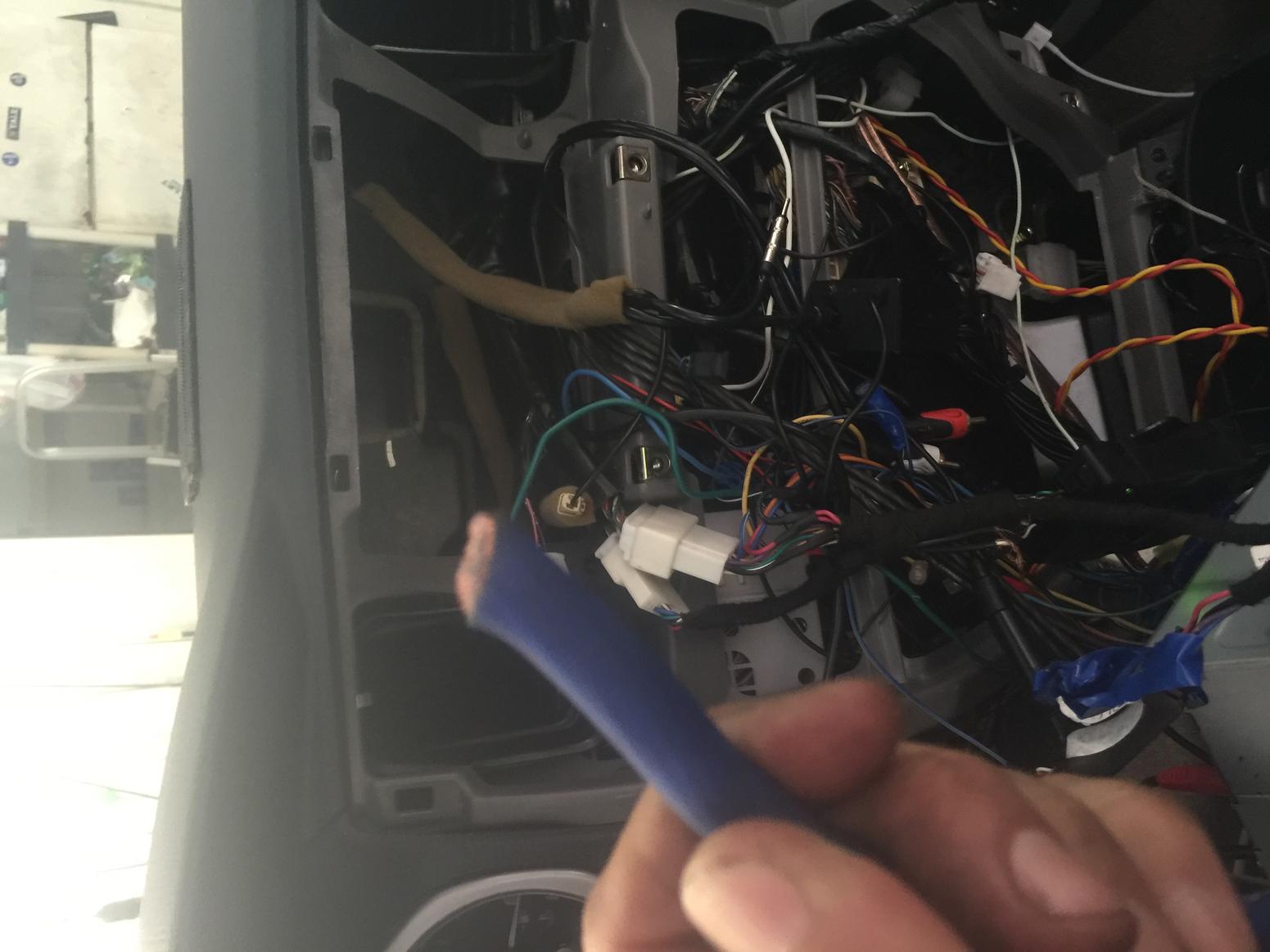

Toyota may care about their customers, but clearly their techs,(you included) don't. How hard would it be to at least label and # the wires before cutting them. A tech cannot identify a fiber optic cable? Or how about leaving a 4 gauge live untaped amp power wire hanging at the drivers feet ? (See picture) . That could under the right circumstances have given me or my wife (she picked up the car because I was working) at the very least a nasty burn if not worse! How difficult would it have been to insulate that with a couple of layers of electrical tape rather than leave it dangling out of sight under the dash but close to the brake and gas pedals with possible lethal consequences. Yeah, av8ter, sounds like you would fit right in at this dealership . By the way, Toyota graciously provided the dash due to their own ineptness in engineering a vinyl compound that would not stand up to the elements . I love my truck but it seems that Toyota is either leading or close to the leadership in recalls. Maybe if they engineered things the right way initially they would not have to be so gracious in retrospect. Do you think this wire was "accidentally cut by rubbing on sharp metal"? You should go into politics.

Thanks for posting that pic and also for your attempt at insulting me.
Your spaghetti nest is far worse than I imagined, I would have absolutely refused service. Toyota has zero obligation to perform warranty repairs to vehicles when the part in question has been modified from its original state, including warranty extension replacement of the dash boards.
Your back-up camera does not use an "optical" cable, simply a co-ax. That wire can be repaired by solder and electrical tape. You are also not at risk of being burned by a +12 volt source.
Sorry again for your experience. You say it isn't worth your time to take the issue to small claims but your passive aggressive demeanor suggests otherwise.

To be fair, the picture is a bit blurry (conspiracy much!? lol j/k man :) )

I can't tell if it's because your installer did a poor job of routing the wiring for the radio (a lot more common than you would think, I commonly see "quality audio shops" will have horrible wire routing and installation, sometimes tapping into network communication lines and other damage that causes more headaches for everyone) or if the technician didn't bother organizing them when he tucked everything back it, it could be a little of both.
Again, your pictures are blurry and out of focus; the wires do appear to be cut with tools, but that appears to be a coaxial cable and not a fiber-optic cable. Which if it is, that can be repaired by soldering the central wire, stripping back the insulation to expose the shielding, applying either a store-bought "repair mesh" or making your own wire mesh and then soldering the new shielding patch to the old shield wires and re-insulating (I had to do this on Sienna I accidentally broke the antennae wire to, wove my own mesh from a ton of left over high quality amp cable I had in my box at the time and it worked fine.) You also can patch a fiber optic cable, but it is annoyingly difficult and a pain in the ass (had to do it once on a BMW, never again...)
