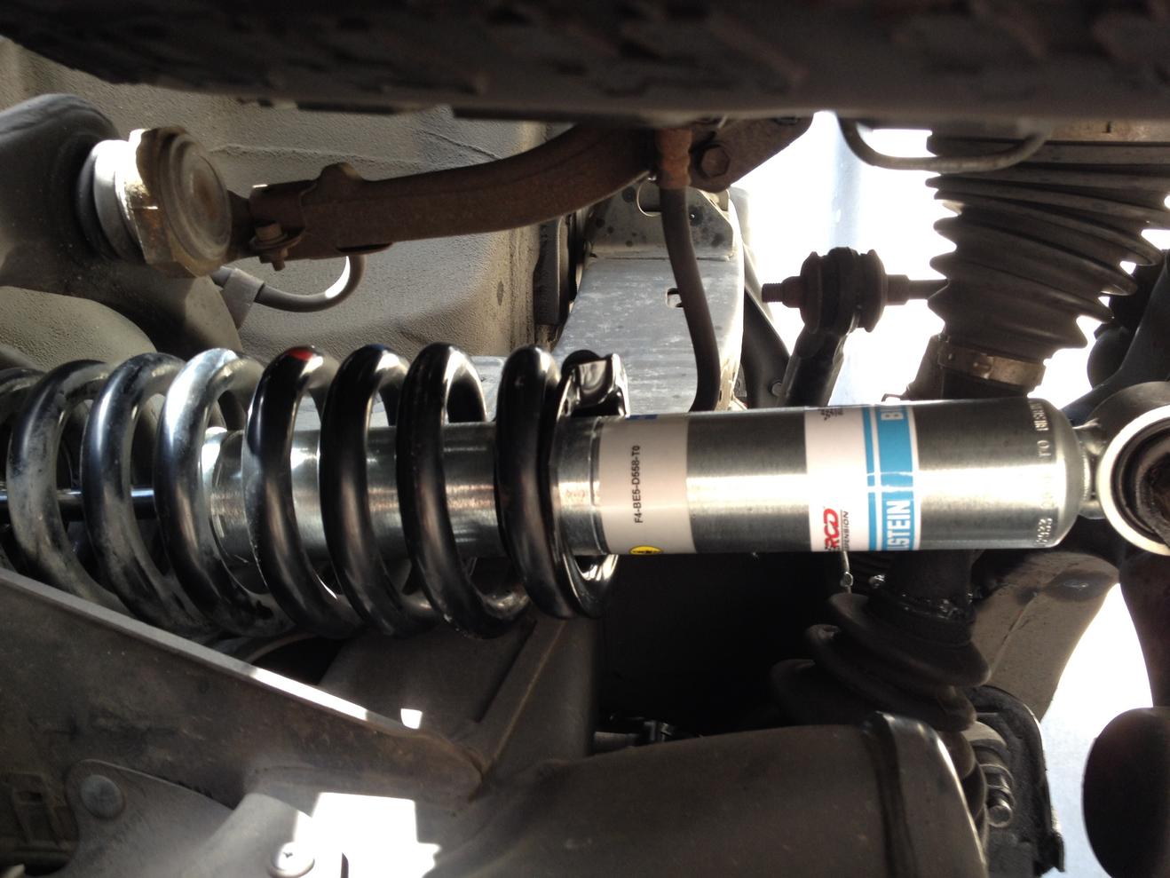

Front: Tacome 5100 paired with Stock 4runner coils. Notice the CV leakage:( any advice how to fix this???

Yes local parts stores will have them but you will also need the tools to clamp them. I'd just get some thin coolant hose clamps the worm screw style and use them.

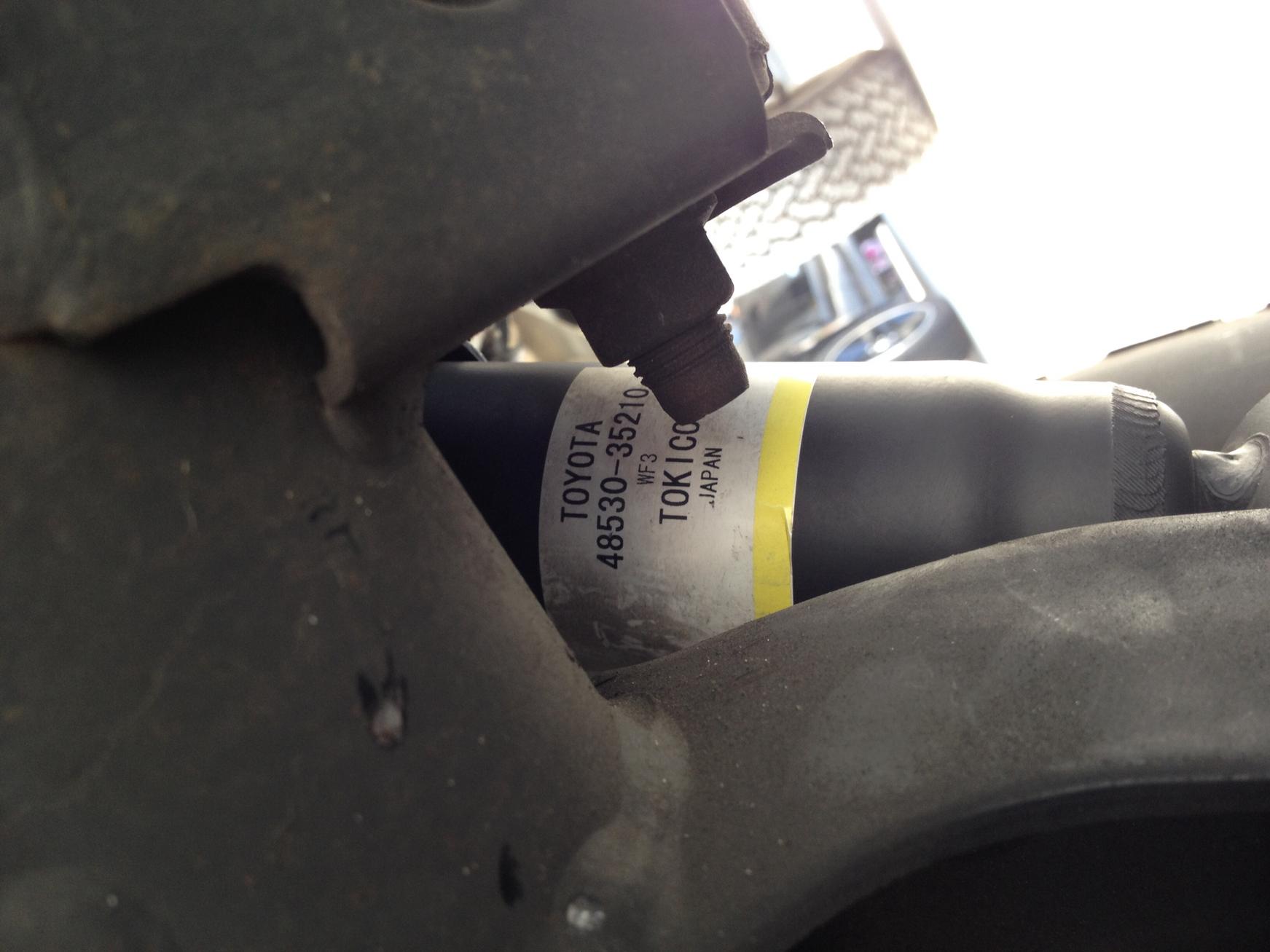

The shocks will work fine. You may need to extend the bumpstop but thats about it.

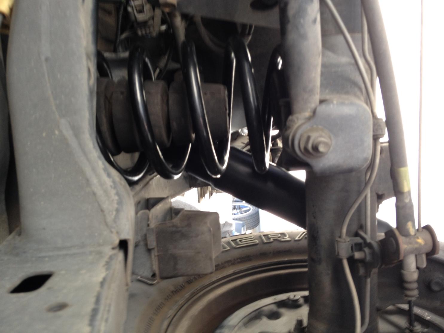

The rear coils will kinda fit but they are a larger diameter than the 3rd gen ones so they aren't ideal. I bet if you look at the spring perch on the axle, its not fully seated properly.
I picked up a few packs from O'rileys. No special tool, just some vice grips. We'll see if that does the trick, I'm still going to order a Diff drop kit from Toytec.

I have to swing buy a scrap yard and grab some longer bump stops. The coil is seated fine. Even the stock bumpers sat in there flush with the coil.
