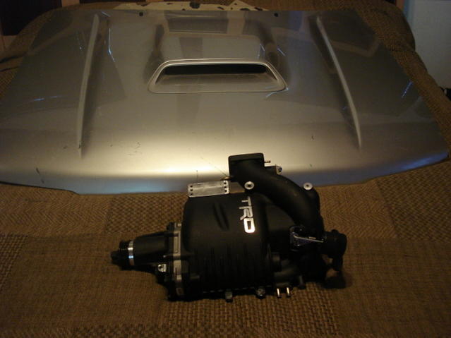

WAIT... your sig says a "TRD supercharger to be installed"??? How do you have a TRD supercharger and not have it installed within A DAY!! :D (so jealous!!)
sorry man, but I had to tease you!
