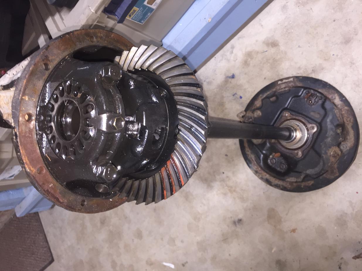

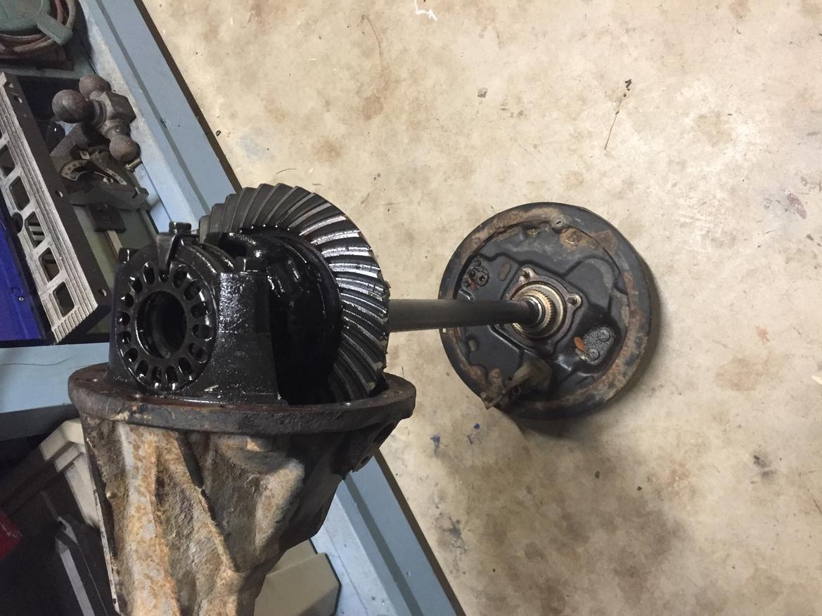

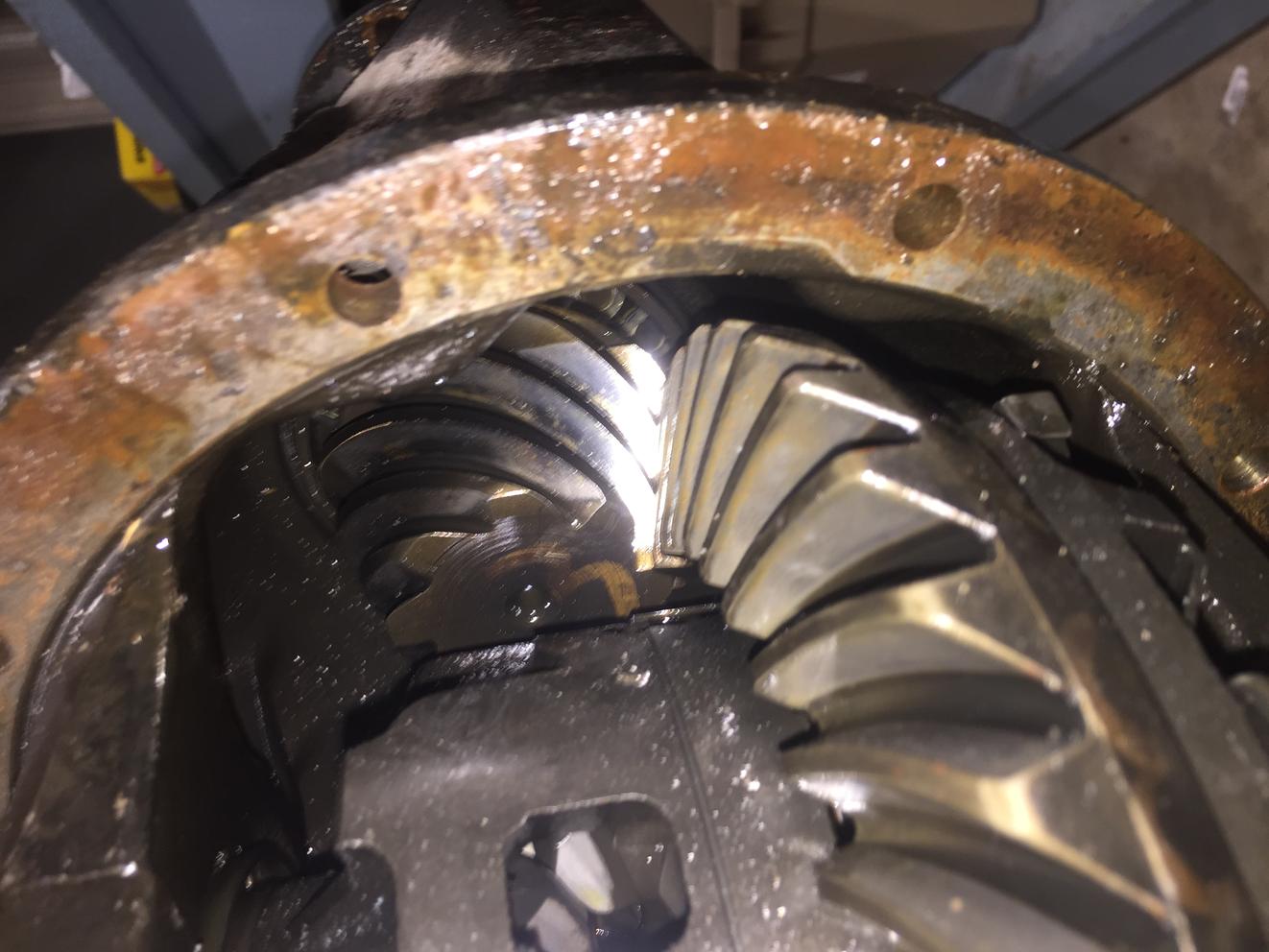

Alright so I just happened to have a buddy going to visit family in Richmond for Thanksgiving. And he picked up the rear diff. for $175. The guy said he was parting out a 1994 4runner with stock 4.88 gear ratio. I just happened to have a rear axle sitting around and was able to test fit the spindles. Everything fits great, gears look great, but won't know for sure until I install and run it.

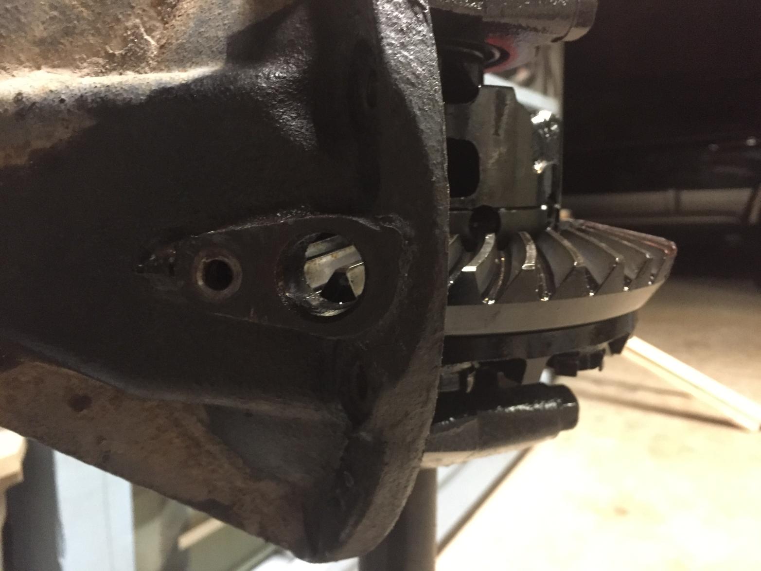

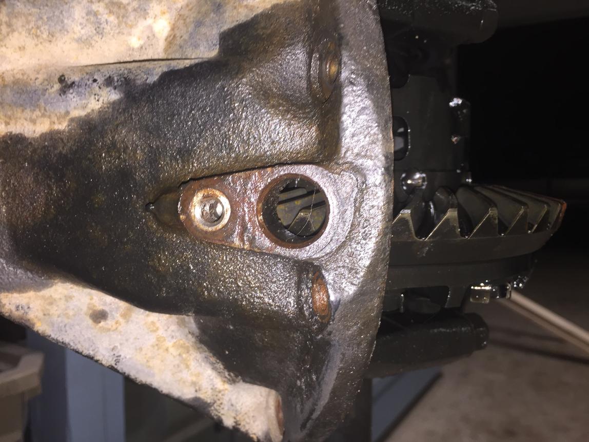

MY QUESTION, the diff. looks like there is a place for a plug for draining the fluid and then another even smaller hole. What are these two holes??? See the pictures. Does anybody know what type of bolt I need or part number? Is this a problem or can I put bolts in the holes, seal weld it, and call it a day. That way I would still drain/fill my rear axle like orginally designed. And just a refresher this is going on a 99 4runner.

Speedo sensor ports if I remember right on the older stuff. Mine still has the sensor hangning out on top, not sure about the side port, I'll take a peek if I remember.

You confirmed with what I just read online. Do you think I should install a speedo sensor just to plug the diff. (which I'd rather not do) or is there a way to run a bolt through it?
I am trying to find a mod where somebody bypassed the speedo sensor or removed it but have came up empty.

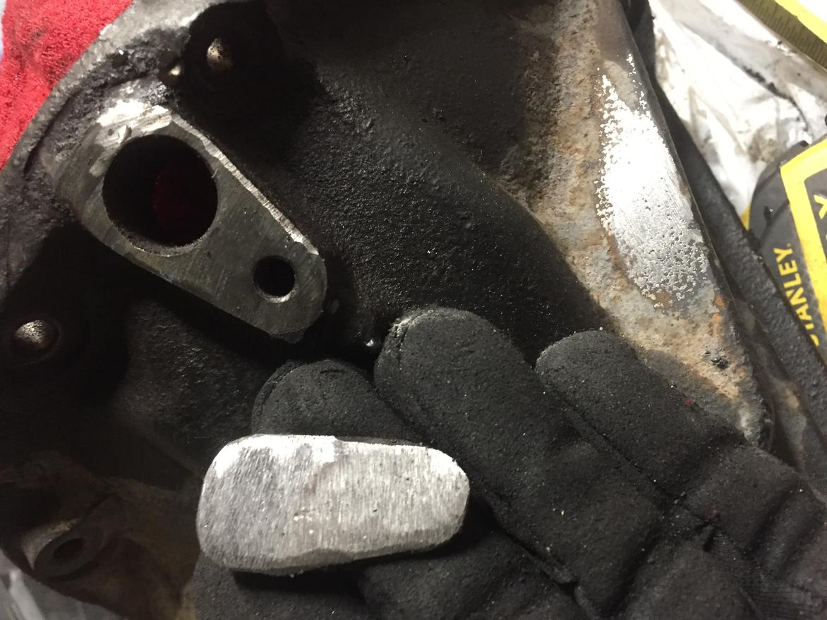

I am really considering just cutting some 1/4" steel plate to match the face of that whole speedo sensor mount. And then welding it over the mount. I have seen people weld diff. protectors on, so the welding would mess up the diff. What do you think about that idea?

You could chop the steel out and drill the hole for the bolt and seal it up with silicone and bolt it down into the small hole, or just put a bolt with a nut on it if there's room. You may also be able to tap the hole and thread a bolt in.

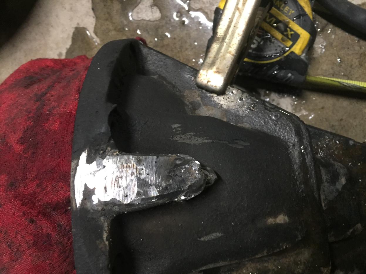

I do not have the tools required to tap that large of a hole but I could buy them... The silicone idea leaves room for possible down the road hassle. You don't think welding a plate over it is a viable solution?

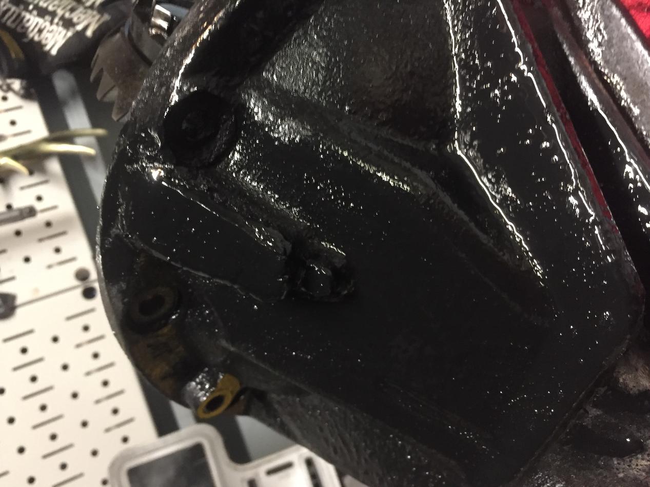

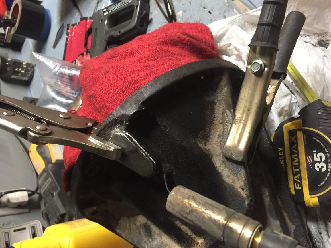

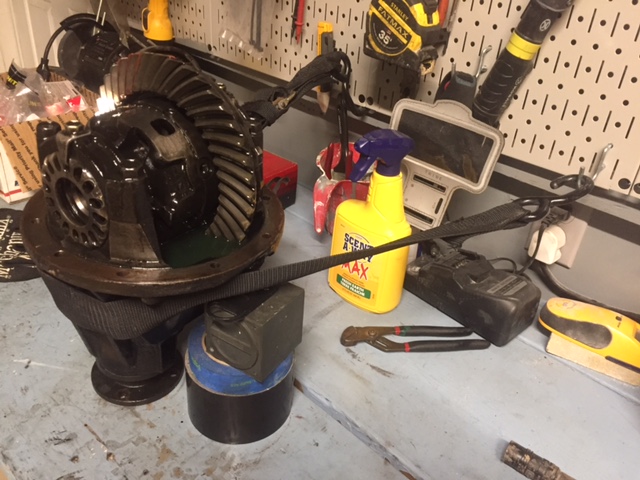

Well I did it. I welded 1/4" plate over the holes. I didnt take the time to grind it down perfectly because I will never be able to see it. Tomorrow I am going to stand the diff. up and fill it up with gear oil. This will allow me to clean the diff. and make sure its sealed.

Filled the diff. full of gear oil last night. When I get home from work tonight hopefully I do not find any gear oil leakage.
