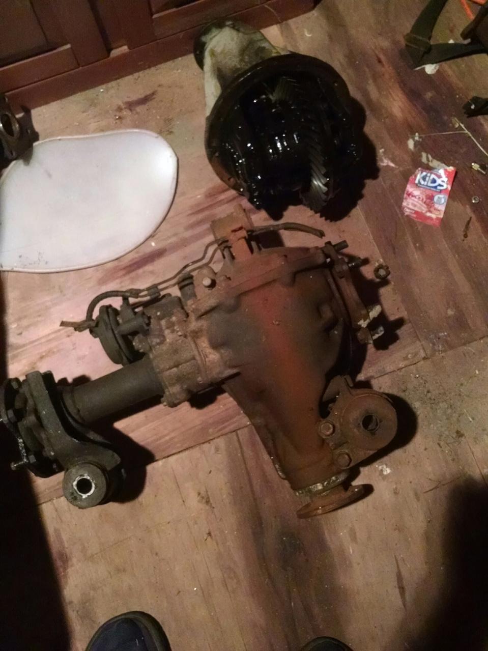

I'm almost certain we were talking axle shafts - It is sitting in my side yard so I'll count again and get a pic. We did not know the history of the donor vehicle so it is possible there were some non OEM parts.

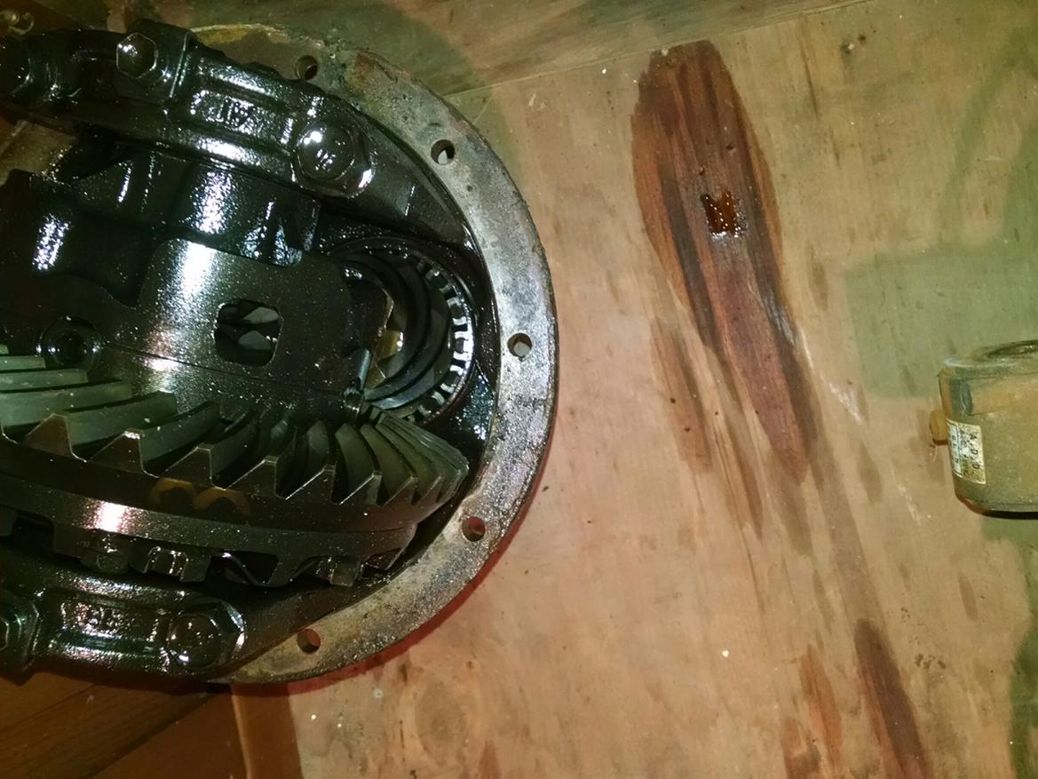

Alright so I found this guy on craigslist selling a 1995 4runner front and rear diff. with 4.88 gear ratio. I know the front diff won't work but even at $350 that's a deal on a rear diff. The catch is the guy says they have 210k miles on them and is selling them because he is parting out the 4runner... I don't know its worth the gamble.
Also the guy is in Virginia and I am in South Carolina!
Toyota 4.88 gears front and rear differential
