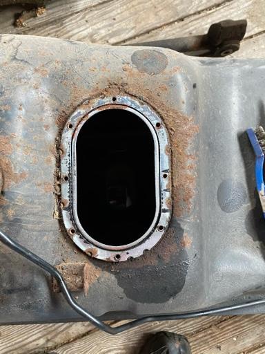

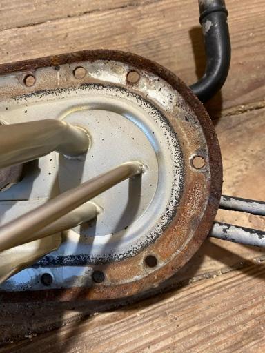

The gasket surfaces on top of the tank can rust and cause a vacuum leak. There are two rubber gaskets.
Here is an example
