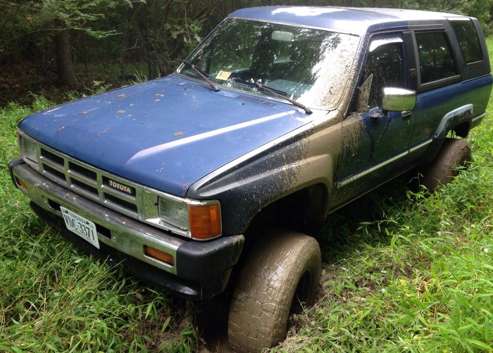

Well first wheeling attempt went nowhere near as planned. I figured I'd just cruise down a power line next to my house that I took my 2nd gen down all the time with no problems, however in the past few months I guess someone's been playing back there and the tall grass disguised the ruts left behind very well. Needless to say the 4runner went down in some holes and both front tires just kinda hung there flinging water everywhere. Luckily my buddy had his truck at my house and we snatched it out pretty quick. I haven't had a chance to rebuild the double cardan yet so I had it in 2wd when it went in the holes and by the time I got it 4wd it was too late, aside from a lot of banging coming from the front shaft the 4wd seems to work good so that's a plus.

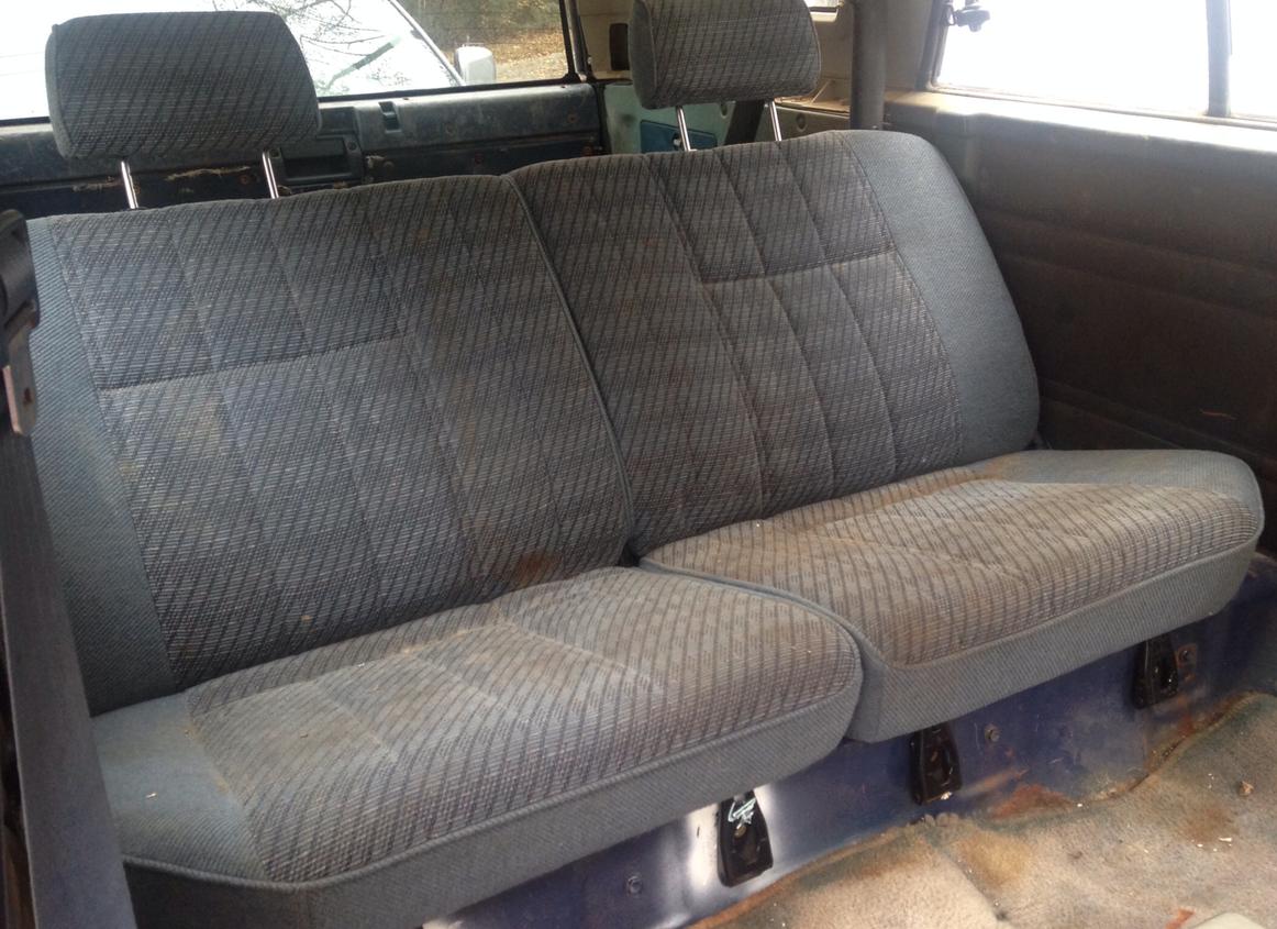

Got the 2nd gen rear seat in today. It's been a pretty big project but worth it, this seat is much nicer and more comfy than the old bench seat. I'm actually going to do a write up on it for anyone curious about doing it to their own but I guess if you have a SR5 you basically already have what I got now. Stay tuned for more.

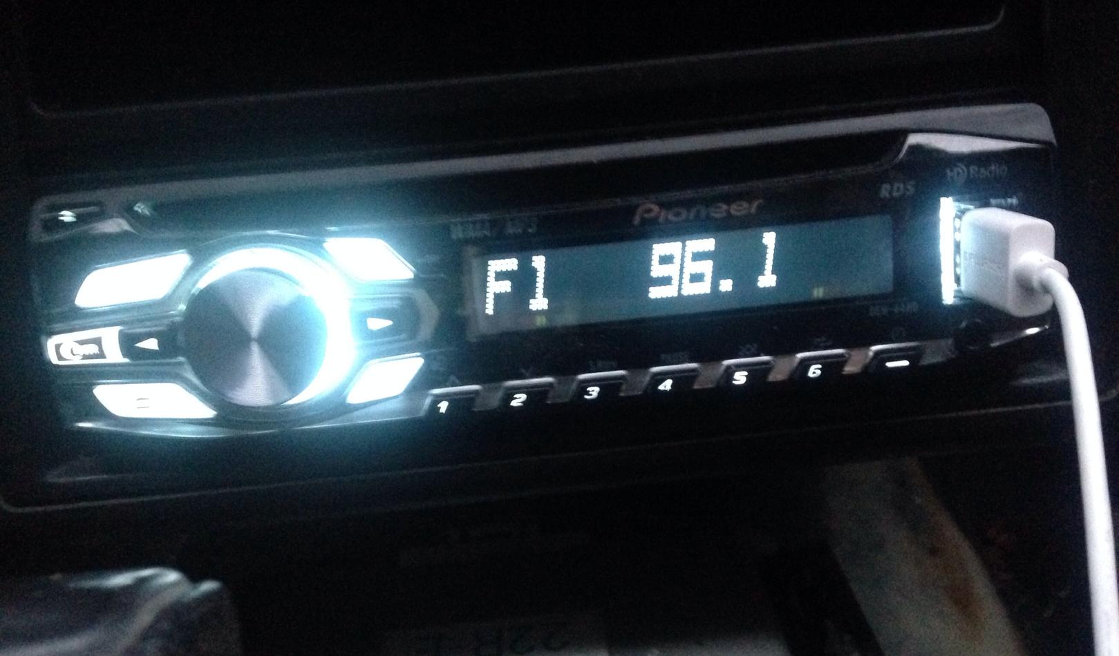

Also slapped in a new radio today. The stock cassette player wasn't quite cutting it anymore. image.jpg

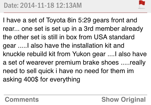

Found these on Craig's. Is this enough info to tell me these will work for me? Wasn't sure if ifs and solid axles are the same. Good deal??

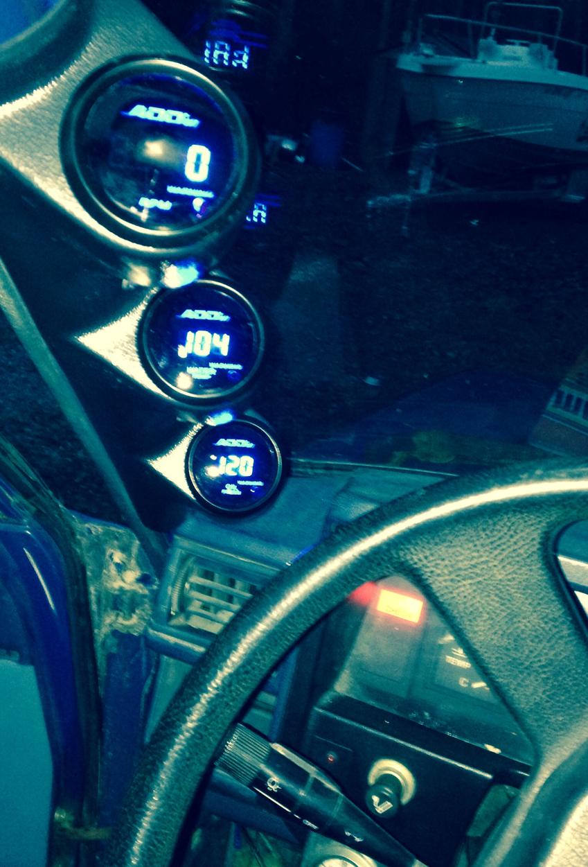

About time I put these in. Still gotta wire up all the sending units. Been sitting in the pass. seat for about a month now. Got my H4 headlight conversion on the way with the upgraded wiring harness. Pretty stoked about being able to see at night.

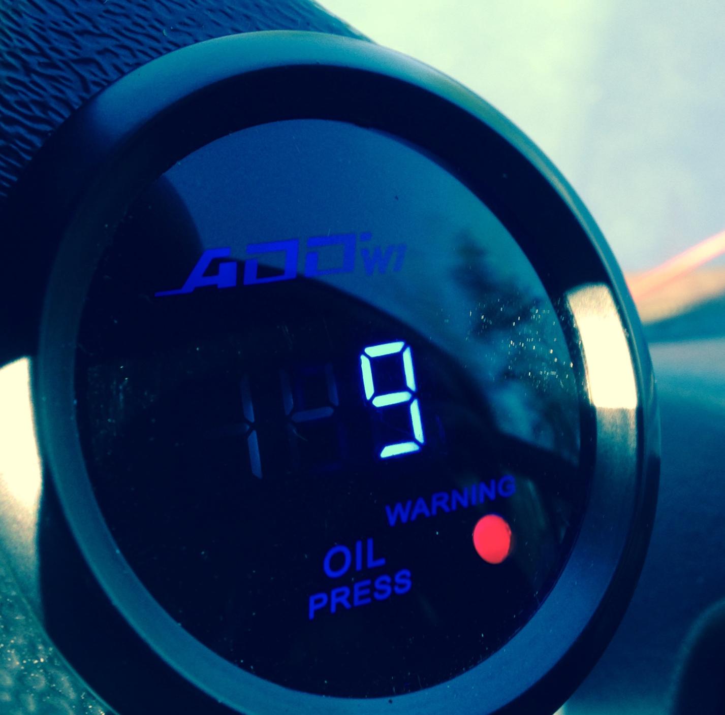

Well maybe I didn't want to see what my OP was!! When I first started it it was 30psi at idle and it steadily dropped as the truck warmed up. It does go up with acceleration so should I be worried? When I did the timing chain I checked the oil pump clearances and all were in tolerance. I guess I should of just got a new pump. :AK47:

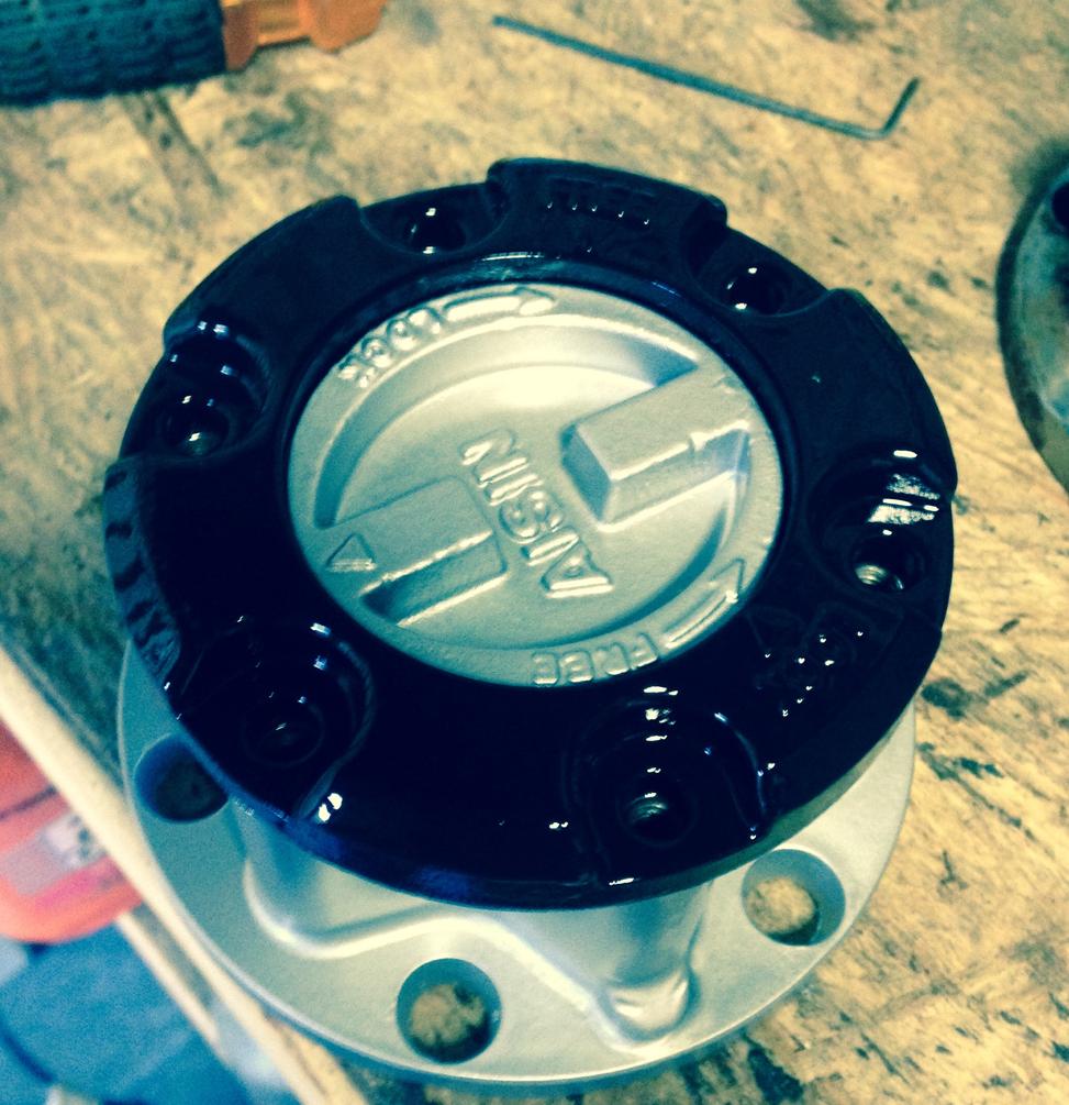

Also decided to rebuild a set of junkyard hubs I picked up and swap mine out. Ordered a Spartan Locker for the rear today and will be locking the front soon as I figure which route I want to go. Getting closer to being ready to hit some trails.

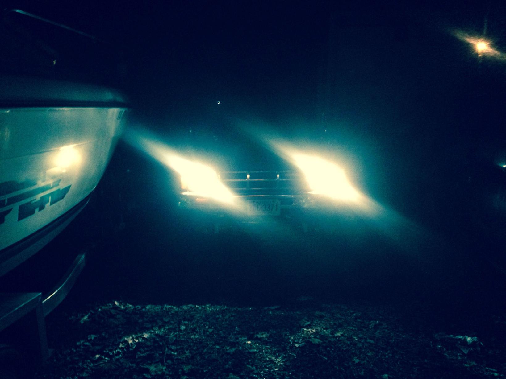

Holy S*** I can see!! By far the best upgrade to date. Went with the highest dollar Phillips H4's that pep boys had and I'm impressed. Glad I didn't waste my time with HID's. The upgraded harness was also a wise investment. I think including the bulbs I got about $120 into this and it's worth every penny.

I went ahead and ordered an Aisin oil pump as my OP seems to be steadily getting worse. I was driving it the other day and once it warmed up the OP went to 0 and the water temp kept rising. By the time I got her home the temp was 235 which its normally 180 so I guess not putting an oil pump in when I did the timing chain is biting me in the a$$. :frusty: All well, new pump should be here Wed.

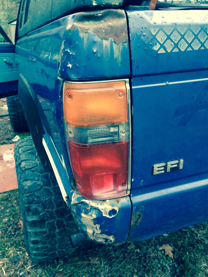

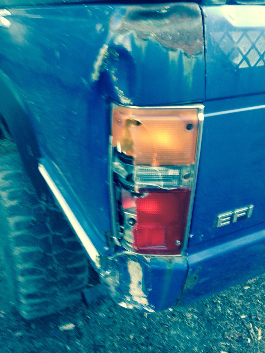

Oh and I forgot to show you guys my latest mod. We'll just call it trail damage...image.jpg
Well it was a tree. I was backing into my yard paying close attention to where my pump house is and forgot about my wife's Crepe Myrles and KAABAAAMMMM. Luckily my back glass was saved. Picked up a set of tailights also on my junkyard excursion for $20.

But I got it popped out enough to get the light back in. Luckily I got a buddy with a stud welder he's going to let me use. Gonna need quite a few studs for this I guess.
