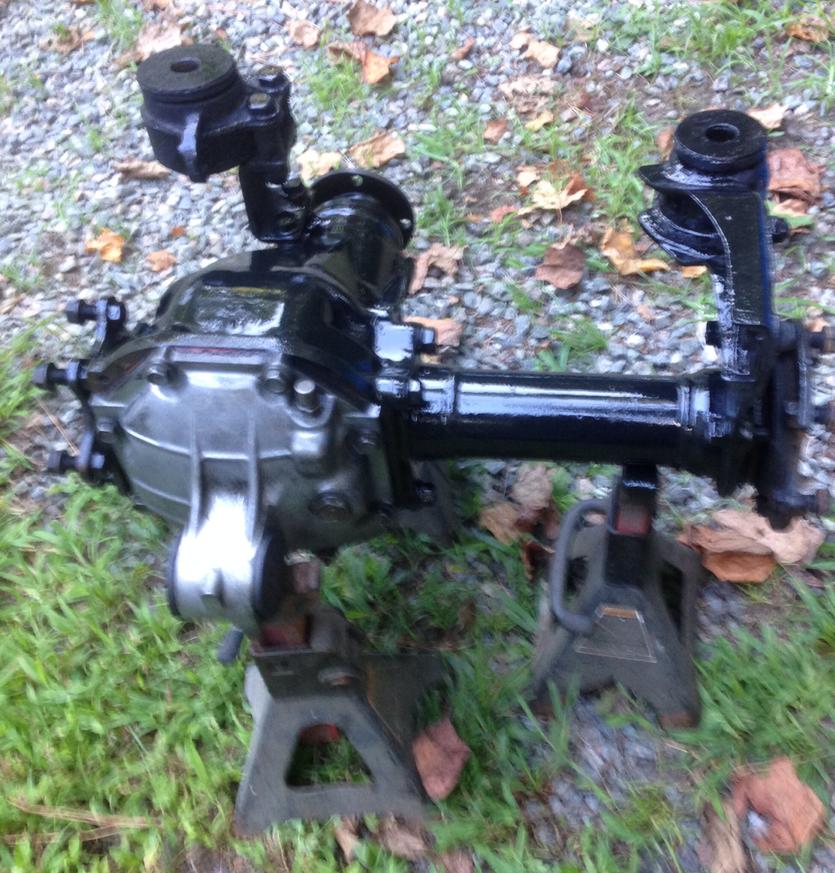

Front diff bath day!! Those missing timing cover bolts gave this thing a thick layer of anti-rust coating. Squeaky clean!!

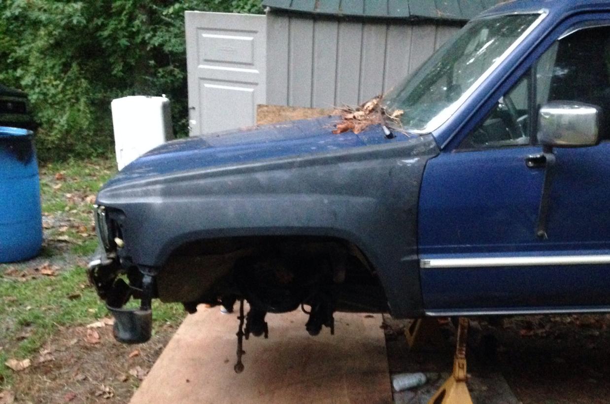

Well since I'm now waiting for the parts guy to bring me my front end goodies figured I'd slap on the fenders to kill the time. I got to do some tweaking but I guess that's to be expected for these Tiawanese pieces. But for what this rig will be used for body gaps will probably expand and contract regularly. image.jpg

I love coming home from work to a porch stacked with parts!!! RockAuto came through again, ordered parts Wed. and they're here Fri. Looks like I'll get this thing back together this weekend after all.

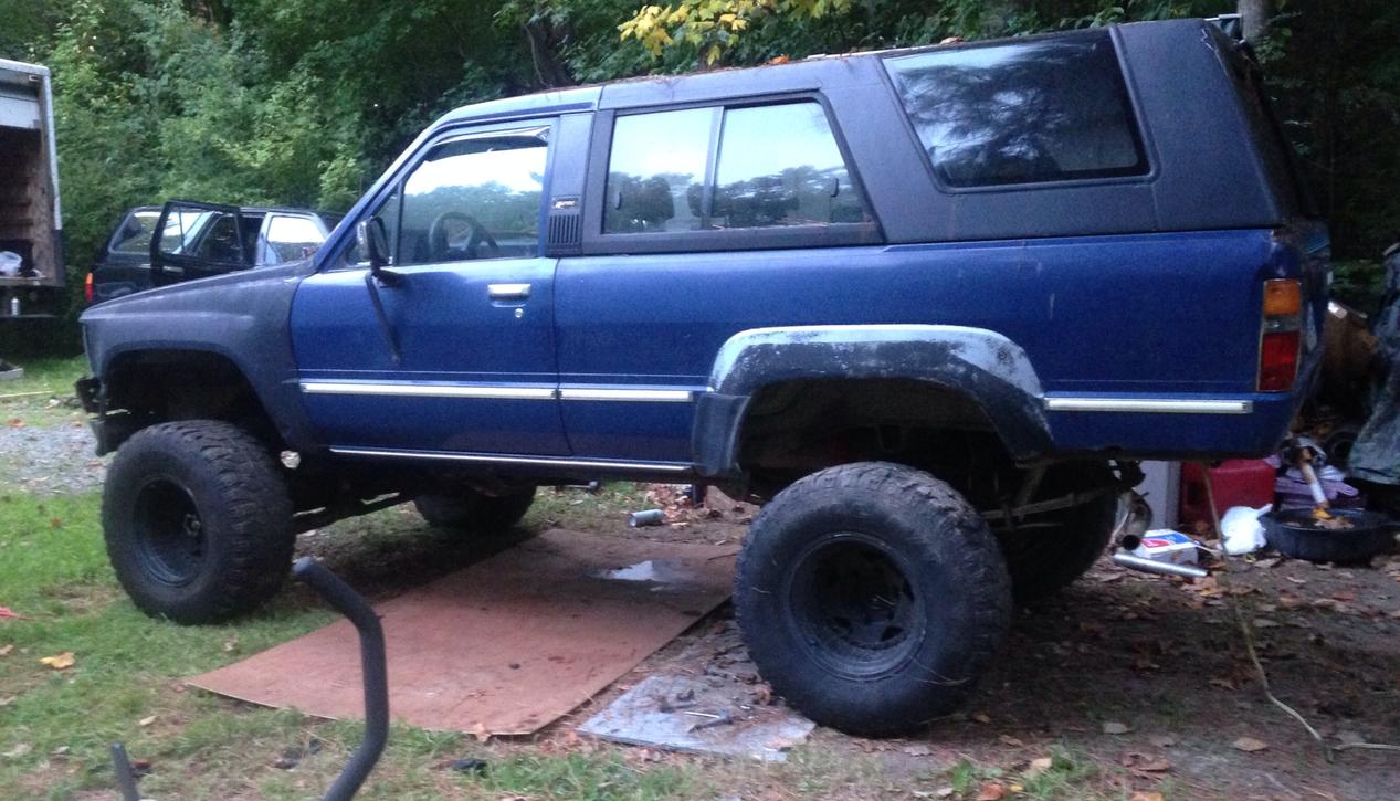

So here's where I'm at. Got the lift done just got to button a few small things up. I have a caster/camber gauge and a toe stick we use on racecars and I believe with the locking hub off I can use it to get my alignment close enough to get me to a shop. Anyone know how many degrees of caster and camber I should have? I've read that with oversized tires about 1/4" toe in should be about right but I can't find any info on the caster/camber.
In other news the brakes still aren't complete thanks to the geniuses at Advance Auto. Originally I was ordering calipers, then I saw a write up on rebuilding them so I thought well that sounds cheaper so I ordered rebuild kits. Got mine apart and the pistons were destroyed by rust (they were mostly out of the sleeve for god knows how long). So I ran quick to Adv. to exchange them and the left side they gave me will not fit over the rotor and the right side is crushed a little where the line goes in so I can't get the line in. So back at it tomorrow.

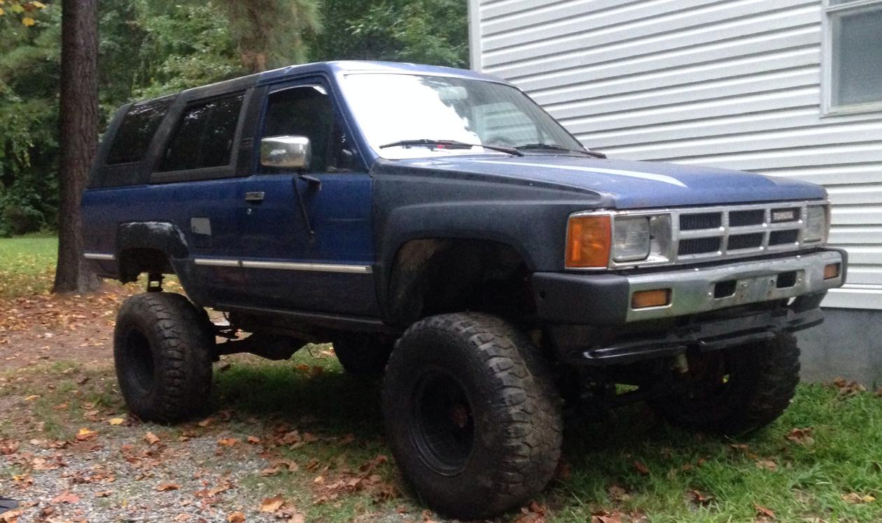

Well took her for a test drive today and I gotta say, not bad. I'm having some troubles with the alignment though. I talked to my buddy who works at a shop with an alignment rack and he told me to probably shoot for +3degrees caster and -.5degrees or less camber. As it sits I have the cam bolts giving me the most positive caster as possible and from my gauge I'm getting +1-1/4 degrees. And on the left side I have +1-1/2degree camber and on the right -1degree camber. If I try to do anything about the camber I lose caster. So would running negative caster and getting my cambers right be better than what I got?

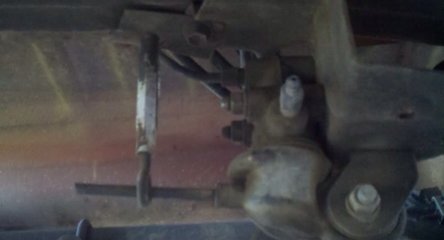

Found this while digging around yotatech. Was thinking about deleting the lspv but this seems like an effective way to deal with it too. He has a turnbuckle there so he can adjust it. Pretty cool trick.

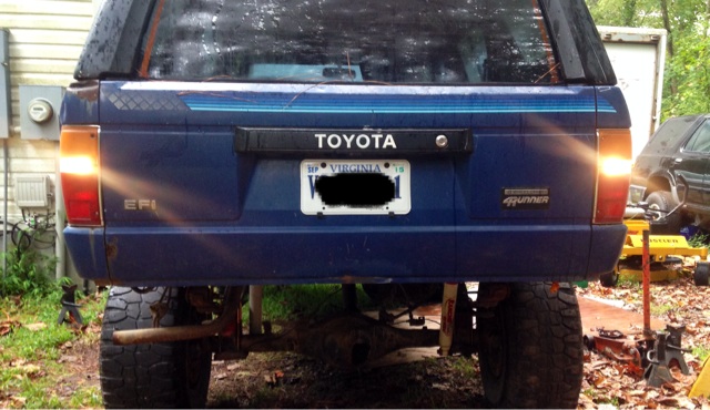

Hey how bout that I got reverse lights!! I really need to remember to take pics of my projects as I go and they can help others. After reading the FSM I was convinced my Neutral Safety Switch was out of adjustment. I re-adjusted it like the book says and still nothing. No reverse lights and the truck would start in any gear. So I pulled the NSS off and did some continuity testing and came up with nothing. So I figured hell I'll just order a new switch. After almost choking when I found out these things are like $300 from Toyota I figured what the hell, it comes apart so let's see how it works and maybe I can fix it. After I pulled it in half I still had no clue how it worked because there was nothing but dirt and old hard ass grease in it. I cleaned it out with some carb cleaner (probably should of used electrical cleaner but had none on hand) and quickly seen all the contact points. Pretty neat and simple design really. Also if you want to do this just to freshen yours up be careful, in the swinging arm there are 2 tiny springs that I imagine will fly out if yours isn't as corroded as mine. So I got everything cleaned up, Emory clothed the contacts and did some more continuity test straight to the contacts and every wire indeed had a contact, so it looked like it was good to go. I coated everything with electrical grease and put a thin coat of silicone on the o-ring gasket. Put it back on the truck, adjusted it and voila!! It now has lights and will only start in P or N. I love saving money!!!!!!! image.jpg

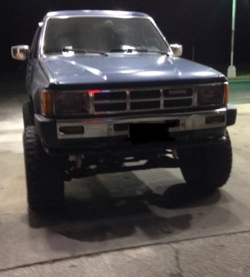

Took the old girl on the maiden voyage to fill her up tonight. Not a bad ride, few bugs to work out. Have a wierd rattle/grind when I let off the throttle coming from the back end somewhere. It goes away as long let completely off the gas, if I slowly let off the throttle it will just rattle away. The headlights are definitely not worth a damn. Even high beams suck. Maybe a H4 conversion is in order. image.jpg
