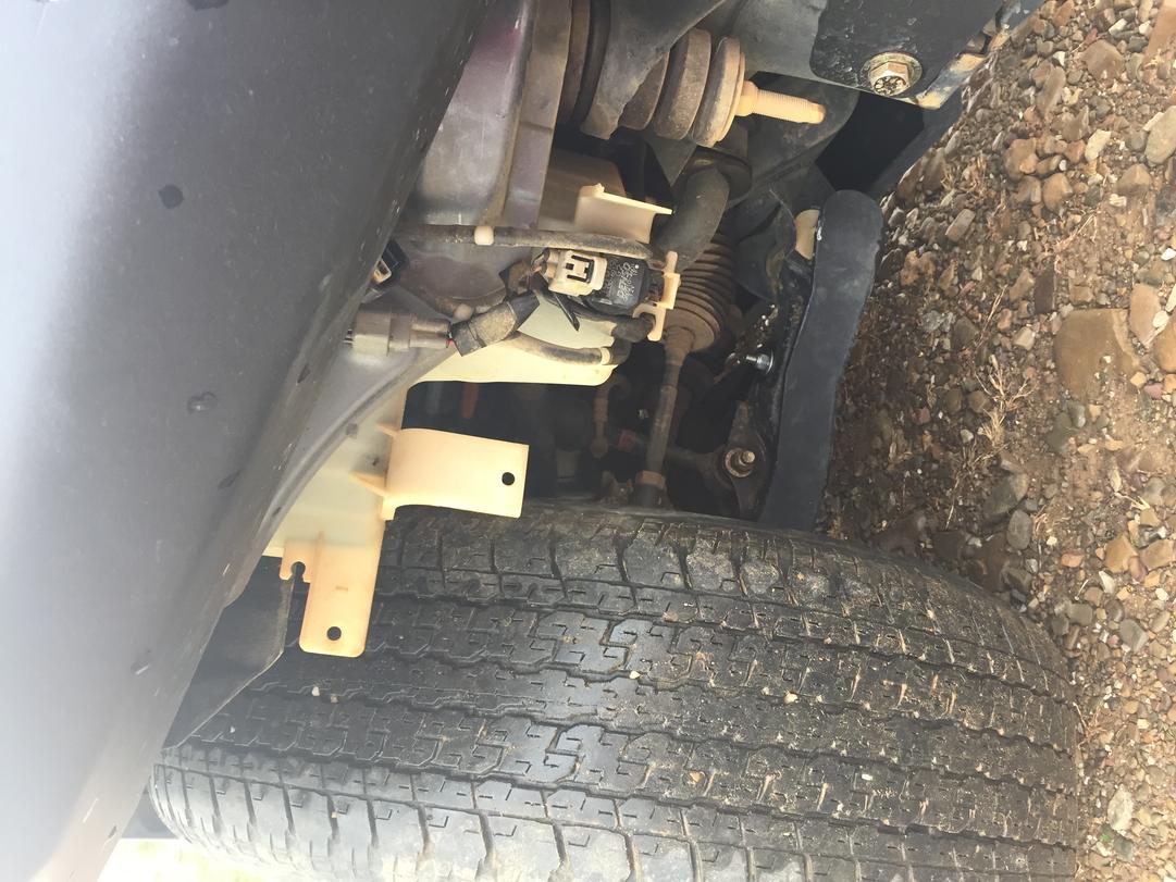

I was curious about what y’all do with the parts of the reservoir tank that stick out? I’m thinking it’s alright to cut the tabs and then just paint everything matte black, unless someone knows of a way to move it? Also, in the picture, there’s a denso plug of sorts & I have no idea what it actually is. Thanks for any inputs.

I can't advise since I have stock bumpers, but I have read that many swap it out with one from other model vehicles which are shorter, can't remember which ones.
I believe the denso piece you're referring too that is below the tank(?) and has hoses attached, I think it's the washer pump just from looking at it.
Yeah I figured it out about the denso after I had posted lol. That’s interesting about swapping out for a smaller reservoir tank, makes sense. I’ll search around about it. Thanks for the reply!

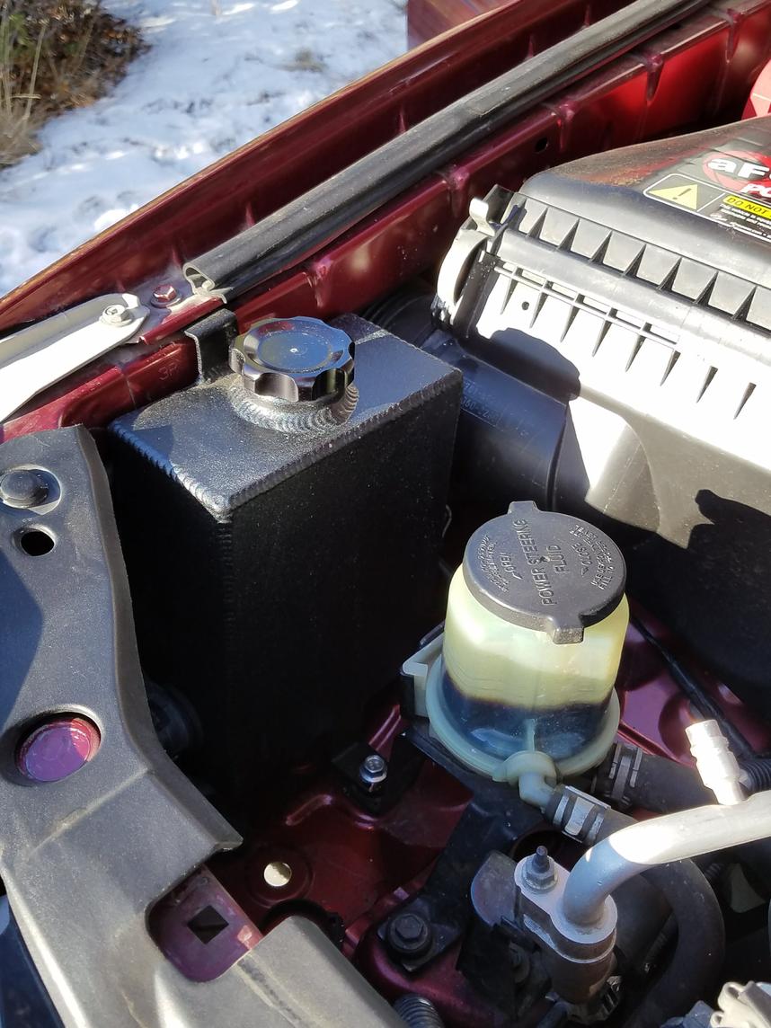

So that is the plug for one of the washer pumps. There are two. I initially just cut off the tabs and painted mine black. However, in colder climates the washer fluid would freeze. Yes, I know they make fluid that can go to colder climates but good luck finding it in CA. So, during their Xmas or Black Friday sale I picked up a Rocksteady Washer Kit on sale. It isn't cheap hence why I jumped on the sale, but it is nice! And my fluid didn't freeze when I was up in OR in the snow so I was super happy. It's a great piece with detailed instructions and would highly recommend. I just sprayed it with truck bed liner but you can get it powder coated if you like.

Where is your second battery? In front of the airbox or behind? Rocksteady's goes in front and most second battery installs are behind the airbox. Or just get a 31M battery and skip the dual. :)

I removed my factory tank and installed a universal tank from Amazon directly behind the passenger headlight. It has worked well so far.
