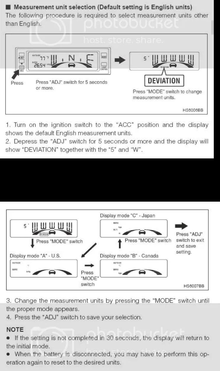

I know this thread is older but wanted to check if anyone has tried to use the Suby adjs to change the 'Measurement Unit Selection' - it shows how to change from US to Canada to Japan - US temp selection displays in F. I searched alot but did not see where anyone had attempted this adjustment to the Toyota FMU.
Has this been tried / debunked or has anyone been able to change from C to F for the Toyota units?
Hopefully a gamechanger for alot of current FMU owners?!
Hmmm interesting, I haven't seen this sheet before. I'll give it a try in an hour once I take lunch
Edit: I think that actually might be for Subaru units, given the display shows a car and not an SUV, and if the FMU was never intended for the American market I don't see why it would have a setting for it, but I'll still give it a shot in a few
Update: my suspicions were correct, it does not work with the Surf FMU

Thanks for checking - that's unfortunate - although both boxes made by Jeco - was hoping that would work perhaps. Good that you checked.
I guess its possible if some EE were to break open both boxes to find what tweaks were necessary to add that functionality to the Toyo boxes but not an engineer here.
