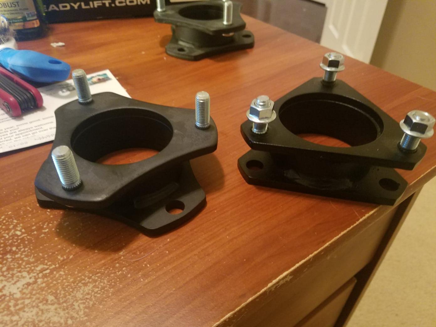

Marking for motivation to finally put the Ready lift spacer kit on my 4runner...with modified ( clocked position ) front spacers.
Had this spacer kit sitting in the garage since 2017 when I bought my first 4runner limited lol
Now have a 2019 limited
My Ready lift has modified front spacers that are clocked in line so I do not need to rotate the strut or the top spring perch.
Original Ready lift spacer on Left ( with clocked mounting holes) and inline spacer on the right.
Only thing I am worried about right now; is wonder how long the OEM strut studs are and if they will be to long... nothing a grinder can fix :) but hoping I will not need to grind on anything.

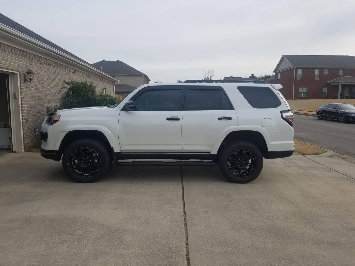

2019 Limited NightShade
3K miles
275/55-20 XP wheels ( South east Toyota dealership wheel package with WORN OUT BFG Rugged terrain tires lol thinking Cooper AT3 XLTs are the replacement tire I will be going with
~5 hrs install including lunch.
Ready lift spacers F/R (+3" and leveling)
Bump stops F/R by DURO Bumps/ toyotabumpstops
F. Diff drop
F. Sway bar relocation kit
Skid panel spacers
We took our sweet time :)
Now to get an alignment.
Still tracks straight but
have about .2 POSITIVE camber and perhaps a little tow out.
Anyone heard of waiting a couple days to get an an alignment in case things "settle in"???

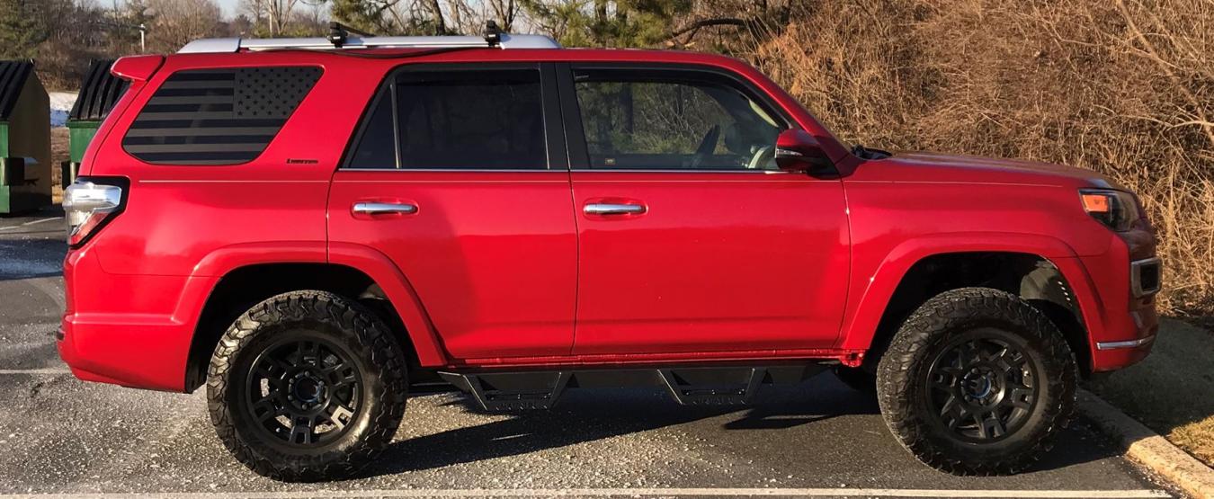

Had to remove the small front mud flap and still need to do a tiny bit of trimming on the front inner plastic. Overall very pleased, though.
Looks awesome! What spacer lift did you use? No issues with Xreas? What tires and rims... the look awesome!
I think with the TRD Wheels you could have went with a 275 because of their offset.
I had to go with 265/70/17 Falken WildPeak's with my SCS Ray10's. Even after the Daystar kit they still rubbed a good amount. I removed the front mudflaps, pushed the liner in about an inch and then used a heatgun to push the middle of the liner in some more.
3s1kill What rim size/offset did you go with on your Ray 10s?
Hi! Trimming wasn't too bad at all, but I have the factory trail edition wheels so my offset is not as aggressive as some aftermarket rims.
I pushed the liner forward and trimmed the little plastic area that I circled (old pic for reference... obviously I'm not on the k02 any more). I didn't need to loose the little mudflaps but I'm running SPC upper control arms though and have 4+ deg of caster. Also, I custom cut my rocker panels (I have a LE) so it may be different on a trail or SR5.
