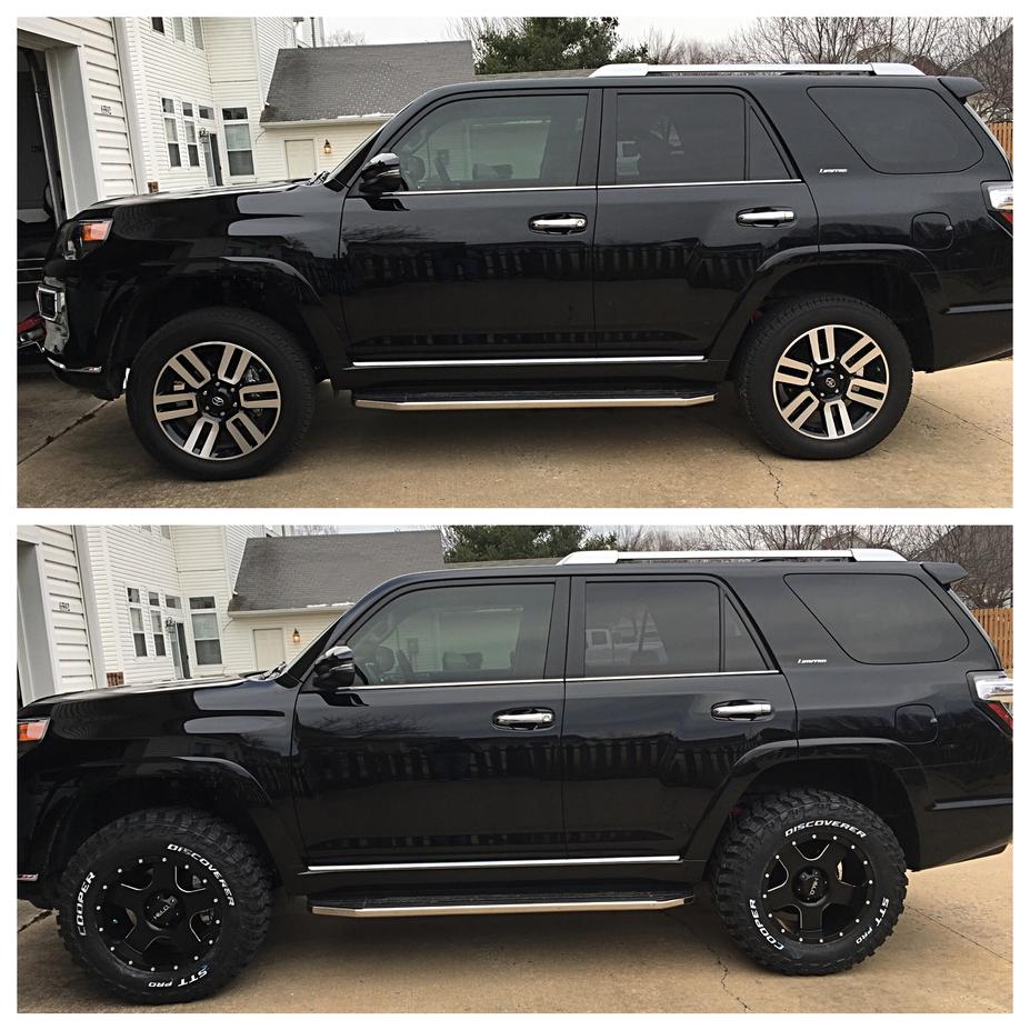

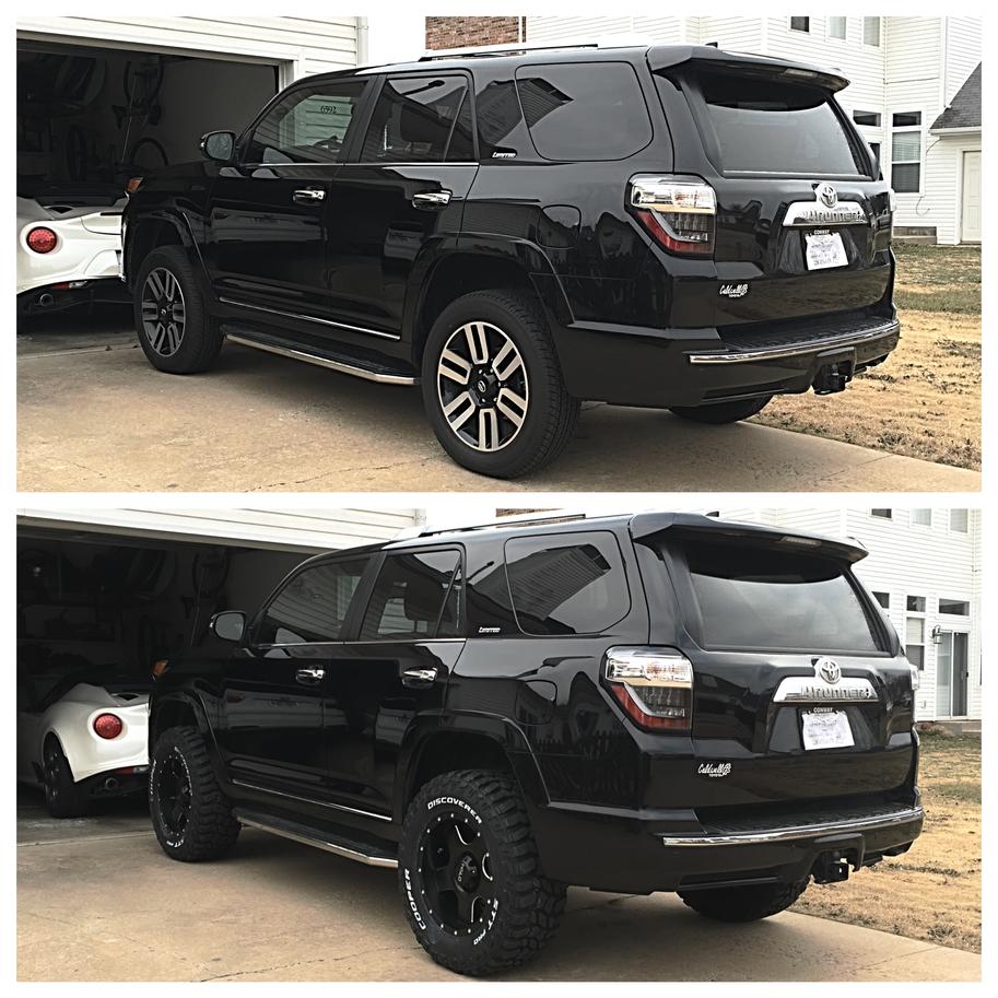

Thought I'd provide an update for anyone potentially researching this as I was a few weeks ago. Dropped it off with my indie mechanic, and he had it knocked out in about 1.5 hours. Said the install went smoothly enough. The front was a bit more of a challenge, but he stated that the rear was probably the easiest thing he's ever done in his shop.
Looks: MUCH better in my opinion. New wheels and tires go on tomorrow. Can't wait to remove the skinny OEM's!
Ride: Can't really tell much difference at all from stock. Maybe slightly more firm, but I'm used to sport/lowered suspensions on my cars. Will get an alignment soon, but it's tracking nicely already.
Finished Product
Had to remove the small front mud flap and still need to do a tiny bit of trimming on the front inner plastic. Overall very pleased, though.
