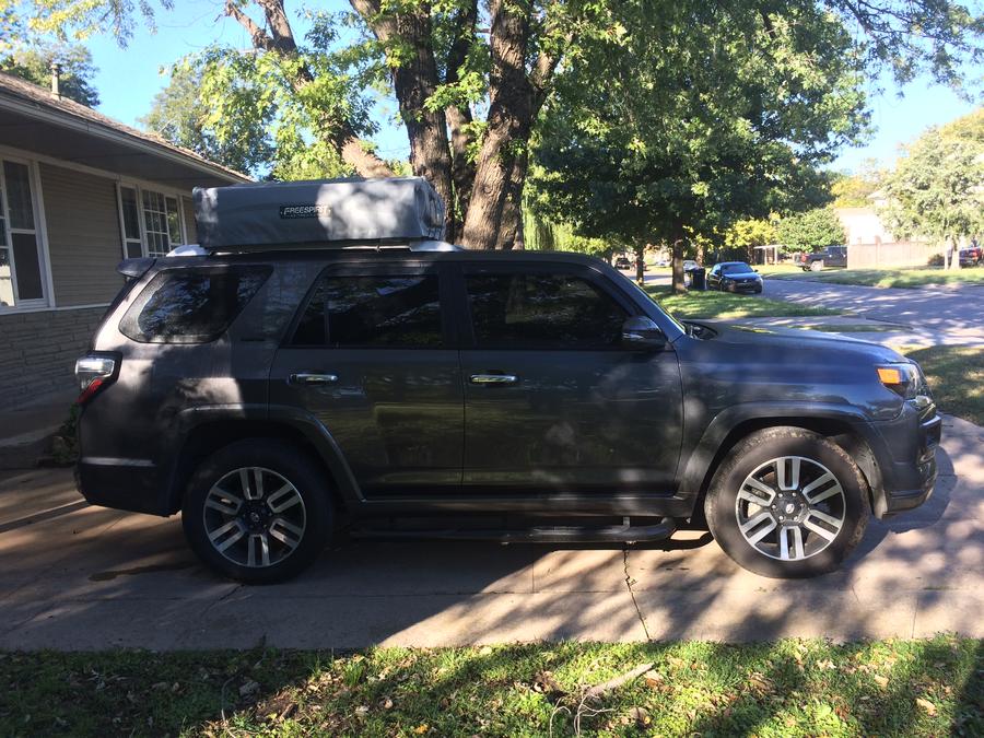

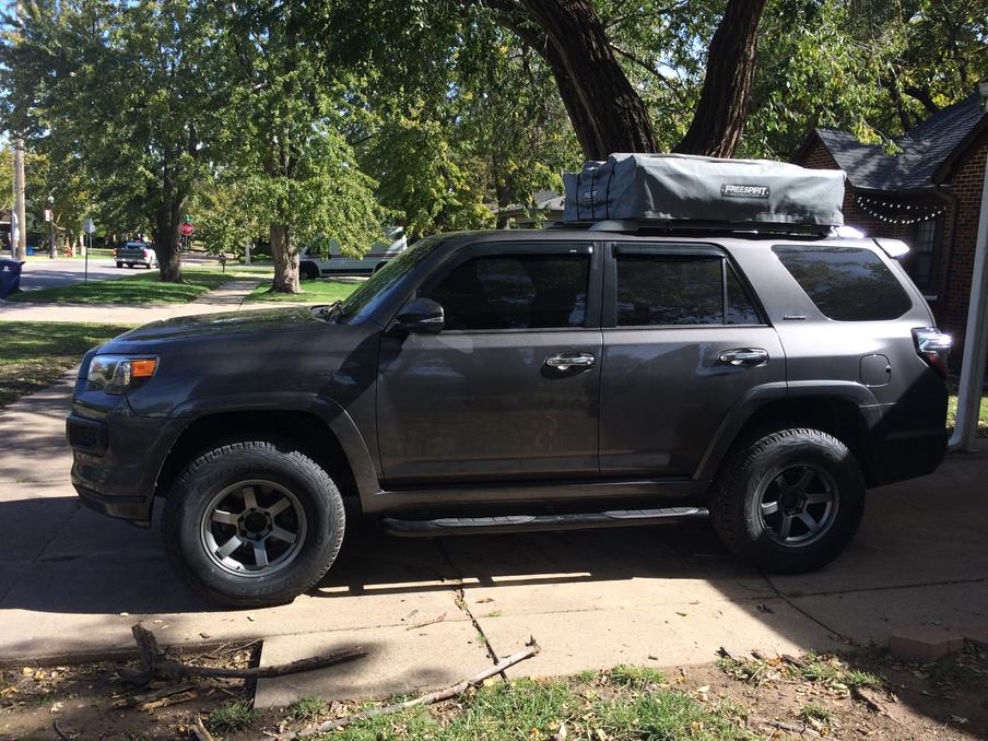

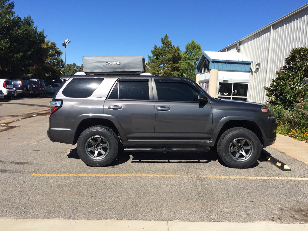

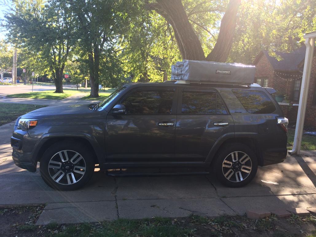

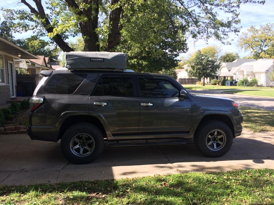

Love how mine turned out
I could not be happier with how my lift turned out. I bought the exact Daystar kit as the link listed in the comments above and it was perfect. A local lift and off-road shop here in OKC had it knocked out in about two and a half hours. In my opinion, the ride is almost exactly the same; maybe a little stiffer than stock, but not enough to bother me. An affordable option for more clearance and overall appeal, I would 100% recommend this lift.
I apologize in advance for how bad the iPhone pictures are. I did not take the originals with the intention of uploading them, but I did not have any others to compare so I took the "afters" in the same spot.
