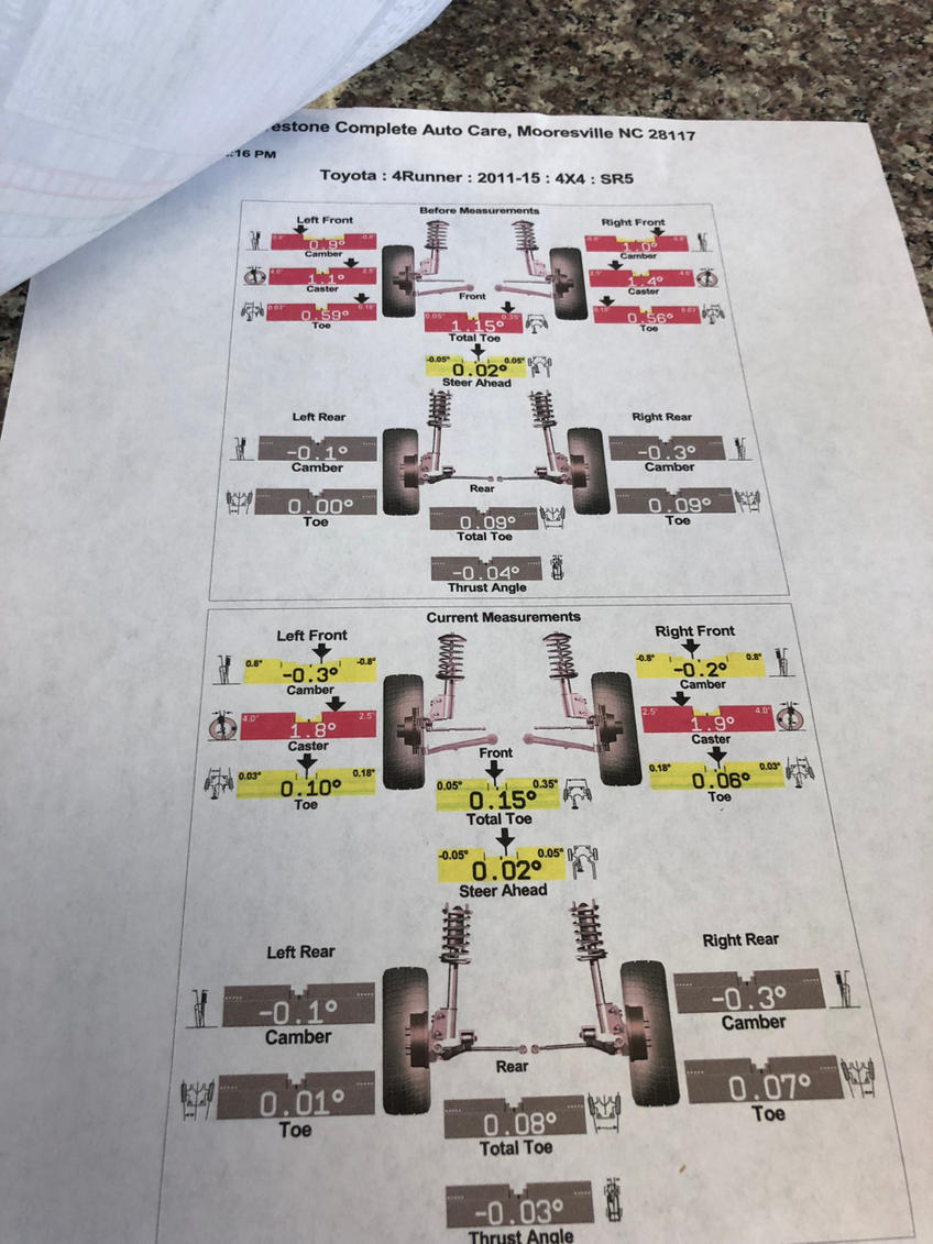

Just got my daystar lift on my limited. Looks so much better. I got it aligned and here were the readouts. Got the unlimited alignment at Firestone. So I'm not sure if this alignment is right. The front desk guy was trying to explain that the caster doesn't matter if it's not within "specs" and that these specs will make the wheel true and straight. What does everyone else think who are specialists with alignments unlike myself.

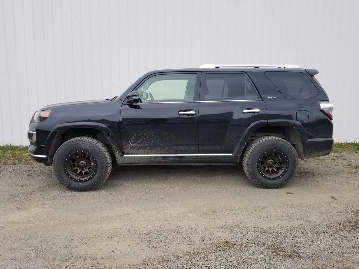

Anyone running 265s with the Daystar Lift? If so, would you please post a pic?
I have the TRD wheels on Toyo open country AT 265/70/17. I am wanting to pull the trigger on the daystar lift. My worry is that after I do, the wheels may look too small and am not interested in upsizing the tires anytime soon

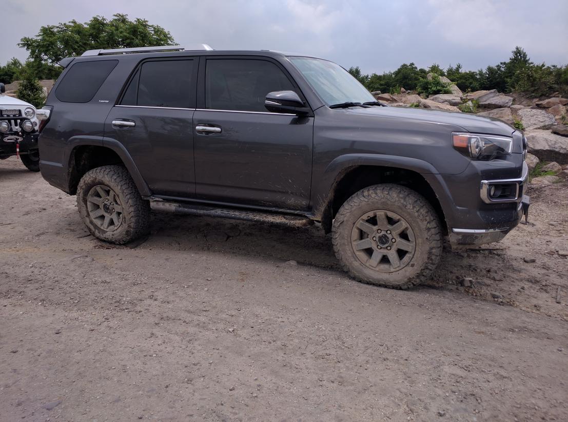

Dirt pic is right after lift with stock size ko2s. Other pic is current. IMO they look small but to each their own.

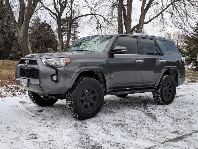

I had to go with 265/70/17 Falken WildPeak's with my SCS Ray10's. Even after the Daystar kit they still rubbed a good amount. I removed the front mudflaps, pushed the liner in about an inch and then used a heatgun to push the middle of the liner in some more.

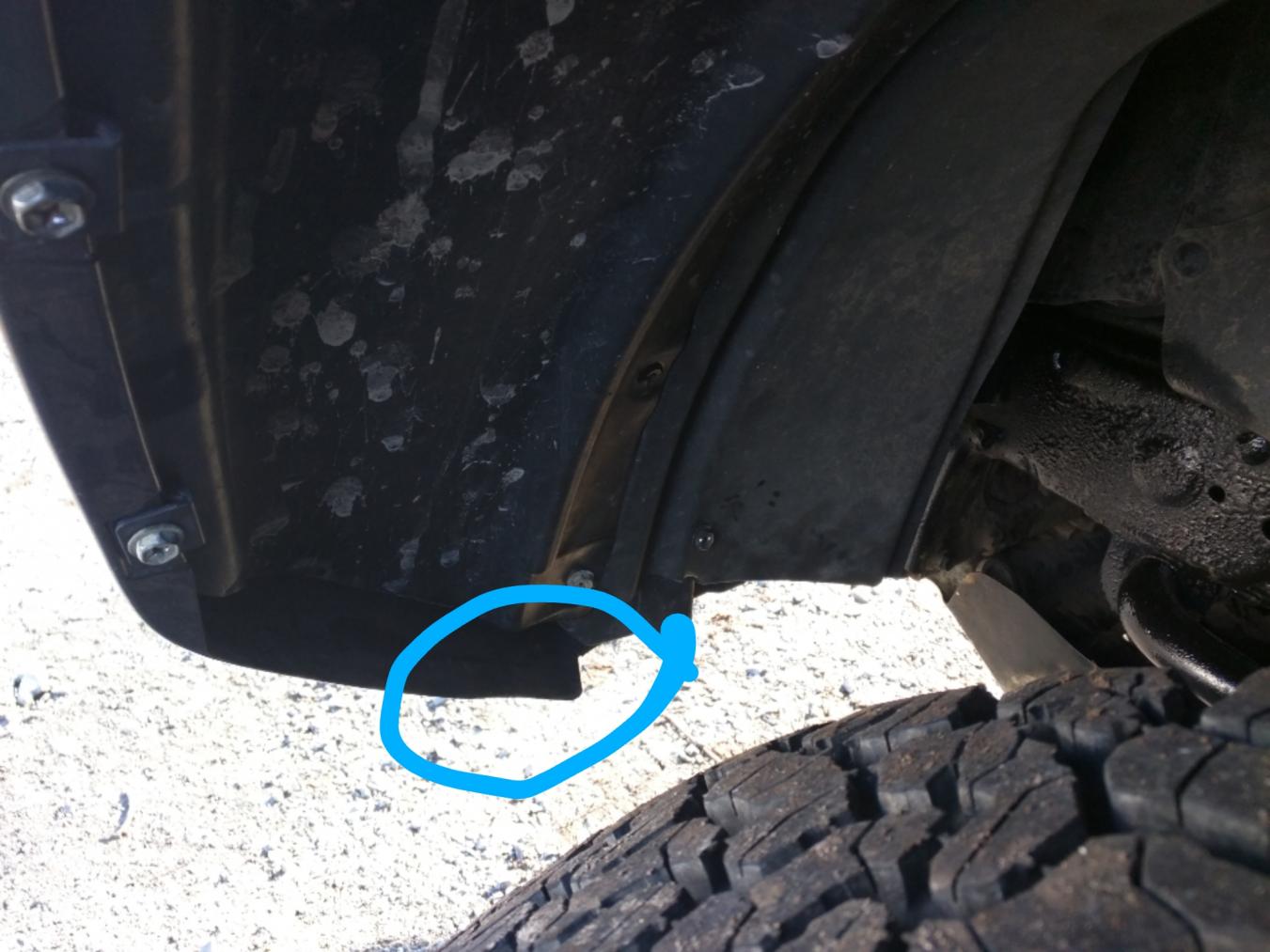

I pushed the liner forward and trimmed the little plastic area that I circled (old pic for reference... obviously I'm not on the k02 any more). I didn't need to loose the little mudflaps but I'm running SPC upper control arms though and have 4+ deg of caster. Also, I custom cut my rocker panels (I have a LE) so it may be different on a trail or SR5.
