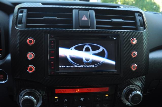

Those Piezo switches are cool, I have never seen them before but I do agree with Okki, you may need some extra circuitry to get them to work right. If you like the looks of those switches you could always check out Oracle as well, Ducmonsta has them in his dash (pic stolen from his build thread):
