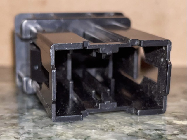

Does anyone know of any 3 way, On/Off/On , SPDT switches that will fit in the factory switch locations?

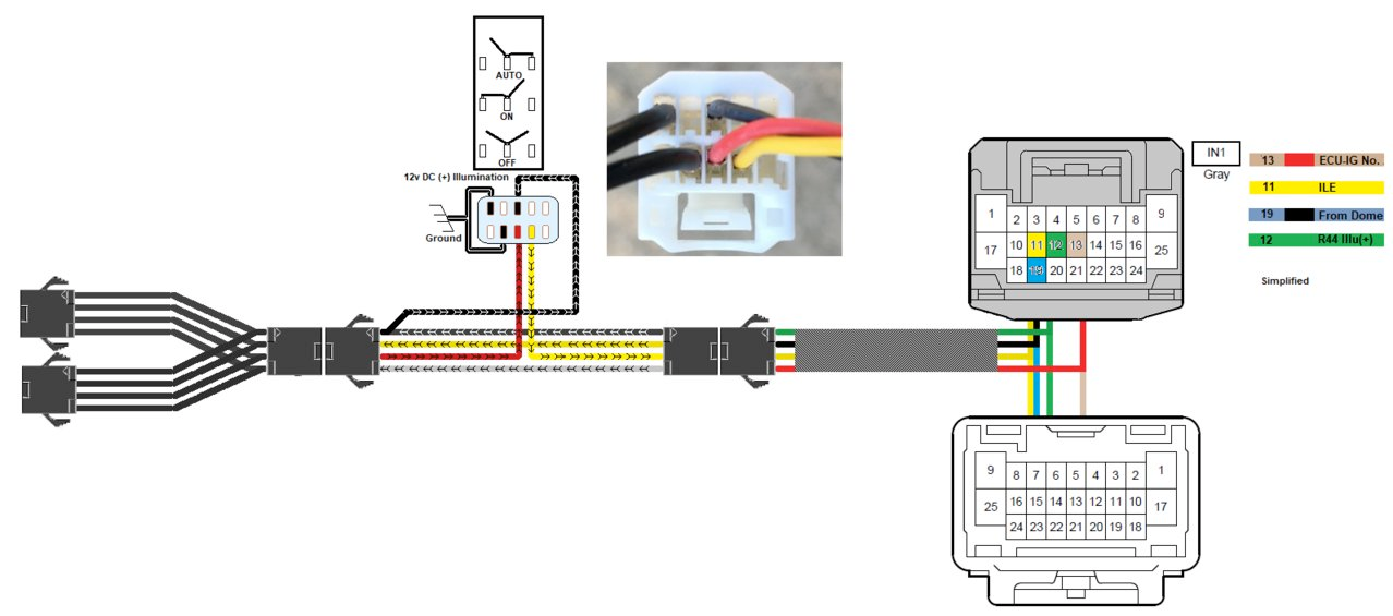

I know that Meso Customs has made some for his puddle light harness:
Longer question:
I just bought the Diode Dynamics SSC2 LED Pods and they have two functions (Standard light & backlight) and their harness comes with this switch:
timthumb.php
I was hoping to replace that with a nice in dash factory looking option, if that's not possible, drilling out a factory blank to put the above switch in might work but it's nearly the same width as the blank...
Open to any ideas or mounting options...

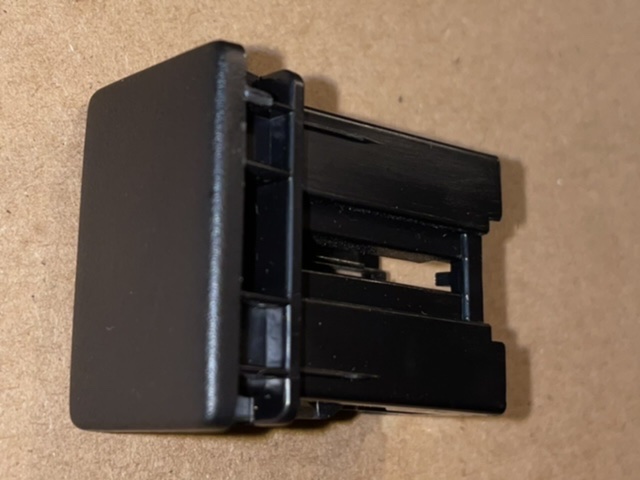

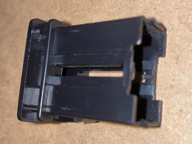

I looked all over for the same kind of switch that you’re looking for and could not find one. What I wound up doing was buying the Meso switch. I’d encourage you to do that also, and soon, since most of his items sell out quickly. Get either the 4Runner switch/harness or the Tacoma variation, it’s the same switch. It’s expensive but was worth it to me.
Your other option is to modify a 4Runner switch blank. Except it’s kind of an ugly job. The backside of the switch has all sorts of extra plastic you have to cut away and it’s kind of a mess.

my only question is his switch has 10 pins and mine has 3...
wiring n00b, not sure where those 3 connections should be made.

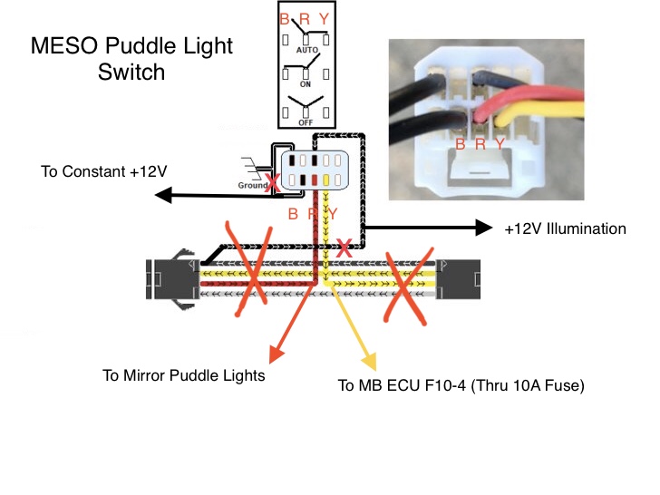

Here’s how I used the switch connections for my application. I wired up an anytime control of the puddle lights earlier this year using the Tacoma harness/switch before Meso came out with his wiring harness for the 4Runner.
Check the pins with a multimeter set to ohms to be sure of the switch operation for your setup.

Boom! Exactly what I needed!
THANK YOU
