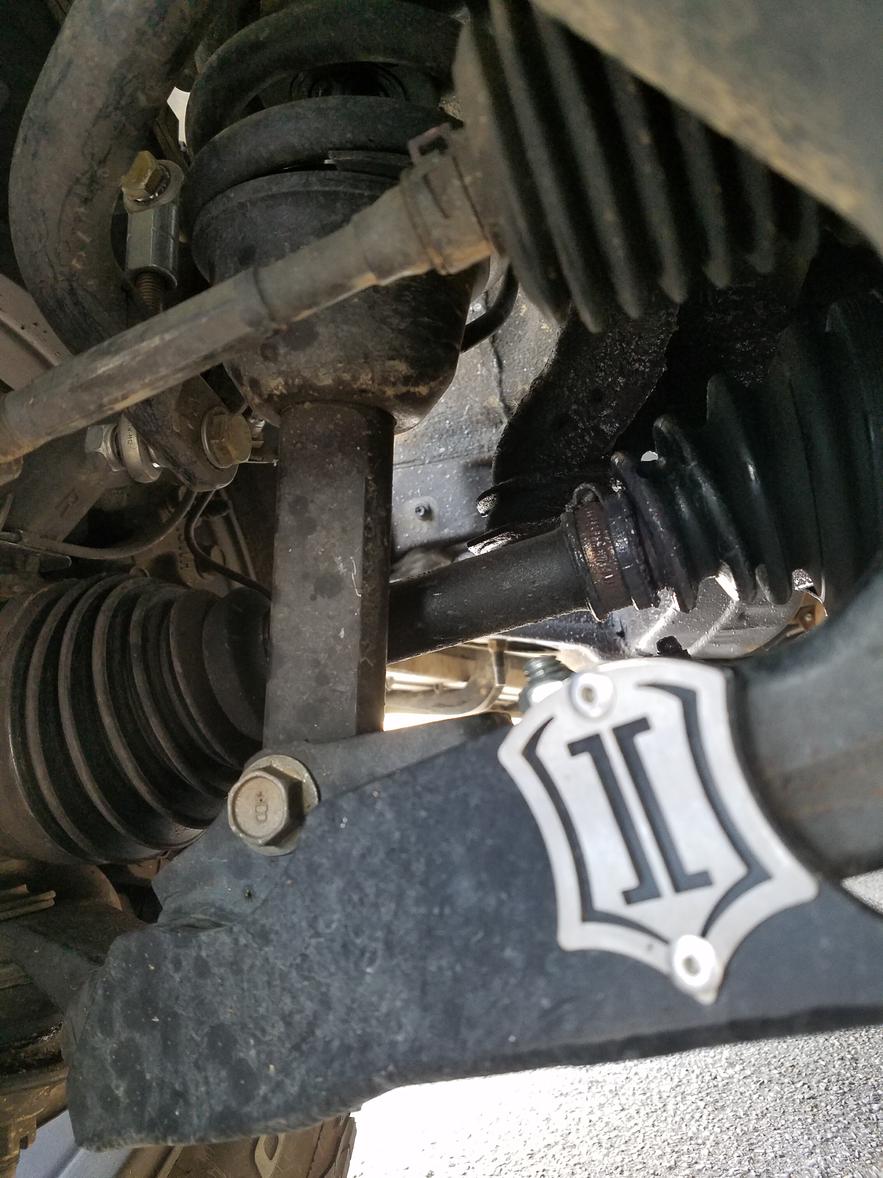

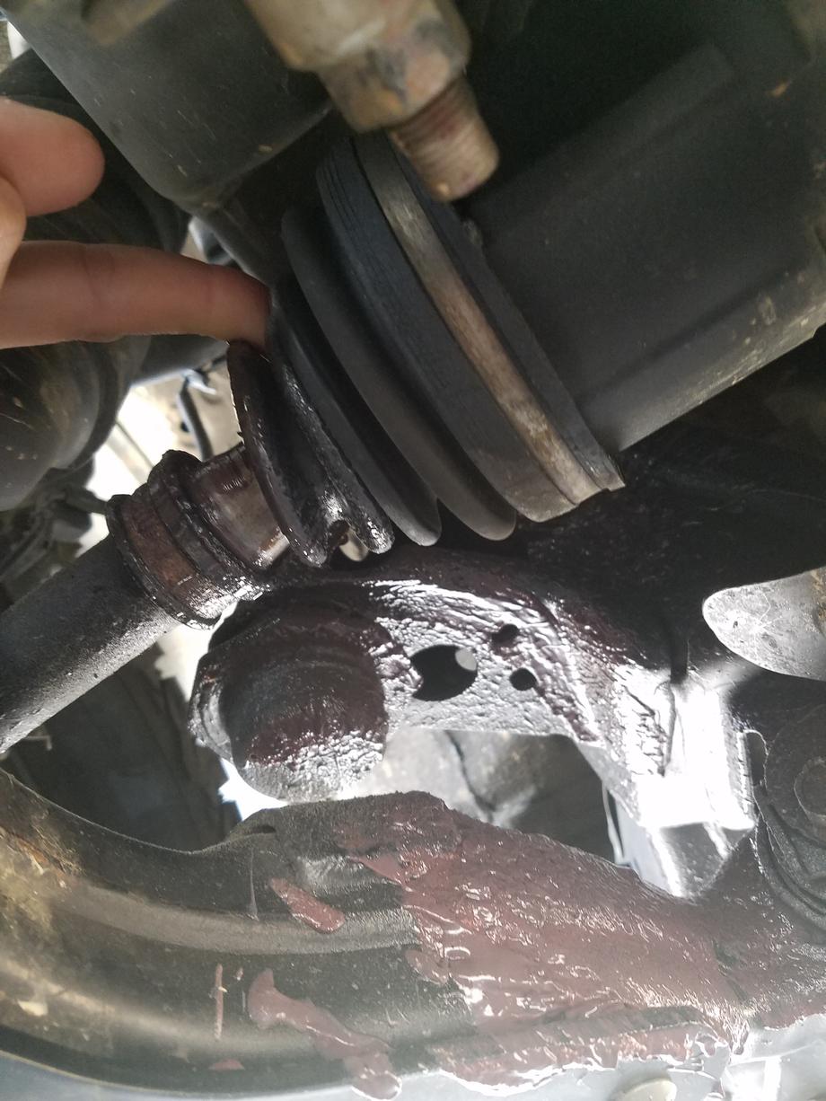

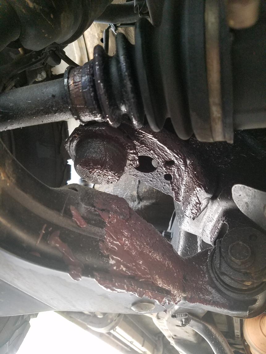

Here is what happen to me. Noticed a bunch of grease around my wheel Tuesday and started investigating. Yup found it when i pulled on the cv boot.
I have to do my wheel bearings as well, so this should be fun. Having my whole front end all over the garage all weekend.

I think what i am going to do is get all new parts. No rebuilds. That could be asking for trouble with a rebuild, but i am not expert. Others can weigh in on that.
