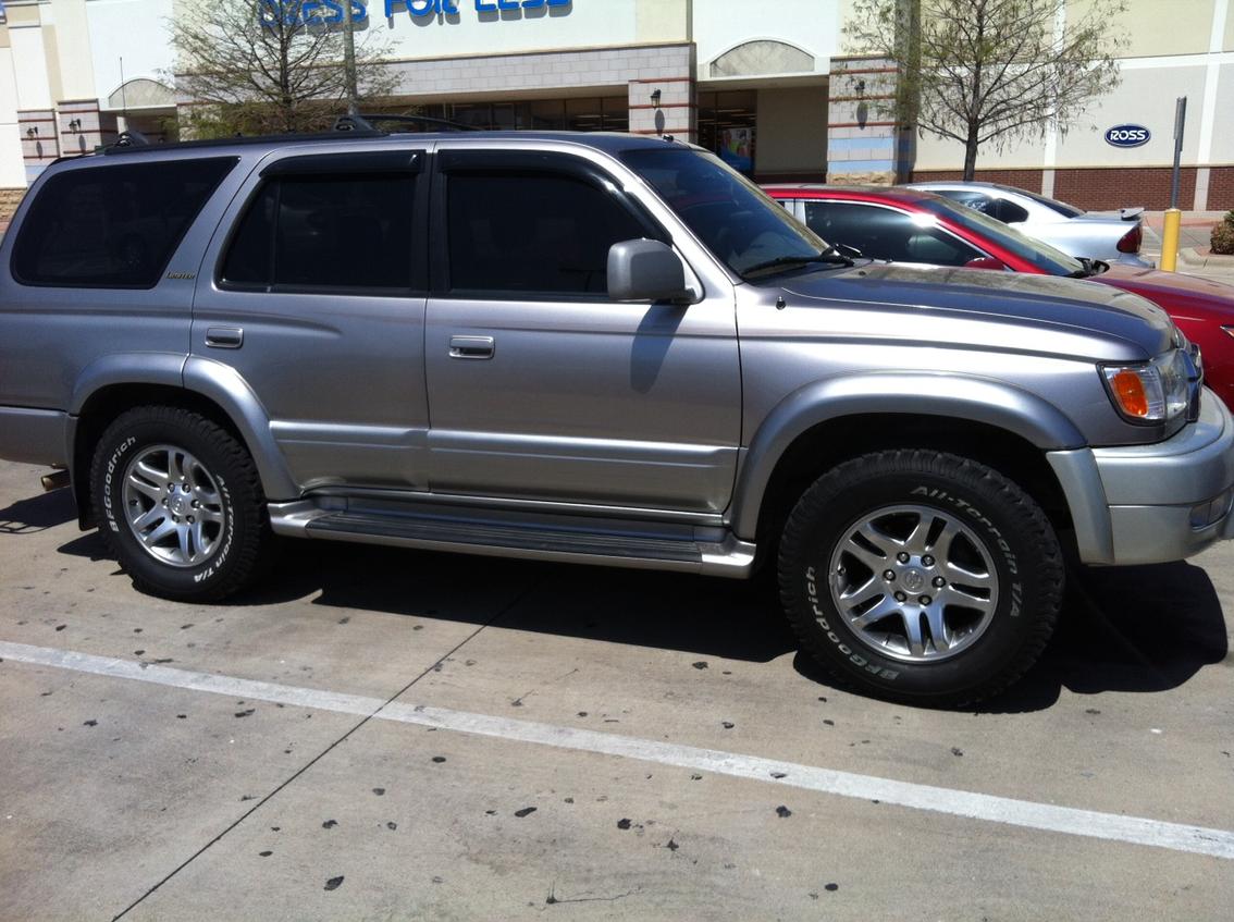

All I'm wanting to do is basically refurbish my stock suspension and I'm looking to do it fairly cheap, but without compromising mine or my T4R's safety! I don't mind spending some extra coin on quality parts...I've found that you usually make up for it in the long run anyways. I don't really need a lift, but I did add 265/70/17 BF Goodrich AT's and now there is slight rubbing in the front whenever I slightly flex my suspension turning into my parking garage, or hitting odd angle slopes. I am suffering from the customary rear sag in the rear. The fact that I carry a cargo rack with a 100 lb. tool box on it almost every where I go doesn't help out with it either. That being said, the '99 coils seem to be the way to go. No added stress on my CV joints or LBJ's...which I will be changing along with everything else anyways. I'm currently at 152,617 miles on my '02 T4R Limited 4x4 but was told the LBJ's were replaced at 55,000 according to the dealer. I've owned it since 60,000/5 years this coming weekend. The steering is tight as can be with no leaks to speak of. As for parts...I stumbled across this place selling a completely new/full, what appear to be OEM Toyota suspension package for my truck for around a grand. Coils, shocks, struts, hardware...the works! Just wondering if anyone had any experience with this particular package, or if anyone had any ideas of where else to look, or even if I had to...save money by piecing it all together.

Here's a pic of my current suspension. She needs a pick-me-up!!!
