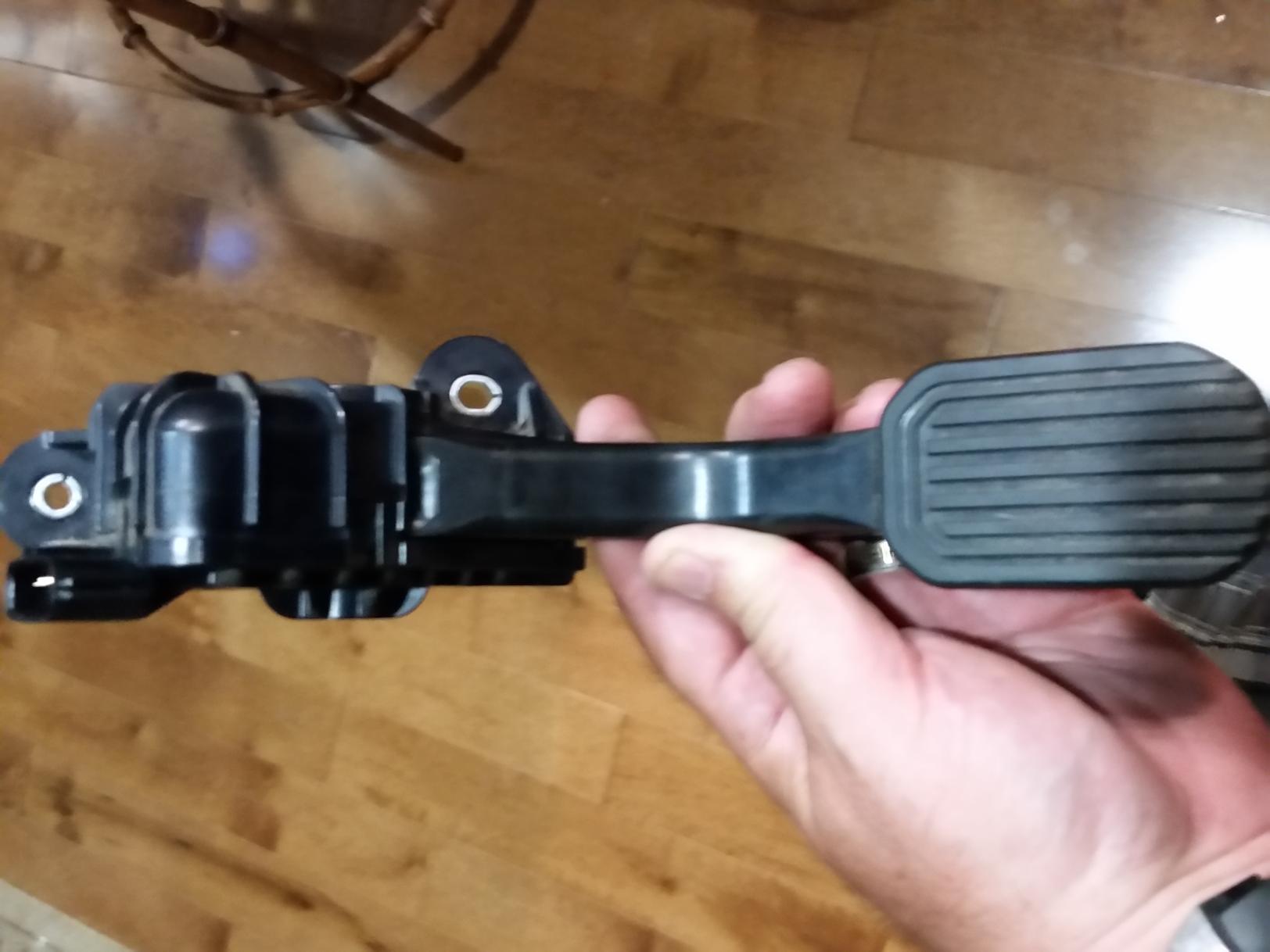

Pulled a code from by OBD scan tool today that says my throttle pedal sensor is acting up. Its an easy fix. The symptoms are basically, no acceleration. The engine is running and in gear but you can mash the gas but nothing happens. Replacing the "gas pedal" this week with a used one, quick fix. Will update when its complete. Has anyone else had to do this??

How many miles do you have on the clock? You're the first one I've heard of having this issue - in the past few years, at least.
I've always wondered how long it would be before one went bad (and we heard about it here). What did the used one cost you? Did you price a new one?
Are you gonna worry about doing the trim job on the pedal, or has that one had it (from the recall)?
I have 205K on the ole gal and I bought a used one for $50 off ebay. I think the new ones were about $125 at various places and upwards to $175. I just made sure that the part number off my OEM matched the one online and it did. Plug and play, took two starts and it was up and running. The check engine light and the traction control lights went out about 15 minutes after running the engine through its paces in traffic etc. I read several places in the forum that you could do all sorts of things to get the lights to turn off, but I just ran it and it took care of itself. I plugged in my OBD scanner just to make sure and it wasn't thowing any new codes or the TPS code either. Got lucky on this one!:tongue:
Its been a week + and the V-8 is running like a champ again, easy fix and finding a used TPS on ebay saved the day.
So....I am driving down the road here in Virginia traffic and my TPS started acting up again. I quickly pulled over because if you ever have this happen to you, you will not have ANY throttle response! I shut the engine off, restarted it 2x and still have a check engine light and VSC light on the dash. Got home, used my OBD II tool and it pulled the same code, TPS Sensor. So, I will disconnect the battery to see if that works but am at a loss as to what may have happened. It could be a bad "used" TPS that I bought but I doubt it. Any one else gone through this ordeal??
