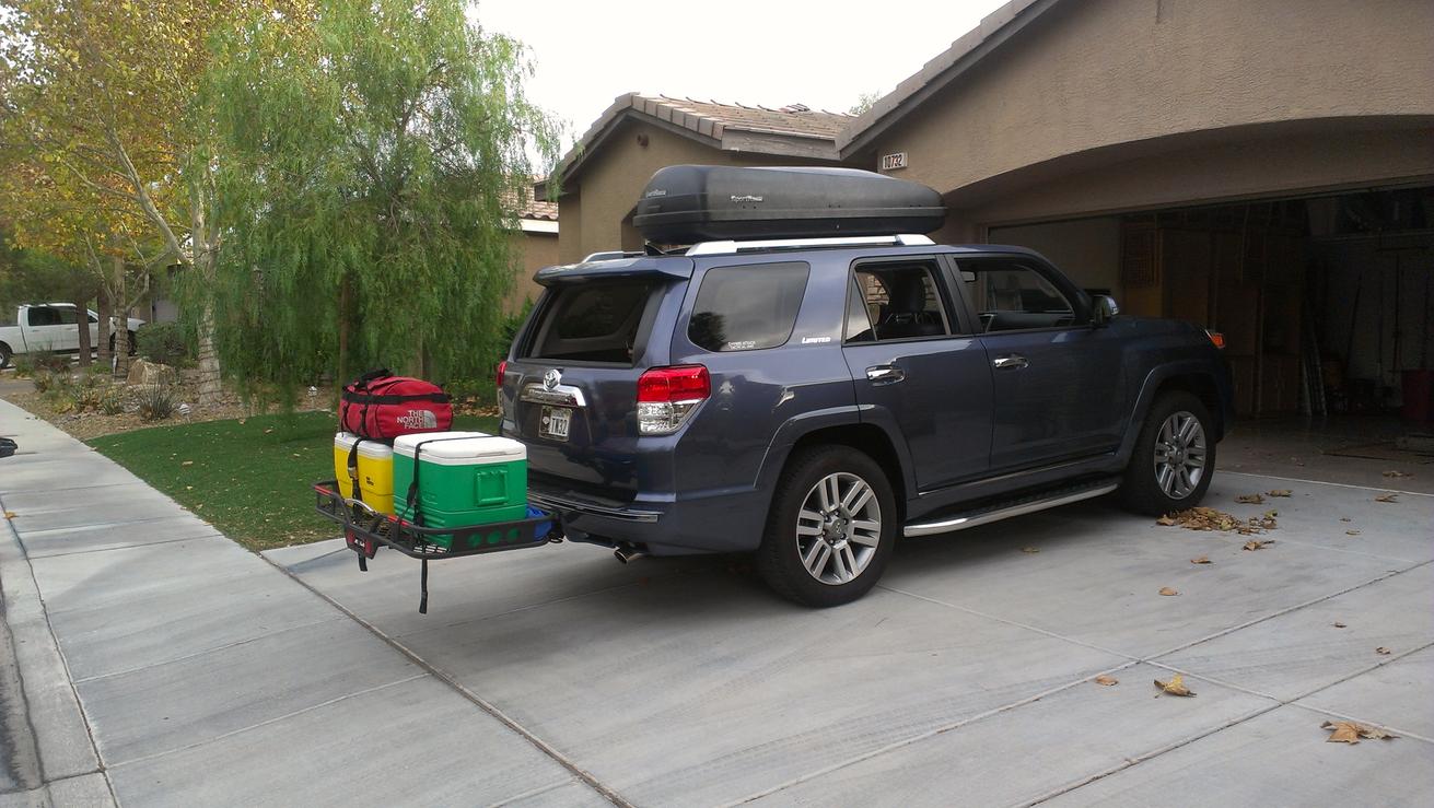

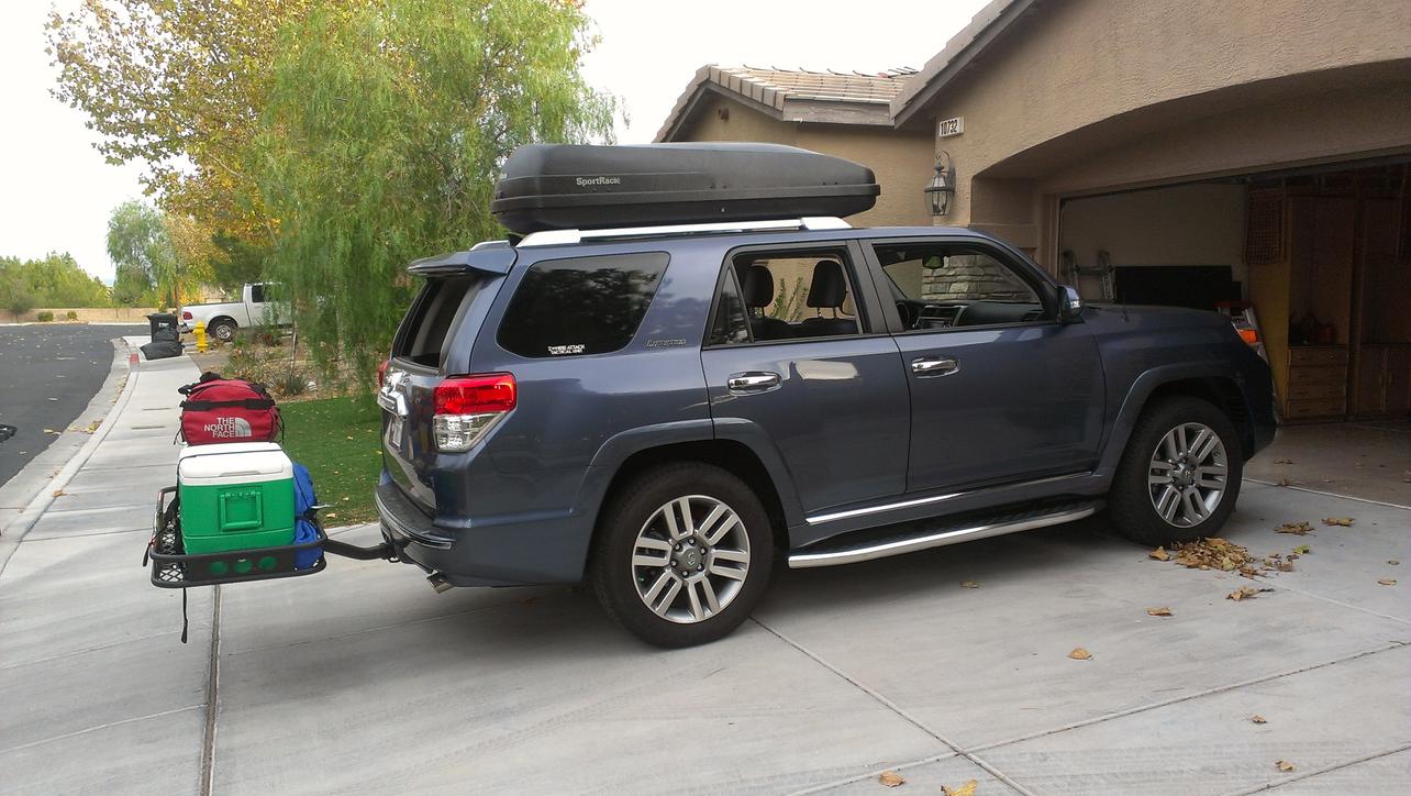

I bought my Sportrack (Made by Thule) off Amazon for $200 and have used it several times with no problem, mounting it was easy but does require two people and it holds a ton of stuff, it's also quiet and after driving two hours at highway speed through a thunder storm I'm pleased to say it's waterproof too.

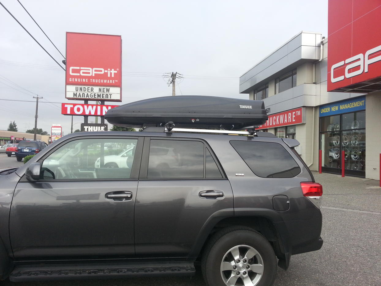

I have test fitted the Thule Force XL and it fits fine. Just need to adjust the spread of the bars (I need to move the back bar forward a few inches, which I did not do in the pic). And yes, it does not get in the way of the liftgate, nor does it overhang on the windshield.
LightRanger: FYI, this Force XL is the exact same length as the Atlantis 1800xt (84 inches).

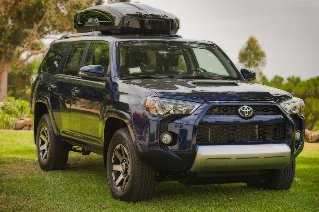

I bought the Thule Motion XT XL Roof Box at REI for my 5th Gen 4R a couple weeks ago. I mounted it on the OEM cross bars and it fits very well -- clears the open rear hatch and the satellite antenna. I used it to haul luggage and gear on a trip last weekend and it worked great.

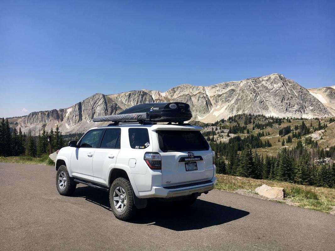

I added my old Thule bars and box to my 4 Runner with no issues and any speed. I was in Wyoming over the weekend at speeds 80+ with no noise or vibration issues.
