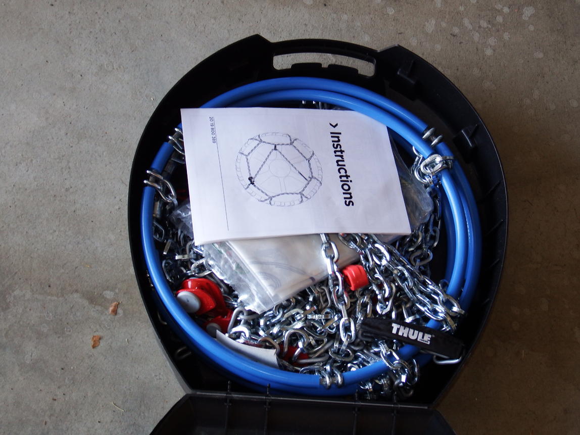

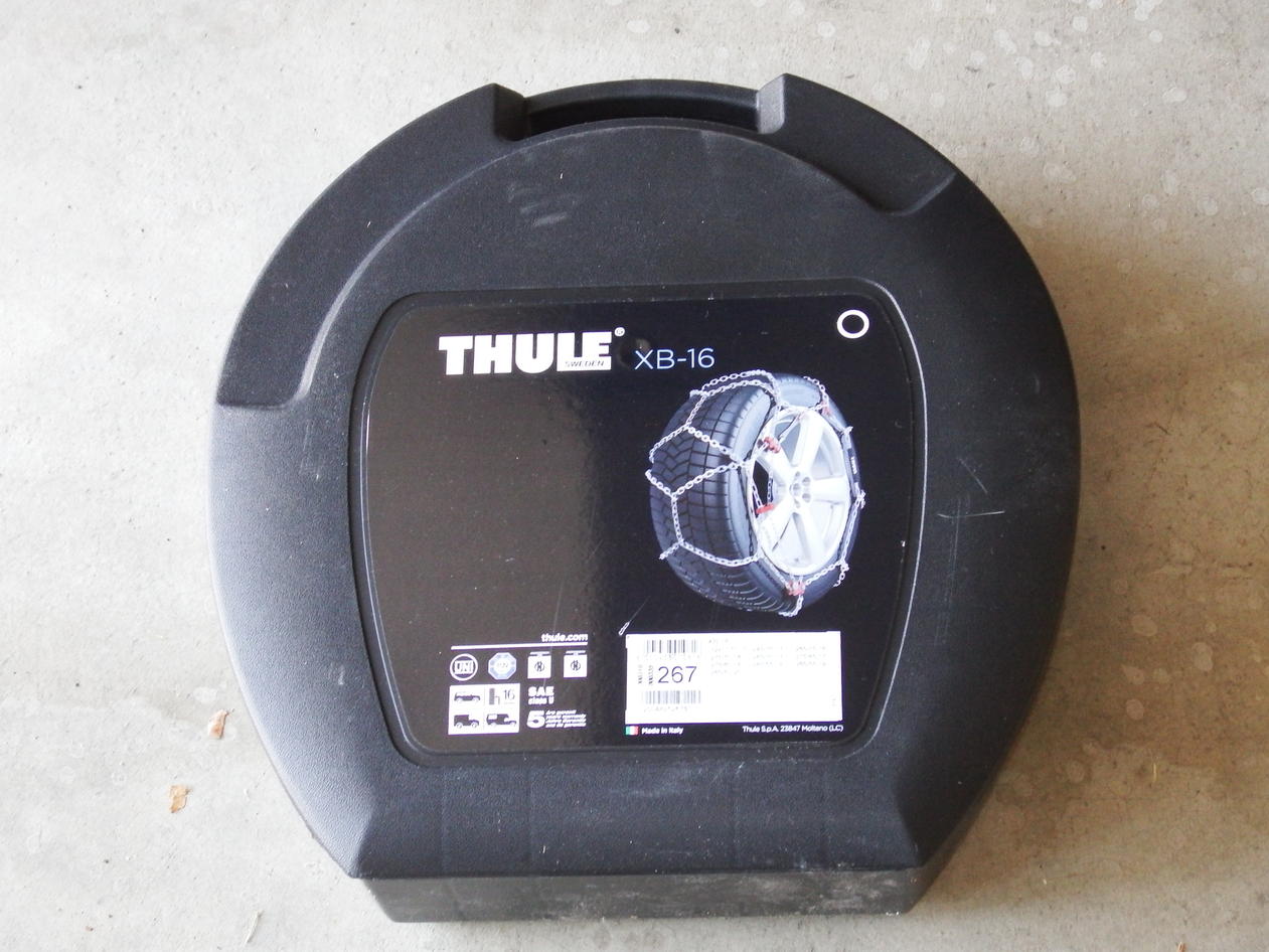

These chains come as a pair, pretty nicely packaged in a case. It includes a couple of repair links, a laydown mat (good idea - I may want supplement that) and the instructions. There are also instructions on the back of the container. The links look sturdy. The -16 designates the long dimension of the link 16mm I believe.

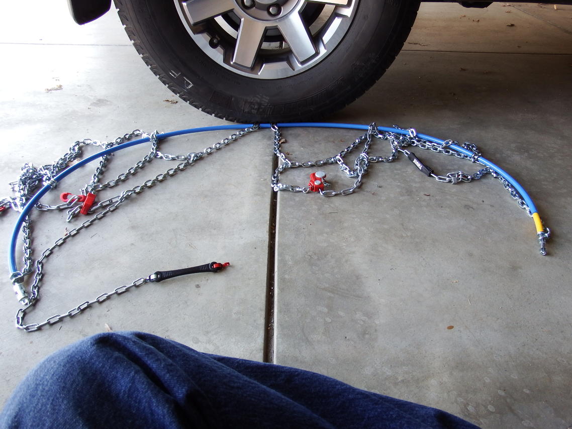

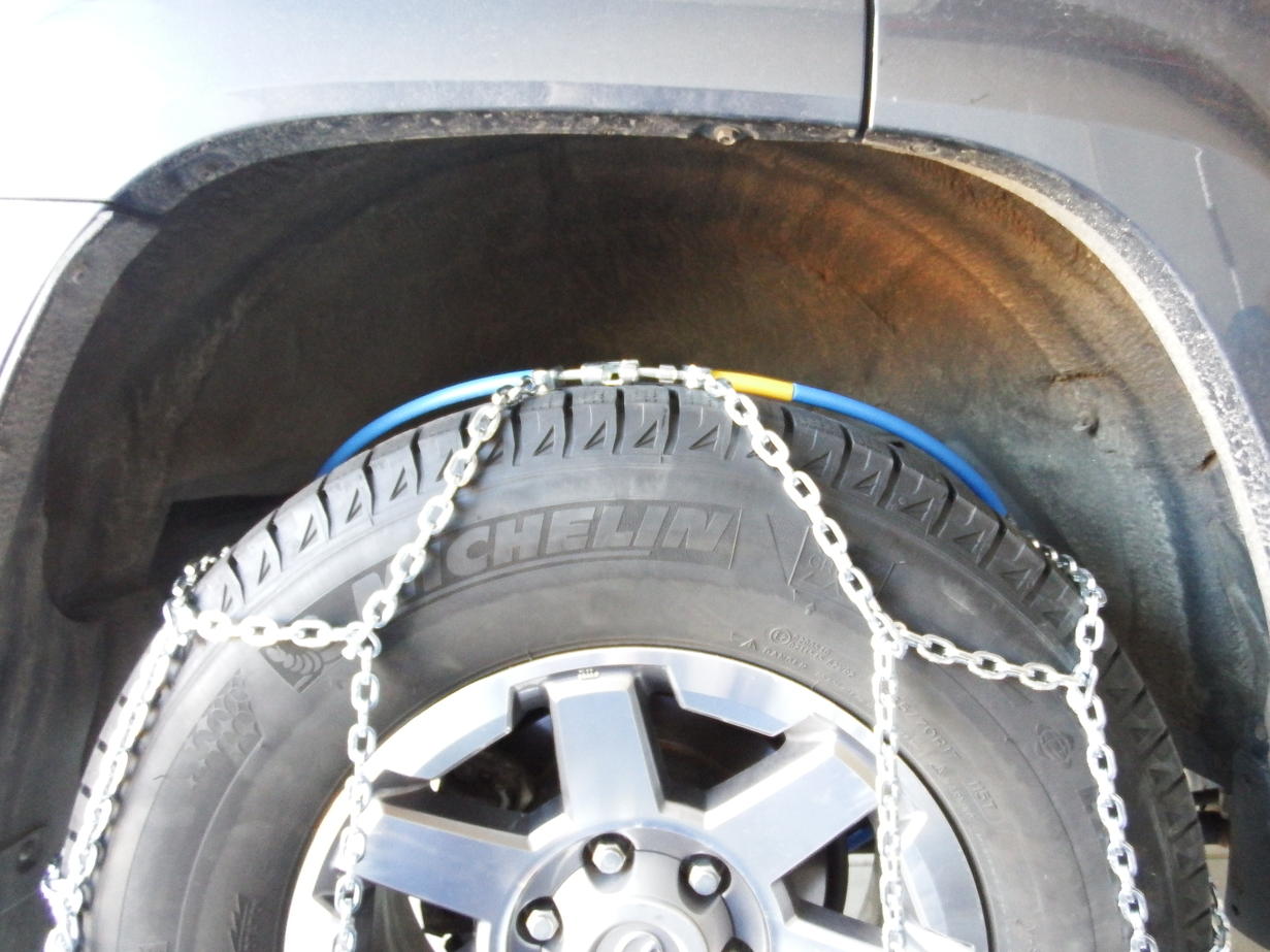

I realized later that this picture is a little misleading for assembly. This is the way the chain goes BEHIND tire. To get it around the tire you shove the yellow end around behind the tire and bring it up to latch at the top.

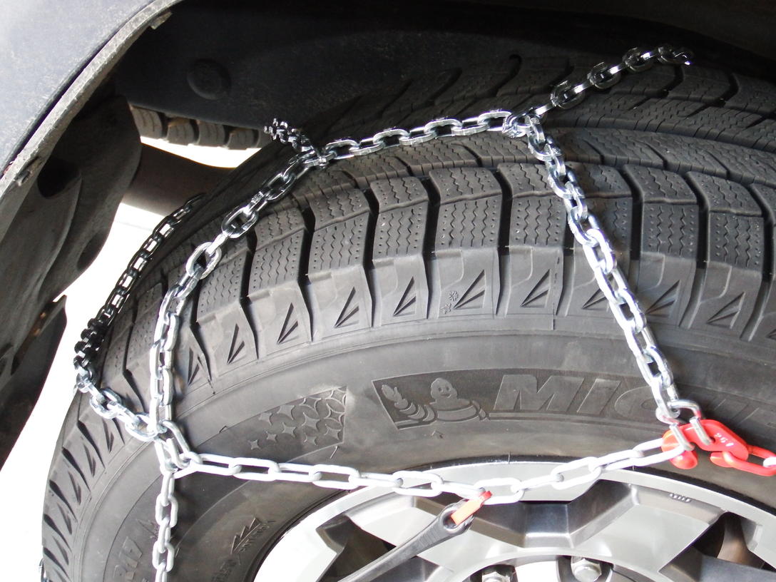

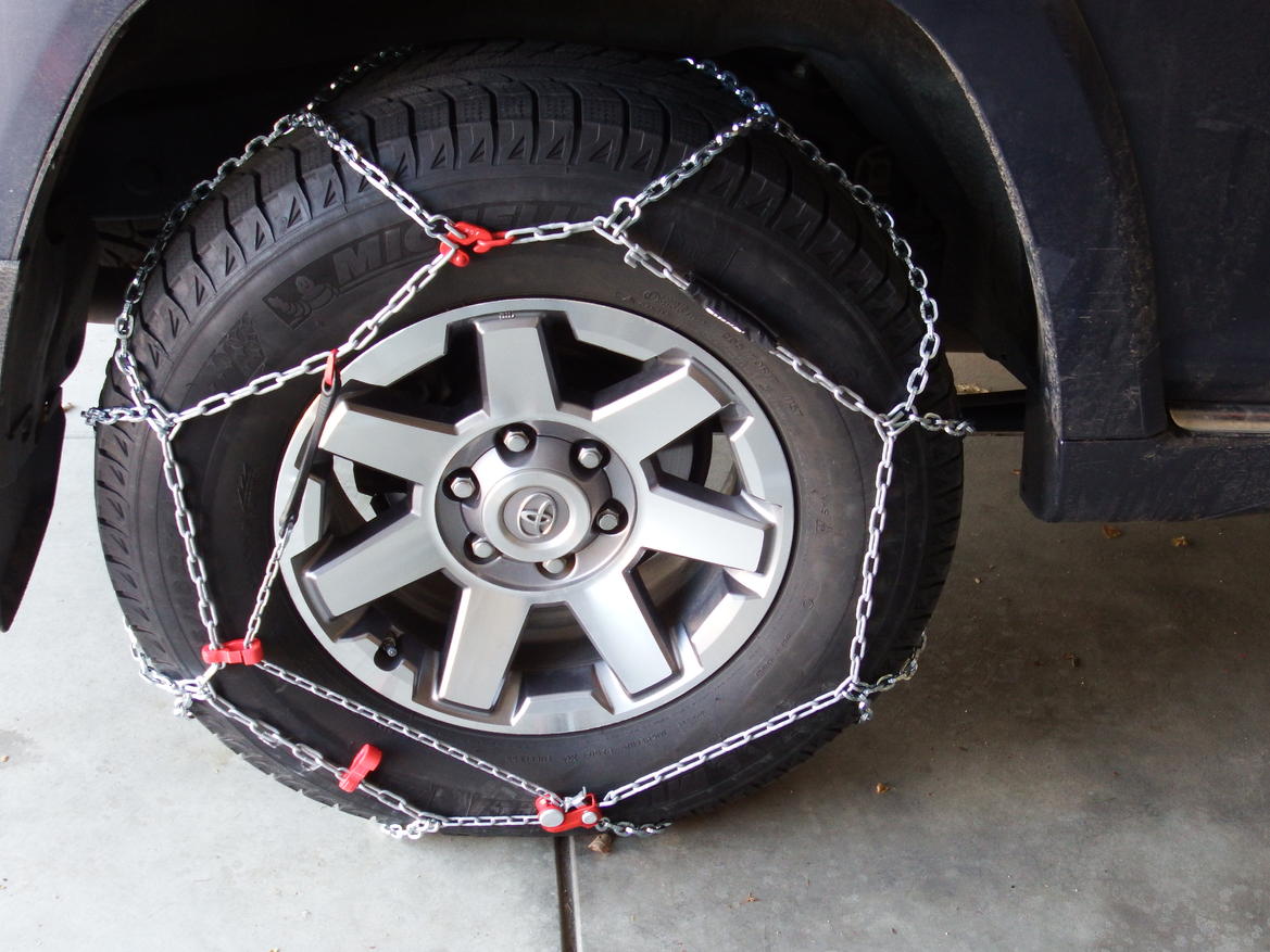

For reference the tires are Michelin Xice 265/70R17. The fit was a little tight, the assembly pictures show the tighten portion going back across the tire. However the procedure tells you to drive 100m and then tighten again, so maybe there would be more slack. I'm confident that it would be fully functional with the tight fit.
