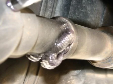

It took about 80 shots of grease from the gun until some began to squeeze out of the joint. I cleaned off the joint with some WD-40 first, and as I added grease, bubbles were visible around the seal as air was pushed out. I put about 30 more shots into it until the old, dirty grease was pushed out and the new grease was visible. With each shot of grease, the shaft extended slightly and as the pressure escaped, it contracted slightly. Once the clean stuff started to flow, it got easier to put more in. The old grease was very thick and dirty - likely why the slip joint was binding.

My driveshaft looked like this, except much more grease escaping:
