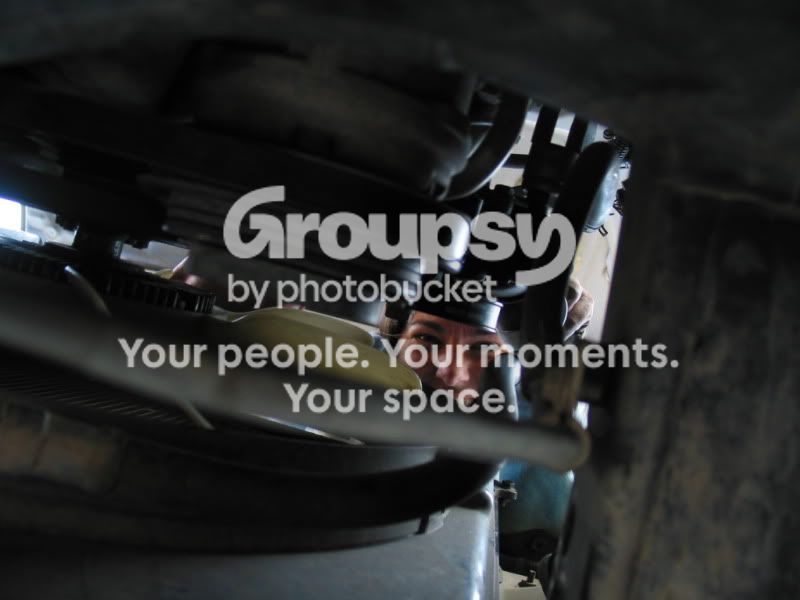

Can you point out the compressor for me? I`m looking to turn this thing right?
98 4 runner AC compressor - Google Search
Passenger side of engine, under power steering pump like mark3406e said. Seen more easily from underneath, like so, the more prominent thing in the pic with a belt.
248-4834_IMG.jpg~original
Sorry about the mug, I was finishing up my timing belt job and my hubby snuck under the truck to take a pic.
