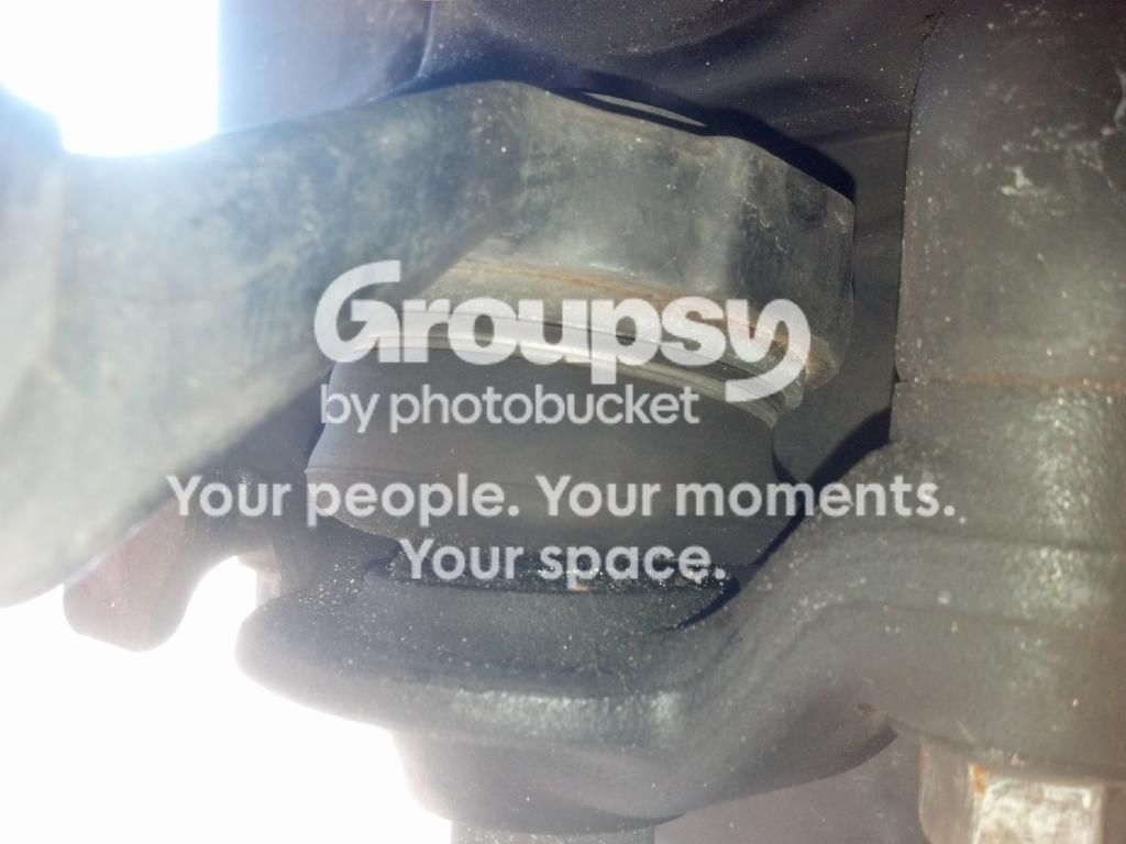

Did my oil change and tire rotation to day. Finally the rain stopped and the frigid weather.... anyhoo, did a once over of all the steering and suspension links and found what looks like the beginnings of leaky boots. Mileage is 116k, tie rod ends are original. What do you think?

Pass. side:
IMG_20150116_103656_005_zpszlizzugu.jpg~original

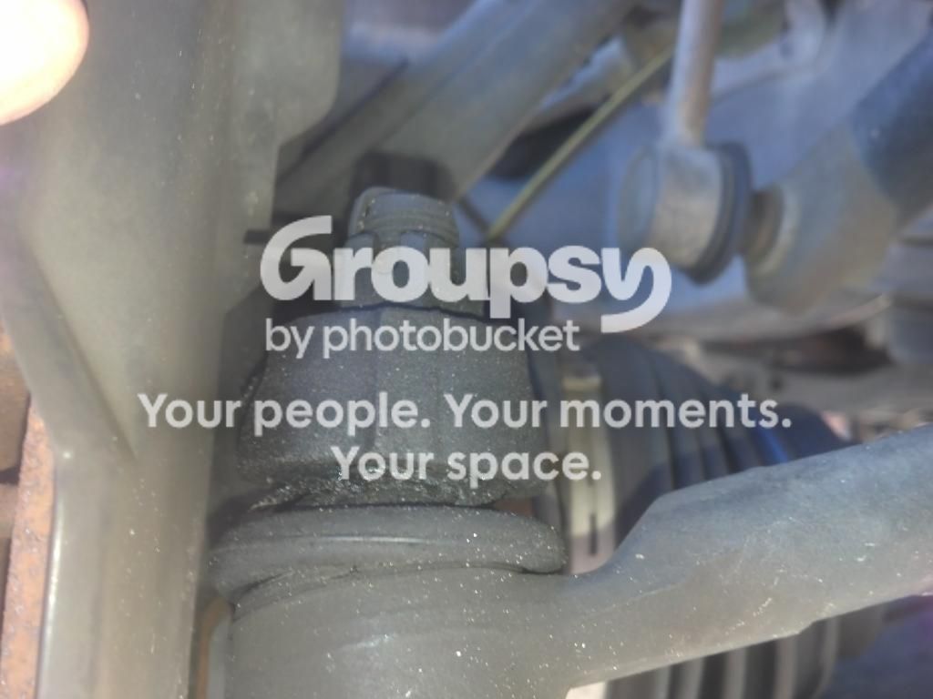

Driver's side:
IMG_20150116_103738_140_zps8gpfiejk.jpg~original

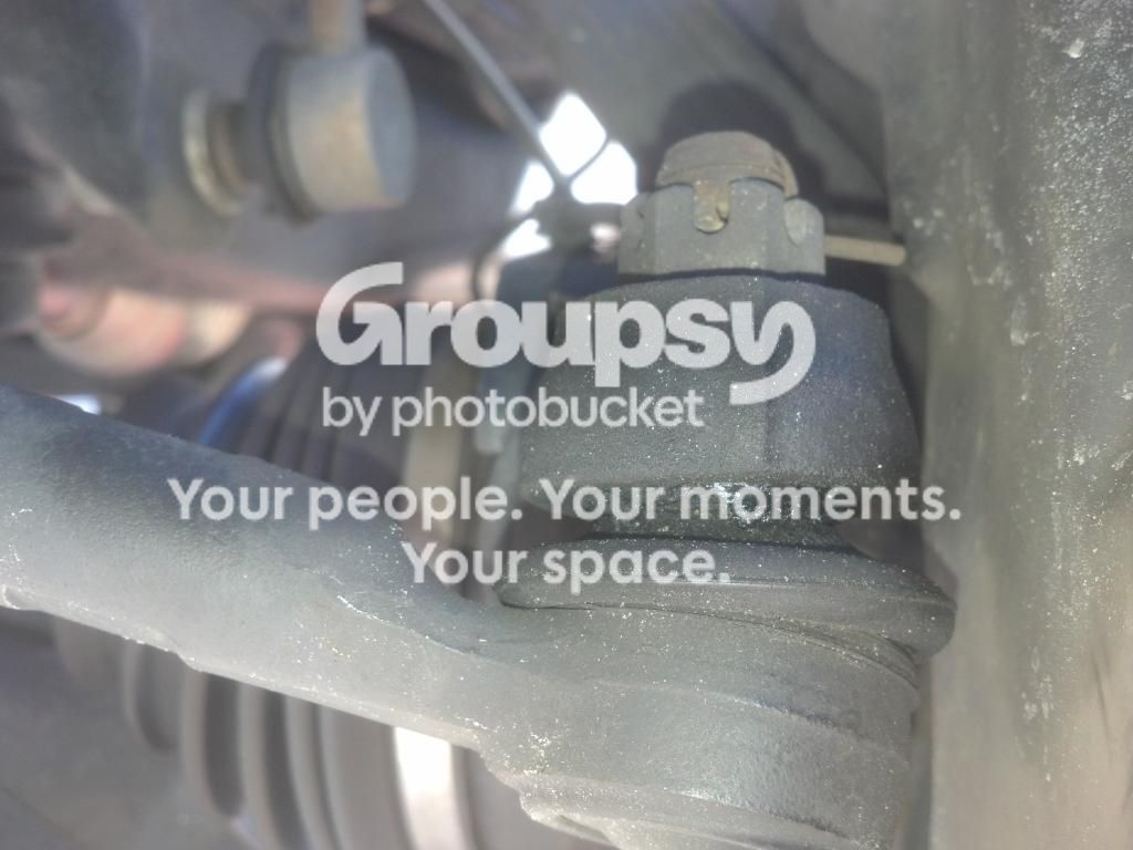

And here is what the pass. side LBJ boot looks like, similar "goop" in the crease:
IMG_20150116_103832_071_zps6nfdxpn1.jpg~original

That doesn't look too bad at all, won't hurt anything to go ahead change them out if you want. But to be honest that looks like normal seepage/grease being pushed out. Now if there was about 3x more grease and cracked/deflated looking boots I'd be worried; hell most of that grease still has that nice greenish-grey gloop color. :)

You know, I wondered about if there was an acceptable amount of seepage. I can't move them by hand, but I don't know the best way to tell if they have too much play. Well, I've read in the FSM about removing the outer ends and rotating them 5 times and measuring the torque angle, or something like that... but if I'm going to remove them I'd replace them. If the boots aren't cracked, can they be refilled/topped up with grease? Is it even worth doing that? Oh and the boots feel plenty squishy which I took to indicate they still had the majority of their grease still living happily inside...
For now I guess I'll just keep an eye on them and see how it progresses.
