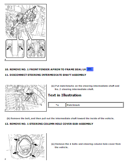

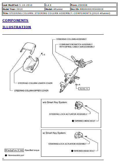

If you look through the repair manual, it looks like the tilt mechanism comes as a unit, built in one piece with the top end steering column. (Steering column comes in multiple sections).
The manual gives instructions of how to remove/reinstall the whole steering column. Through all those instructions/adjustments etc, it never mentions the tilt wheel mechanism by itself. To that end, I am going to guess, no adjustment. It is what it is. Now, unless one tears out the lower dash board, Knee air bag, (and lord know what else) then examines that whole steering mechanism, as show below, to see if any modifications can be done, not sure your going to get an answer.....sorry bud. Be safe.
