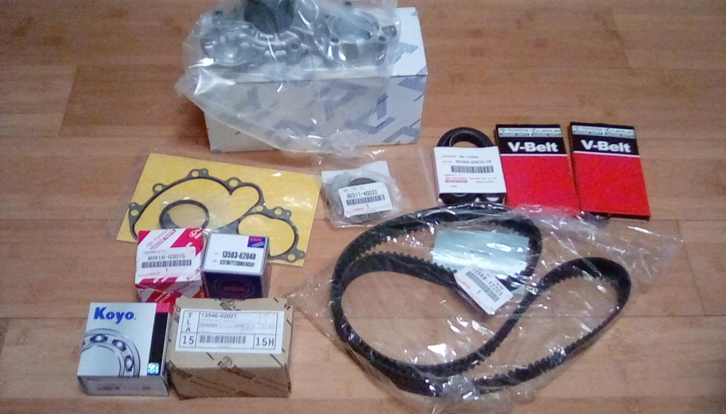

Looking at an Aircabman package on ebay
Obviously not everything is Toyota-branded for less than $300 shipped...
octanejunkie-albums-misc-crap-album-picture61431t-aircabinman-timing-belt-kit-contents.png
Includes The Following Brand New Parts:

Everybody cool with that?
I can upgrade to a kit with all Toyota belts (last 3) for $10 more

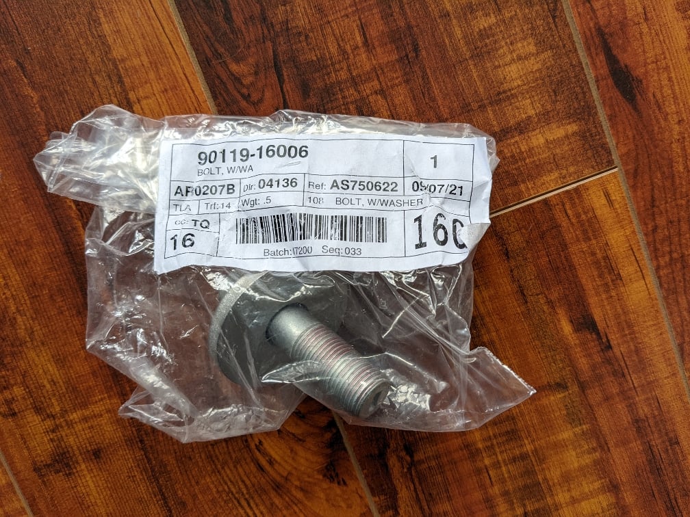

Also, based on the video by [MENTION=120071]mtbtim[/MENTION] and [MENTION=102606]infamousRNR[/MENTION] I picked up a crankshaft dampener bolt/washer
(90119-16006) from my local toyo parts counter for $7.65

eBay.....hmmmm. Def make sure they are trusted and well reviewed. I'm gonna go top shelf when it's time, and at 250k it's just about time!
Edit - nevermind, didn't see the seller's name. my friend did Aircabman and was satisfied the weren't fake.
Use the bump-start method to get the crank pulley off instantly. Just make sure your 1/2 in. breaker bar is strong enough and use a 6-point socket. Got mine off in seconds by just bumping the ignition quickly. I personally didn't replace any seals as they weren't leaking on mine with 230k miles.
I bought 3 of the aircabin kits. They are not fake kits. :)
Sent from my SM-A505U using Tapatalk
I've used the aircabinman kit on my 4Runner twice. Once at ~180k miles and then again around ~270k miles. No issues at all. It's all high quality parts. I went with the kit that had the Toyota belts and everything, the most expensive kit he offered.

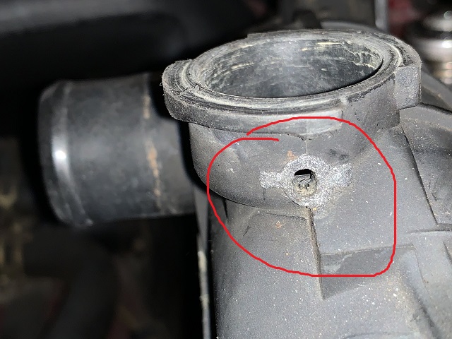

[MENTION=95183]octanejunkie[/MENTION] Make sure you check the overflow pipe on the radiator real good before installing. Ask me how I know :mad:
You mean the hose that goes to the overflow/expansion tank in front of the battery?
Sent from my Pixel 4 XL using Tapatalk
Was talking about the nipple that comes off the radiator to the overflow hose.
I ordered the Toyota radiator from Camelback and was so focused on making sure the tanks were on properly that I didn't notice the overflow nipple was broken off until I had it installed and went to attach the over flow hose(very lat step). I ended up finding it stuck in a piece of styrofoam in the box. Have a friend who had one shipped too and the nipple was broken and just held on by a thin piece of plastic and had to return the radiator, too.
