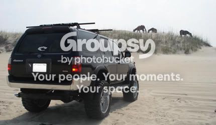

Case in point... this guy posted on a VA thread a bit back and his truck looks AWESOME!!!
