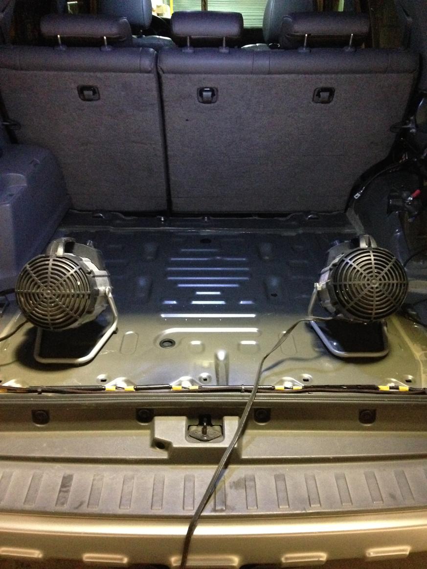

I'm actually in the middle of the project myself. Have the entire interior apart, dynamat down, working on installing the Kenwood subwoofer now (have to make a trim ring in order to reuse the existing threaded screw holes in the existing subwoofer enclosure.

Second is running the wiring for the sub, amp, and speakers. This is the most involved aspect of the project IMO. Start with the Sub. You can reuse the existing grommet for the factory wires and run your new wiring through that. Quick note, push the grommet into the subwoofer enclosure instead of trying to pull out. Its much larger on the inside than the outside. The speaker wiring I haven't done yet but its basically removing the door panels and running the new wire. While the door panels are removed you can install your new speakers, sound dampen the door skins while your at it. The benefit of running all new wire is that you do not need to touch the existing. Just remove the speaker, leave all the wiring in place and run the new wire through the door loom to your new speaker. Take your time and use a wire coat hanger. start at your speaker which will furthest from your amp and work back to the speaker that is closest.
Decide on where you want to place your amp and run all the speaker wiring to there. Run your amp power wire down the passenger side wiring chase located under the door sills. You can also run it down the drivers side door but punching through the rubber grommet is more difficult on the drivers side than the passenger side. The rubber grommet is really a work of art. Snip the small nipple portion of it off. Then insert a screwdriver and pry back at an angle. It will take some time but you'll get the inside part out (hard to explain but I'll upload pictures later). The outside grommet opening necks down inside the grommet so you need to snip the entire inside portion if you are going to use 4 gauge or larger wire. Think of it like a collapsible bowl (frontrunner flatpack kitchenware set) that you need to make inside out.
