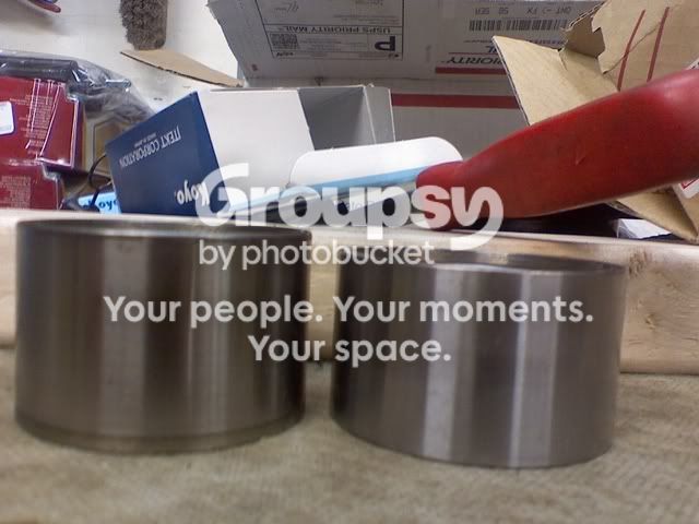

DO NOT GET THE KOYO IDLER PULLEY! unless you want to replace your belt in the next thousand miles.
I bought this kit a year ago and it came with the koyo, almost 1CM of belt overlap once installed
NSK on the left Koyo on the right-

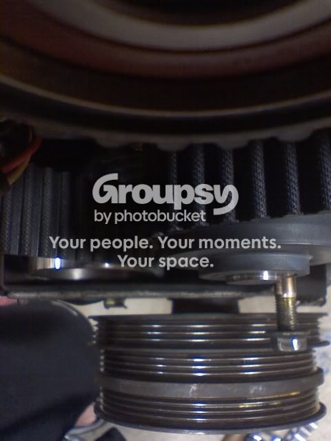

Here is the koyo roller installed
PULLEY5.jpg~original
As you can see theres a ton of belt not covered by the roller, this would lead to fraying or even breaking of the belt.
NSK or nothing, youve been warned!
