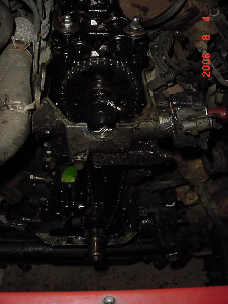

22 re timing chain
Well I pulled the timing chain cover off my 4runner because of an oil leak and I found a broken guide so I'm changing the timing setup. Here's some pics.
