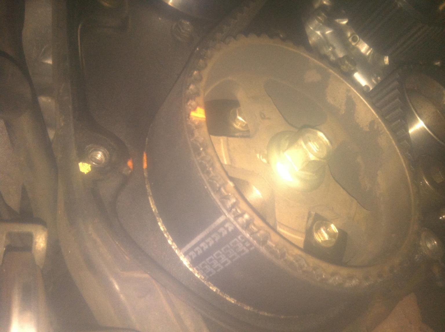

Investigating further I began pulling apart the front end to look behind the timing belt cover where all the noise was coming from. It seems that the timing belt is actually new. So seems is the water pump. The water intake, not so much. The engine when in "stroke compression" with all the notches of the left and right cam and major center pulley all lined up to zero and the distributer pointed to the #1 spark, the timing belt is five notches behind where it should be. My guess is a faulty hydraulic tensioner (in the fan bracket) which gave some slack and now there is five notches of slack somewhere in the line. I am at the point where the fan bracket just came off.
What to do? Do I need to take the whole belt off and just turn it five spaces or can I somehow reset the belt with its original placement and tension? I think a new tensioner is due, and think taking a look into the idler would smooth things out but first how to get this delayed belt in order?
I have attached a photo for reference of one of the cams.

It's the pulley orientation that's critical to avoiding catastrophic failure.
My experience is with BMW timing belts that don't have any markings on them other than a directional arrow. I would think you could align all your pulleys to the right marks, release belt tension and put it back on with the marks on the belt lined up. That being said, the recommendation from other manufacturers, BMW e30 M20 motor, is to replace the timing belt any time you relieve tension on it. Others with more specific experience will weigh in I hope. We have to do the same project shortly.
Forget what the belt says, are the cams and harmonic balancer lined up with each other?
If it did in fact slip, I think your on the correct path with a new tensioner. If the belt looked good, I would run it.
Its a non interference motor. So if the timings off, it will just run poor. Valves and pistons are safe.

As I turned the main bottom pulley (is this the harmonic balancer?) and the engine rotated, my L+R cam pulleys stayed in time with the zero marks, but the timing belt would end up one notch behind (to the left) from the previous rotation. Again: When pulleys are in TDC, then rotates once over, back to TDC the belt has skipped a notch each time. As if the belt was goin slower than the pulleys by a single notch each rotation somehow...
Is this negative or normal?
Is the timing belt one tooth too big/long?
Is the tensioner to blame?
Is this problematic, given that the cams and main pulley remain lined up in TDC?
I'm still looking for an explanation for hearing a rotating sound as if the (fairly new) timing belt had a fray tooth the last time I heard it running ....
I'm temped to just replace the fan bracket, tensioner, button it up and turn it on to see what happens. My friend thinks I should put a whole new kit on. Thoughts?
Any help and advice much appreciated by this amateur backyard mechanic who is currently riding his bike to work, haha!
Cams and crank don't turn at a 1:1 ratio. Check the diameter of the pulleys. Therefore your timing marks are there to make sure you are at TDC when you need to take things apart and put them back together and check the timing. If you turn the crank in the direction the motor runs and then back again and then forward to take up the timing belt tension, you should end up where you started. If you keep going around and around in the same direction, you will notice a different orientation and you will be able to amaze your friends with your knowledge of the four stroke cycle.
The marks on the timing belt are for installation ONLY. After installation, and the engine having been run, they are irrelevant.
