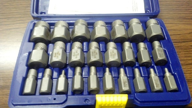

Well I've got my extraction kit in today. My Snapon kit is somewhere in the shop @ my grandparents and I don't feel like digging for it.
I've got myself mentally ready to tackle this saturday morning. I've already planned this to take up most of the day if not weekend. I'll post the results.
I know the cheap worm extractors will break. These shouldn't with the use of some heat etc. I've been soaking this thing with PB blaster every day since the incident.:painkiller:

Is the extractor going to be long enough to reach the broken bolt and get some good meat on it? The bolt hole in the crank may not be big enough to get a good size extractor inside to reach the broken bolt. The smaller extractors tend to break off easily. I agree with you on the heat. If they used red or blue loctite it's going to be tough. If you can, use a propane torch and get it hot enough to soften the loctite (if they used it) and VERY slowly try to back it out. If you break the extractor in there you'll be making some phone calls to get it lasered out. I don't envy you on this one.

Yes the extractor is just long enough to get in there.
If I don't think it's going to come out I'll just remove the extractor and just slowly move up in bits to where I can punch whats left out

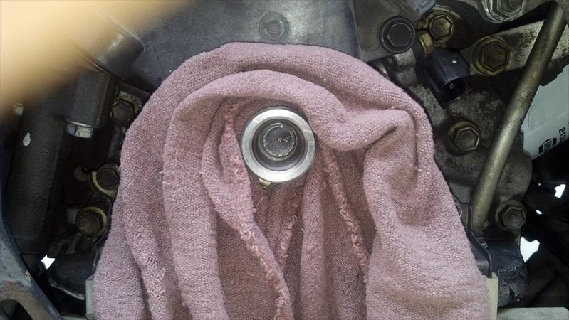

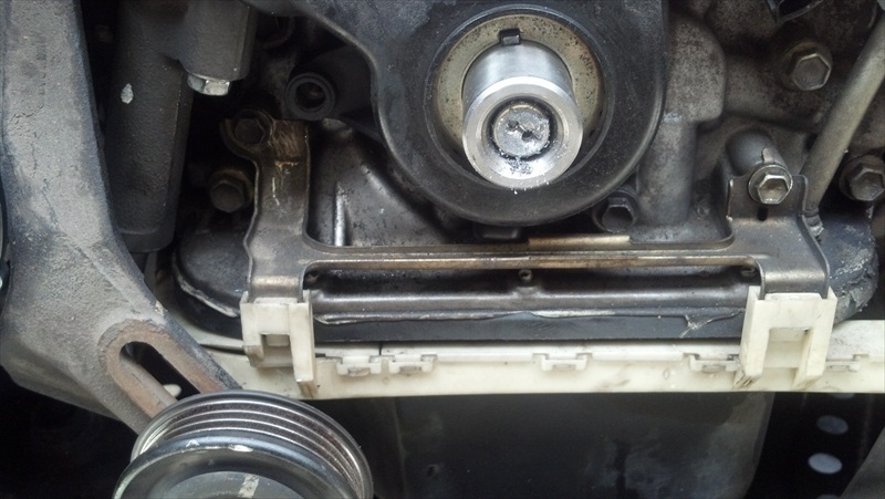

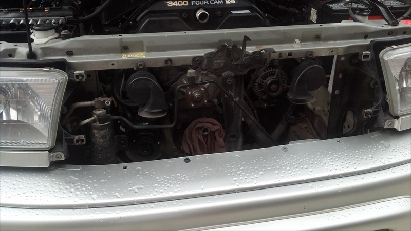

I started out by removing the condenser so I would have plenty of room to work and see what I was doing.

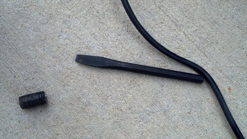

Once this was done I used my punch so I could start a pilot hole. Once punched I took my drill bilt to it as planned I wanted to start out small and work my way up but as I started barely using any force with the drill I saw the bolt turning.
So I decided to punch another hole close by to drill another pilot hole. Once this was done I decided to pull out the flat punch to notch between the 2 holes to use my flat head screw driver to unscrew the remainder of the bolt.
It was so easy that I just used the flat head punch to take it out by hand. Once out I noticed the threads full of PB blaster!! So I took some air to the hole and some brake parts cleaner and installed the new bolt and balancer!
Took less than 20 minutes. Finished the timing belt job then installed my generic trans cooler!
Was a lucky morning indeed!:trophy:
