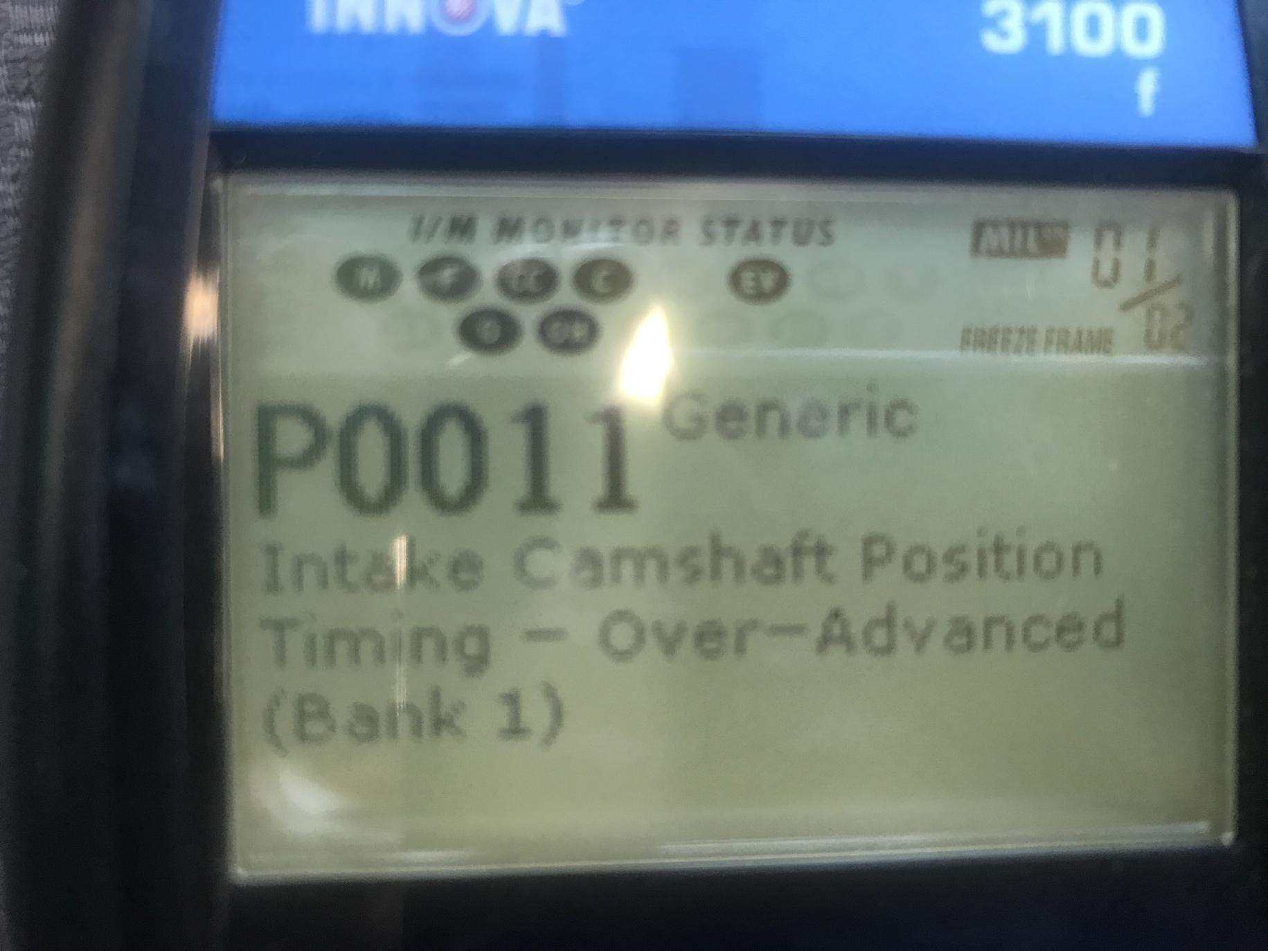

My T4R survived Hurricane Irma barely. As soon as I got back to FL my car started acting weird. Check engine light with VSC off and such. I went to the mechanic to take a look at it, on the way there the car stalled. the engine light was no longer there and they figured it was throttle body and cleaned it out. Next day I had a similar issue the car was idling rough but no extra sounds. I whipped out my OBD2 and collected to codes myself. Found P011 and P0016. VSC wasnt on but the ABS light was blinking. Mechanic said it's the chain and has to be replaced and it would be over $1500 job. We figured the sensors got messed up from the water/moisture, tons of cars in FL are having weird car trouble, moisture messed up the sensors which then possibly messed up the chain.
I am probably going to take it to toyota dealership tom to do a diagnostic again and distinguish between the chain and sensors. Someone suggested to check the tensioner plunger, if it is pushed then the chain is stressed, if not then sensors need to be changed.
The car has high mileage but never even idled off until right after the hurricane. One person said I should just get a used engine and out it into my truck..to be honest I rather fix my engine and take the hit but I hope its not that steep in price. This job is way out of my expertise.

Hard for the chains to jump time unless the guides broke...and you'd hear a whole lot of clanking if that were the case.
How's the oil look?
Those codes generally mean the VVT isn't getting the expected results...sticky actuator or clogged screens in the oil pressure circuit.
I'd start with an oil change...if there is sludge in the actuators, that sometimes loosens things up.
With a real scan tool, you can actuate the VVT solenoids and watch the cam timing change to confirm that the system is mechanically capable of working correctly.

I don't think it made any difference. The odd thing I cant really explain, other than failed sensors, is why the ABS starting blinking and the VSC lights turned off while the check engine light is still on. The mechanic at Firestone is pretty helpful but in this case just said its a lengthen chain and did not bother diagnosing it.
Hopefully my insurance for the hurricane can cover it since I believe it to be a failed sensor.
Whenever an engine trouble code is set, ABS and VSC are disabled...those lights always come on (mostly always) whenever the check engine light comes on...and will go away on their own once the fault is addressed. You can ignore them for now.
