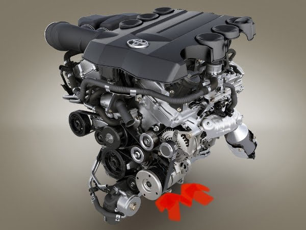

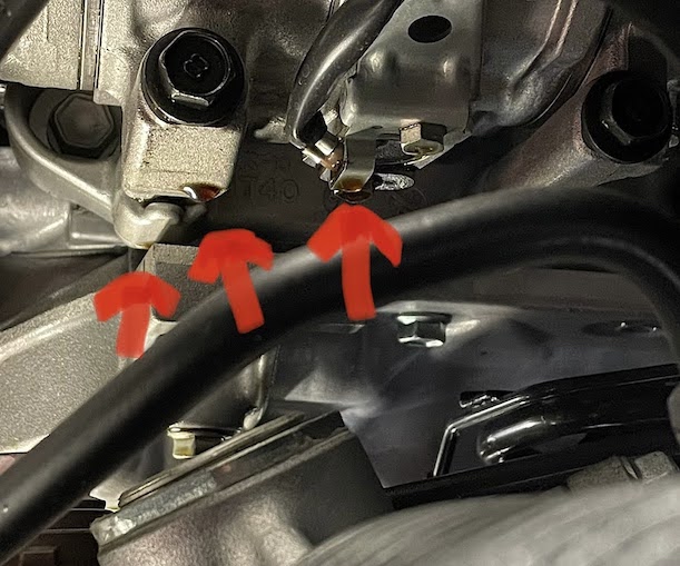

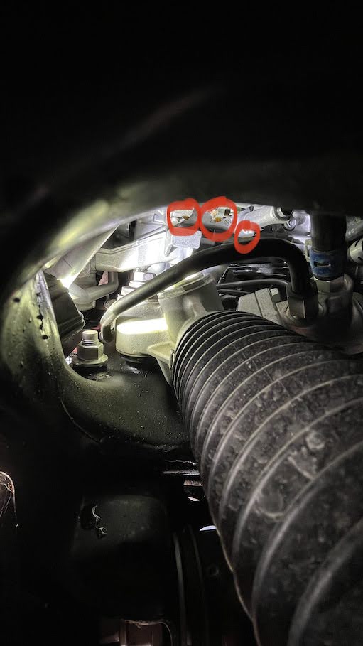

My 2021 has oil in the indicated spots in the pictures. There is only 3000miles on it. From the experiences you guys have had do you think this is signs of a timing cover leak? This area seems to drip down towards the lower control arm on the drivers side at the front of the engine.
Timing cover leaking at 3000 miles, I guess it’s possible. Did you recently have the oil changed? It almost looks like they spilled some oil while filling.

Timing cover leak usually happens near the junction between the block, cylinder head, and timing cover. That seems like a pretty good drip though.

Certainly doesn't look like it to me. It generally presents on the other side of the engine, and I have never seen one make drips of oil - they just seep a tiny bit of oil that blows all over and collects dirt, otherwise you wouldn't even know.
The dealer ended up putting UV dye in the oil and after driving it for a couple days I brought it back. They found that the oil filter housing had a bolt that was almost a full turn loose. The master mechanic that was working on it said that oil would drip onto the belt and then get splashed up to the areas I was seeing.
He said he torqued it and believes that should solve the issue. He knows I have my own UV light though and I’ve been involved in the process so he was nice enough to say if I see anything else after he cleaned the affected areas, just to bring it back and they will change the gasket (which is a short job).
