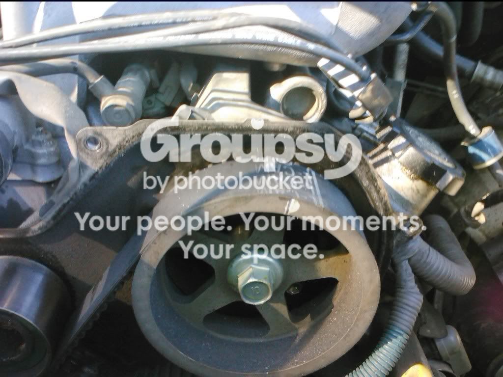

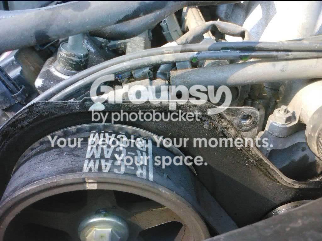

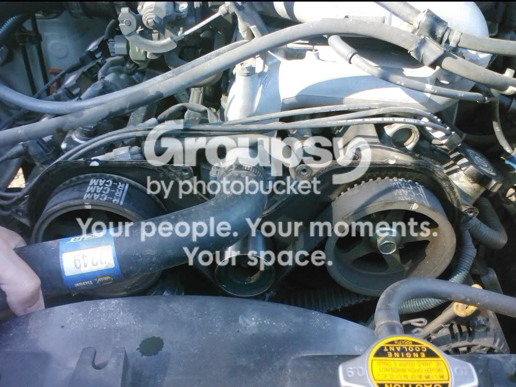

Well iv owned this truck since last November and sometime in January on a snow run I noticed the truck idled a lot more roughly then before. Now I'm young and dumb so I didnt think anything of it and just kept on going on. So now almost 9 months later I decided I should get to the bottom of the rough idle and poor MPG, I decided I would check my timing first and I am pretty sure I found the culprit
Passenger head
Driver head
I set the motor to tdc and these are the results, am I mistaken or shouldn't the timing marks line up? If they are and I have been driving like this for the past 9 months do you think I did any internal damage?
Is there any tricks to right the head without doing a timing job? Or should I just man up and do a timing job... any kits someone would reccomend ?
yeah who ever last did you timing belt messed it up, im surprised it hasnt thrown a code. but no worries the worse that has happened is you got some crapy mileage. these are a noninterference motor, meaning that you can not do internal damage to them by spinning them over out of time or without a timing belt ect. even if the motor is spinning at high rpms and the belt breaks.
the only way to fix this is to pull it all apart and reset it all but taking the belt off and reinstalling it, at which point you may as well instal a new belt, water pump and thermostat at least while youre there. id just use toyota parts personally but thats cause i get factory parts at cost. so thats basically all i ever use

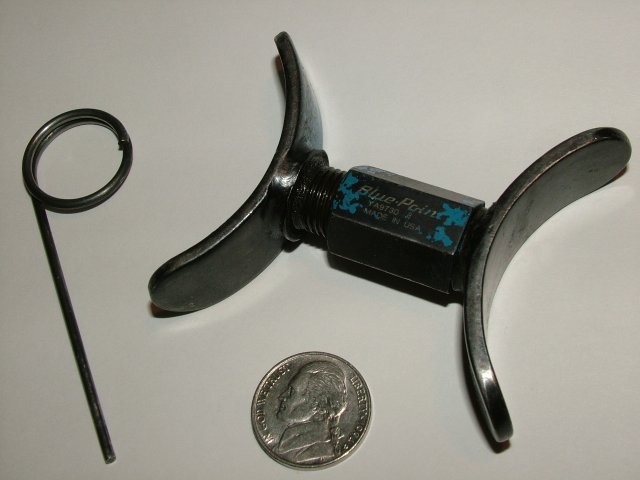

Is the special tool a cam tool so I can rotate the one back to position?
nope, that can be done with any wrench. but if you are gonna be replacing the tensioner then my tool is useless for this application. i have the tensioner reset.
