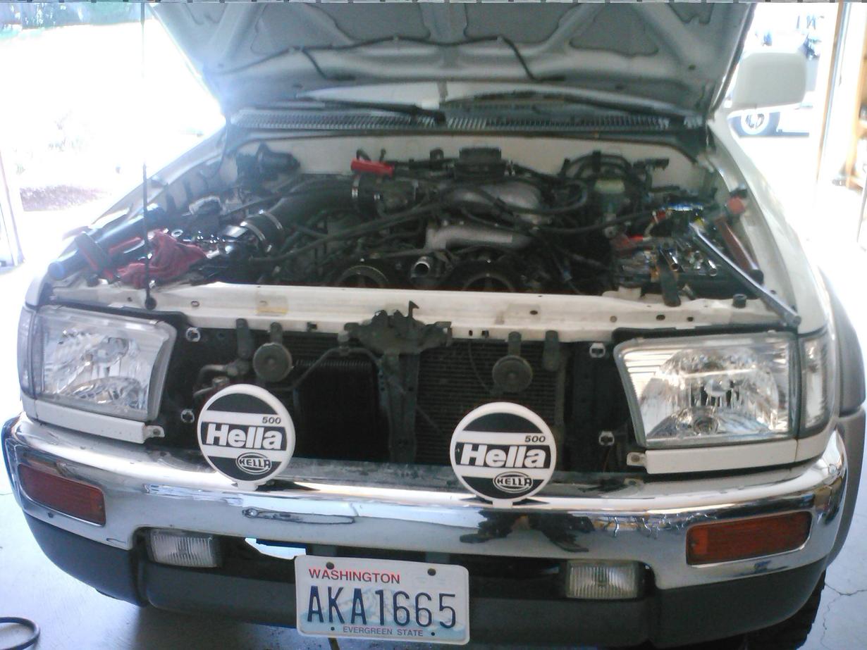

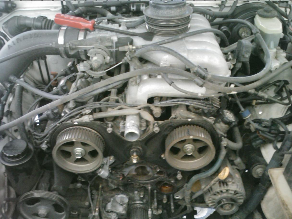

Well I got the timing done, by far the easiest job ave ever done on a vehicle.
Word of advise if you coke across this problem, I had to put on the belt 4 different times because every time I would put the belt on the crank mark after rotating it would be off 1 tooth(advanced), so to finally fix it I put the belt on with the crank off 1 tooth (retarded) rotated it back to tdc and all marks where correct.
All I have to say about my truck is wow I was missing out so much more power.
So in about 5 hours I did timing belt/tensioner/water pump/thermostat/all drive belts/oil change/and external trans cooler..
And to top off a bad week I do all that work and my starter is going out on me now solenoid I'm assuming.
