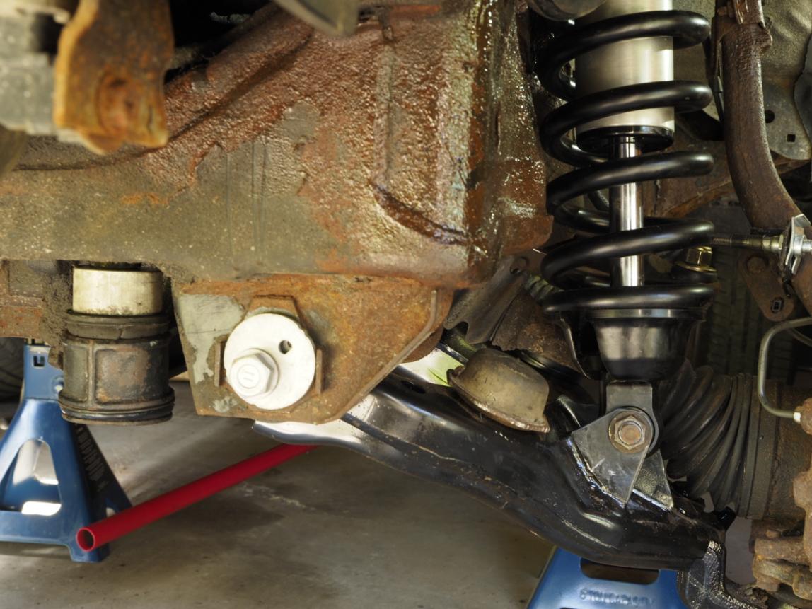

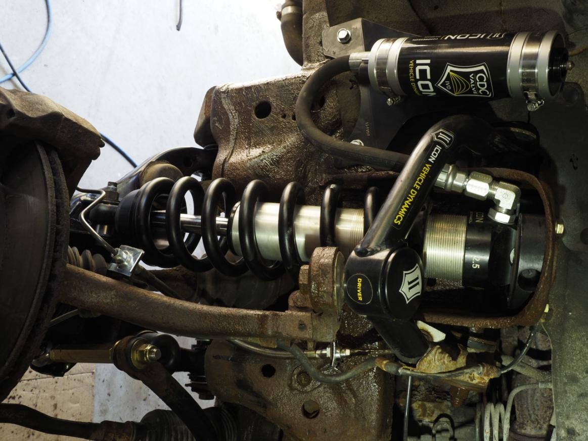

I'm also about to embark on a complete suspension rebuild. Everything in both front wheel wells is getting replaced or refreshed, new shocks and springs (giving a 2 inch lift) all around, new bushings all the way from the front to the rear, and a panhard bar correction kit. I'm pretty sure you have all of that covered in various videos, but maybe there's something in there that could be helpful.
That's a long way to drive for a video. If I had a reason to already be in your neck of the woods, I'd stop in and shoot a video with you. The dome light switch video would be cool to make, but would you really drive to San Jose for just that? We've already covered all the suspension work and bushing replacements with our videos so we don't have a need to film those jobs anymore.
