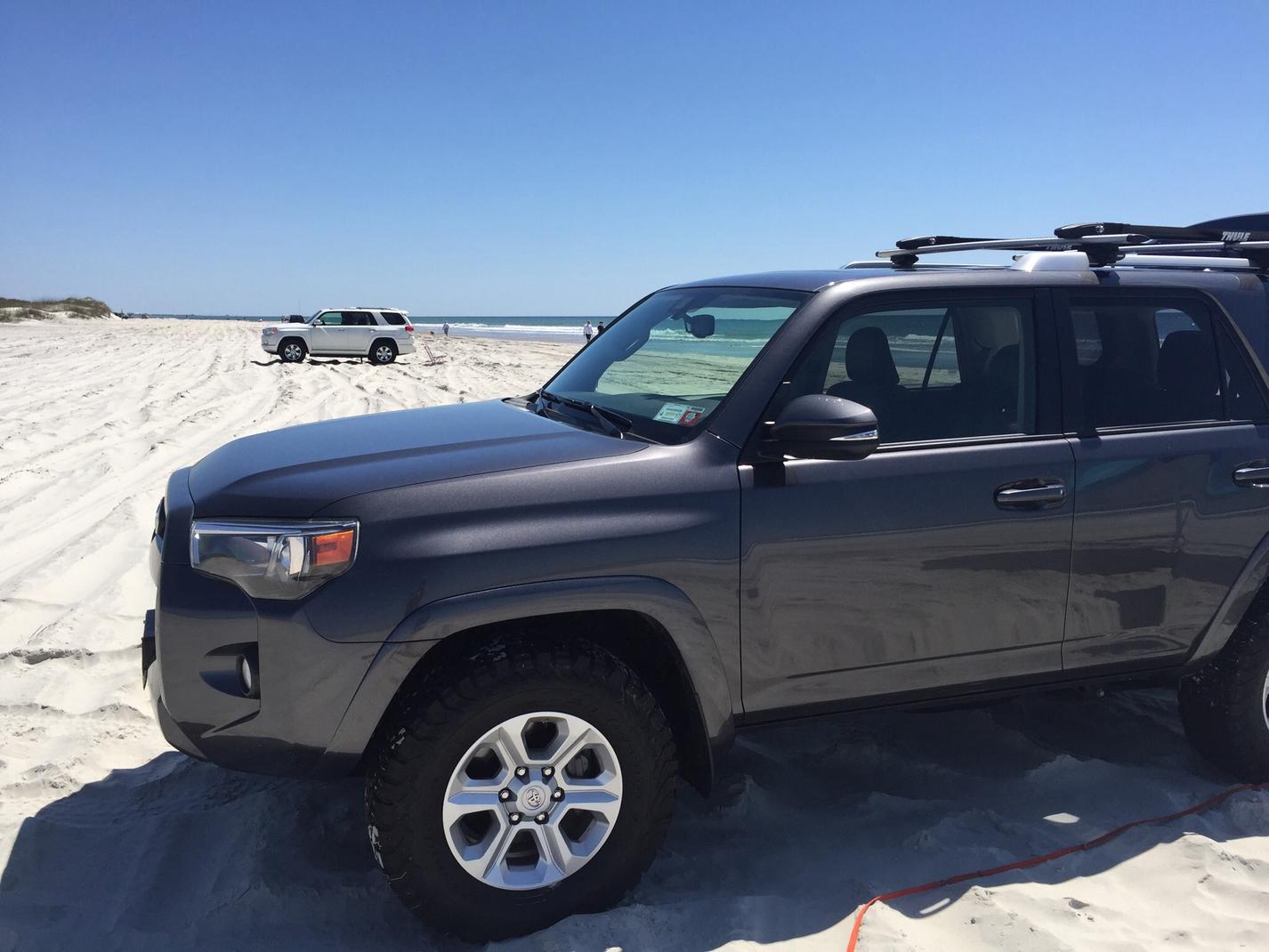

4hi with my tires aired down to 20psi worked perfect on the beach in NC. In my experience most people get stuck because they did not air down.
