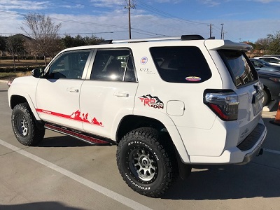

C range should be fine! No need for E load especially in an SR5 where your 4x4 roads will be much more tame. Weight matters, I just put C load KO2s (285s) on mine (51 lbs) and so far so good. A Jeep rental place in Ouray Colorado rents brand new next gen Rubicon's and they all run C load and no problems for a rental that is off-road 99% of the time.
I ran 265's on mine with a lift for a year and a half. Only thing I didn't like is the factory off-set and backspace on the wheels and the lack of aggressive look of the Duelers. I still think you would like 275's better though. I'll update my sig with the new tires soo, but you can see what a lift and 265's look like in my current sig.
Edit, new C-Load KO2 285s. SCS Ray 10 Matte Gray wheels with -10 offset and 4.30 backspace. Perfect.
