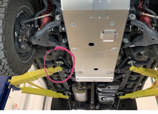

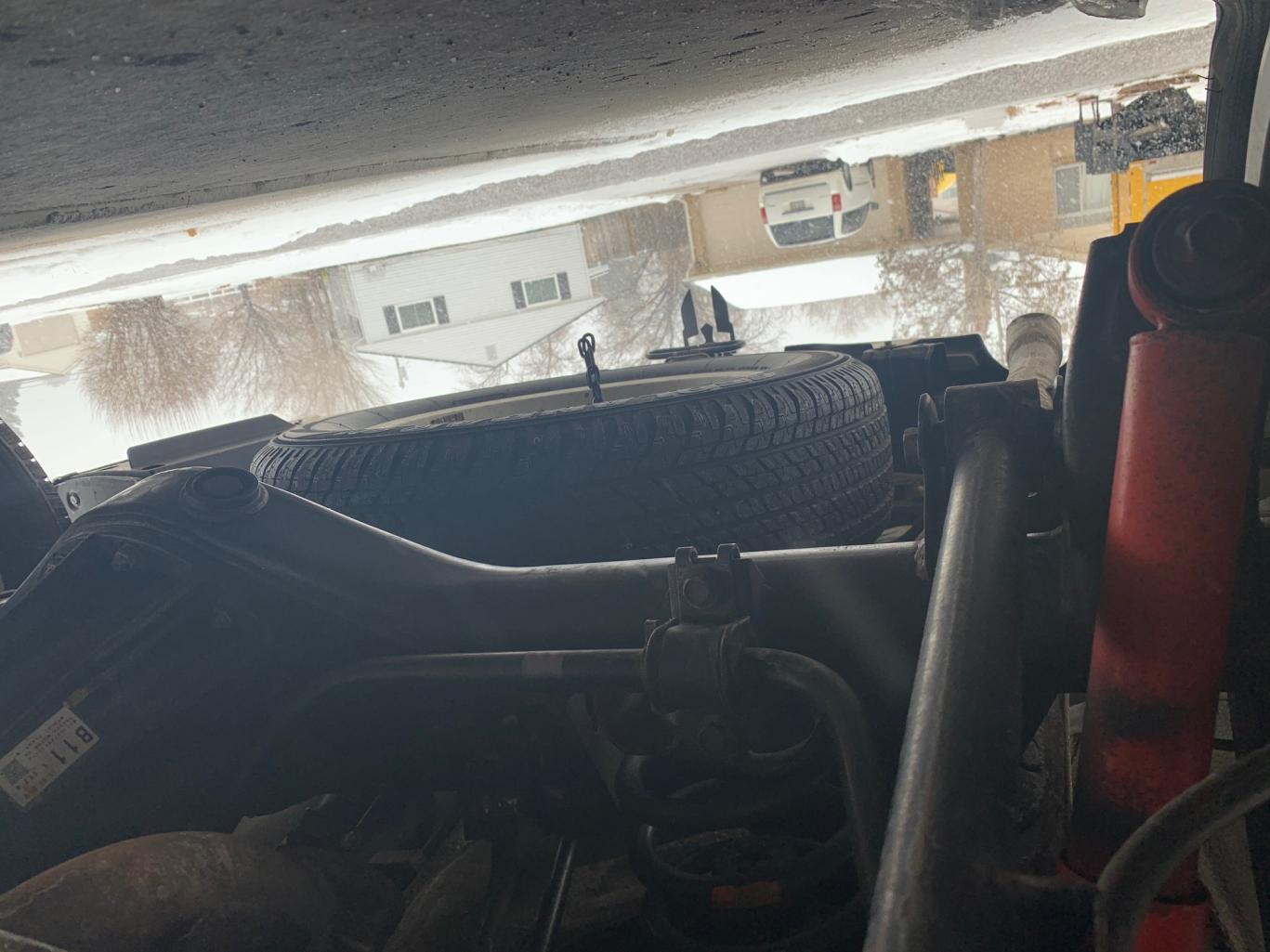

Hi guys, hope you can help me.
I have a 2010 4Runner Limited.
This is going to be embarrassing, but i cant get my car jacked up to change a flat.
Luckily, it happened right outside my house so my car is safely on the driveway.
I got my manual out, and it shows me 4 round spots on the front and rear axle to place my jack. But looking under the car, i dont see those spots. I called my shop that does my normal repairs, and they said that my spot is actually on my frame under the passenger side back door. Now im conflicted. Do i listen to the mechanic, or the manual?
If anyone can point me to the proper spot, I will be forever grateful!

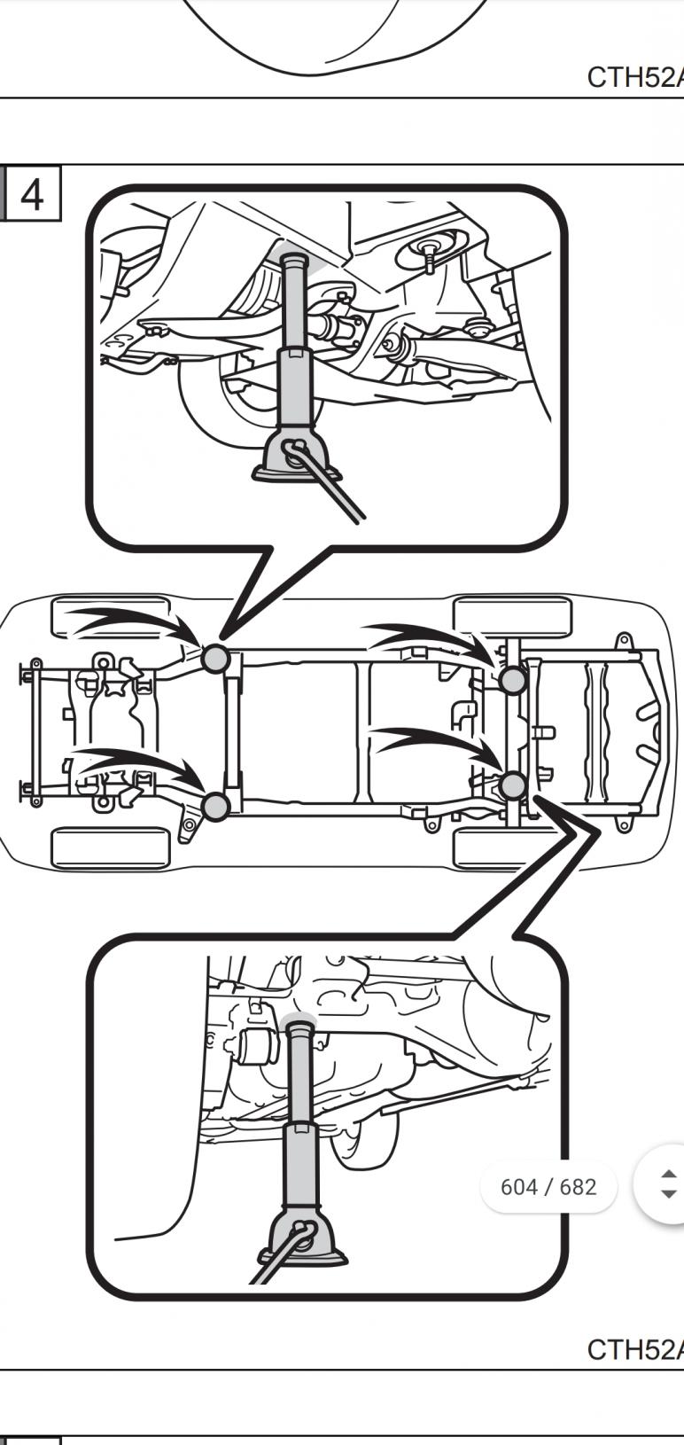

Wait... They are saying to jack the vehicle by the axle now?
:eek:
Let me clarify before others inject.
Sure I know about suspension droop and not being able to get the vehicle high enough with certain setups...
Hence the block of plastic "wood" (larger than the base of the jack) of varying thickness and such...
But I learned never to use the suspension as a jack point.
Page 605 shows the groove in the jack head going on the round axle housing?
https://cdn.dealereprocess.net/cdn/servicemanuals/toyota/2010-4runner.pdf
The axle is round.
Is is perspective.
One round is the jack head I assume. That is horizontal.
The round of the axle is on the vertical.
Put on quarter on the table flat. That is the jack.
Stand one quarter on the flat quarter (perpendicular/90 degree angle) and that is the axle.

Here's a pic from your pdf, showing frame for front, axle for rear.
