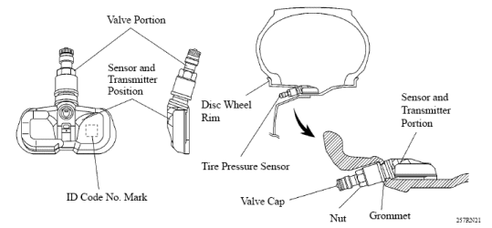

Looking at the picture in the Service Manual, it appears that the sensors are powered by a regular coin-size lithium battery. However, by the way they describe it, you would destroy the sensor in the process of getting to the battery. So they do expect you to replace the whole thing when the battery dies.
That's probably not a bad idea, since the sensor is also the valve stem, and you should replace valve stems when you replace tires.
Don't know if Honda uses the same design, much less the same frequency. Toyota is on 314.98 MHz, according to the "New for 2004" guide that talks about the system on the 4Runner.
