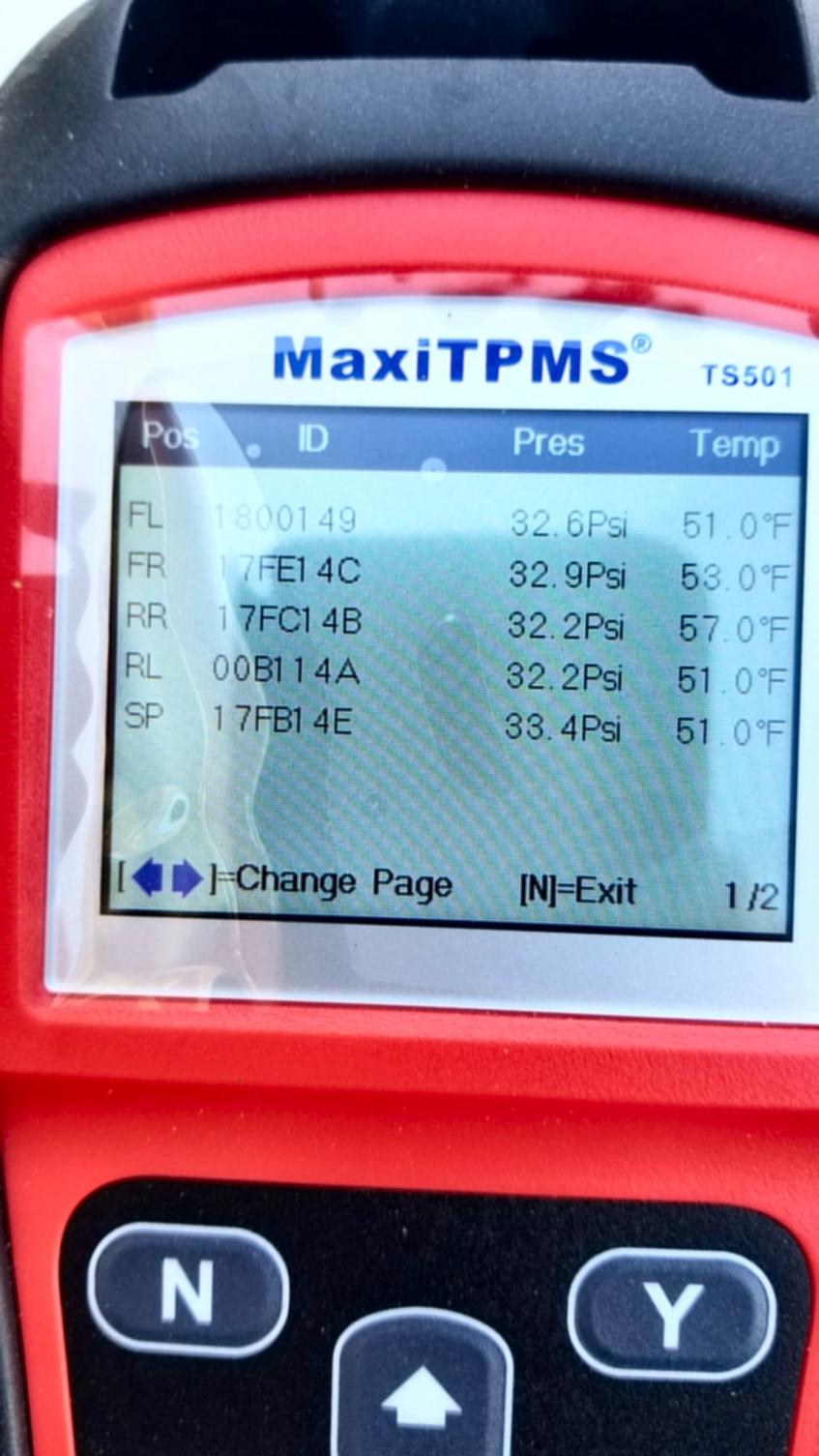

Any Toyota service center can read the sensors. There are model numbers printed on the sensors but it's also coded into them, which the scanner can read. There are other handhelds capable of reading them. I bought an Autel Maxi TPMS TS501 in 2022 for $200 and it is capable of reading them and probably the ones in your Honda as well.

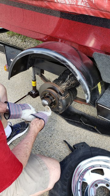

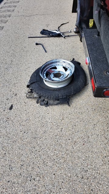

I had a trailer tire disintegrate on my 17' Ranger bass boat at 75 mph on an Interstate and the trailer was bouncing all over the place. I had no trouble pulling my 4Runner into the emergency lane.

It was no picnic changing it. The steel belt had wrapped itself into the caliper. Trailer was bouncing all over the place.

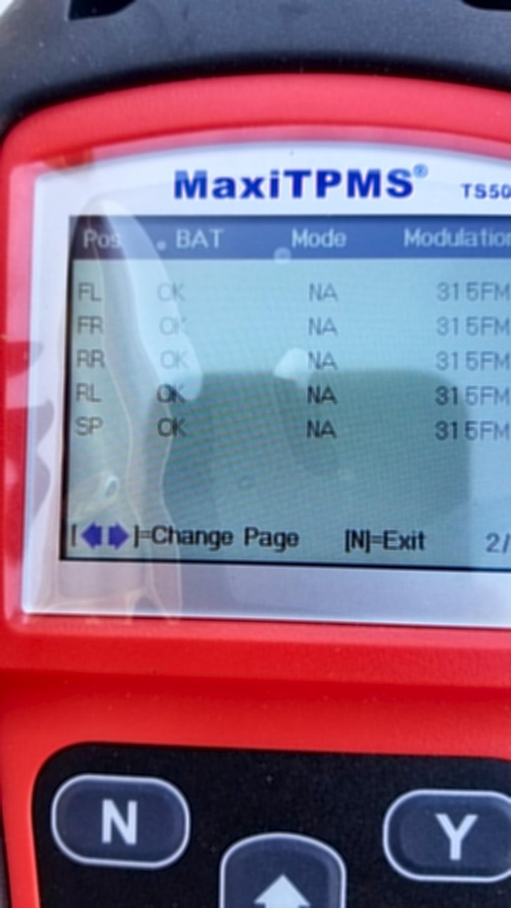

I've had good luck with support on the Autel. They have an email address but they just reply with "call us". The US team couldn't help but they opened a ticket with the support team in China and I got a reply that evening. Now I can check the tire pressure, temp, battery status etc. just by walking around the vehicle. I've been very pleased with it.

The Autel scanner I have reads / writes the sensor info from/to the ECU. The program has you start at the F/L tire, take a reading then move to the F/R as you go around the car, then finally the spare. When this is complete you have a status of each sensor, so you will see any that are bad. If they are new sensors you connect the included cable to the scanner and OBD port, then start the process to write these new sensor IDs to the ECU.
